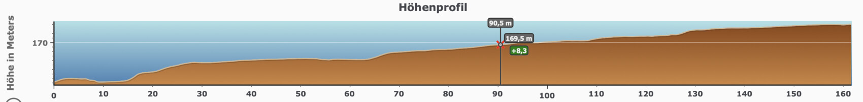

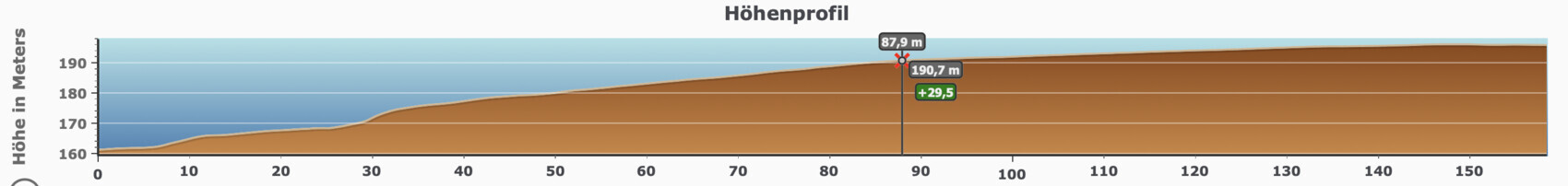

hampshire10 Mar 2021 12:53Lenalele schrieb:
We estimate a slight slope with a maximum of 3 meters (10 feet).Is the 3m (10 ft) height difference over what distance? Evenly distributed? How does it relate to the plot and the access road? You can get an idea using one of the geoportals and measure distances on your property.
For example, this is how it looks approximately on the left side from south (bottom) to north of our plot:
roughly along the centerline from south (bottom) to north
and similarly on the right side
This helps to visualize it.
You can measure in any direction, just draw lines.
