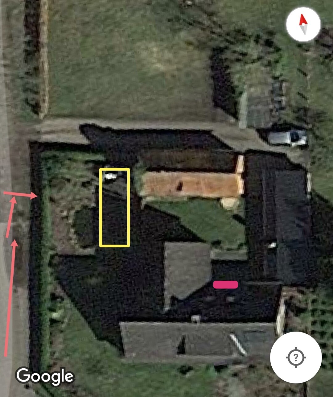

M4rvin schrieb:
Where is your main entrance?Sorry. You’re not mind readers.:
The red line marks the front door!
Hmm, well, I would lean towards option 1. The driveway is already there, and it seems like cars are already parking there. You can’t get in without stepping into mud or water with either option.
In principle, you are allowed to build a carport on the property boundary, but you would need to submit a preliminary application for that.
M4rvin schrieb:
Hmm, I would lean towards option 1. The driveway is already there, and cars apparently already park there. Neither option allows you to stay completely dry.
In principle, you are allowed to build a carport up to the property boundary, but you would have to submit a preliminary application. OK. Thank you very much for your opinion.
I’m just wondering if it is allowed to build along the entire property boundary. The shed already there, which practically borders the carport, is already 9 meters long (30 feet).
But first of all, thanks a lot!
Merymery schrieb:
So far, the gentleman has only given us a "casual" reply On the one hand, that’s unfortunate; on the other, it is not the planning authority’s job to design for the builder. In my opinion, for a preliminary assessment you seek a personal discussion, while for a legally binding statement you submit a formal building permit inquiry / planning permission request. Your email is an in-between approach that the authority cannot work with, as providing a written answer risks committing to undefined obligations.
Option 1 would be the most practical but also the most legally complex in terms of building regulations. As you yourself say, according to building codes, the boundary development of privileged buildings may only extend 9m (30 feet). Is the existing building considered privileged under
§5 (8) 2 Lower Saxony Building Code
1. Garages and buildings without habitable rooms or fireplaces with a height up to 3 m (10 feet) ...
If yes, it depends on what exactly the neighbor agreed to by signing 60 years ago. If not, then a new 9m (30 feet) boundary development would generally be permissible under building regulations. However, from a planning law perspective, this is questionable since development northwards would expand into open countryside, which is generally discouraged in rural areas. In any case, you should read through §35 of the Federal Building Code and think carefully about a strong justification for the necessity of the carport. Based on that, you need to provide the authority with solid reasons for this specific location. I recommend involving an experienced local planner authorized to submit building applications, as you risk rejection if your application documents or justifications are weak.
