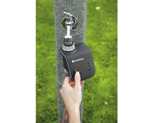

As I said, I haven’t dealt with the details yet. But I roughly imagined it like in the photo.
