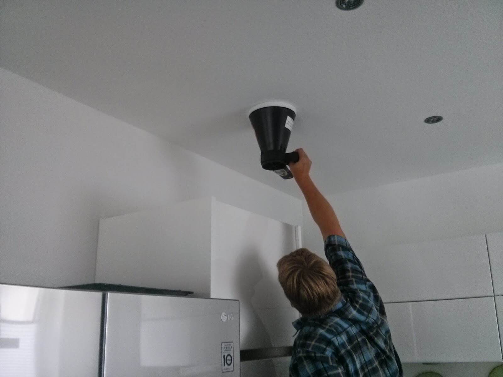

Yes, that works like this:
First, a calculation is made to determine the appropriate setting for each valve based on the required value/airflow rate.
If this was not done in your case, you should promptly send a defect claim to the system installer.
What do you consider loud? At (almost) full capacity, all systems make some noise.

Thanks for the picture. Well, I’m not sure if he set it up that way, as I wasn’t there. Based on my previous experience, probably not.
Exactly, and that’s the point: the system is running at 70%, which is why it’s noisy. It’s also a question whether it might be undersized.
