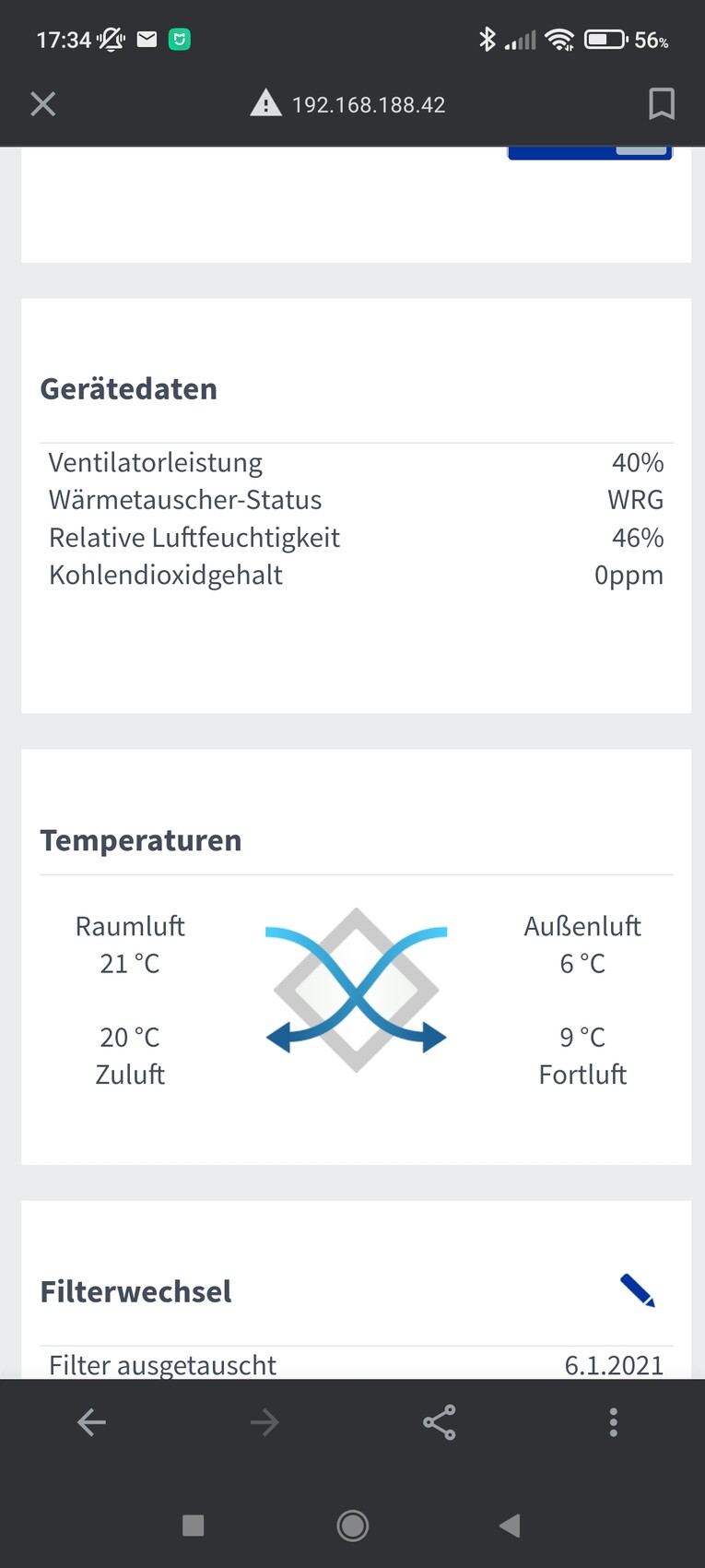

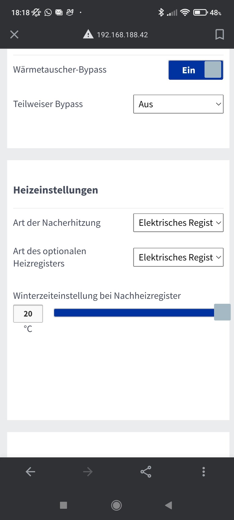

First, I increased the supply air temperature from 15 to 20 degrees Celsius (59°F). Vallox mentions 15 degrees Celsius (59°F) as the optimal value in the manual. Why is that? Does the air otherwise need to be heated electrically if this value is not reached?
The system settings also showed 15 degrees Celsius (59°F) for the supply air temperature, but according to the images, the supply air was set to 20 degrees Celsius (59°F). Something doesn’t seem right here.

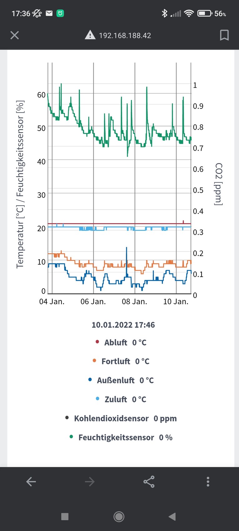

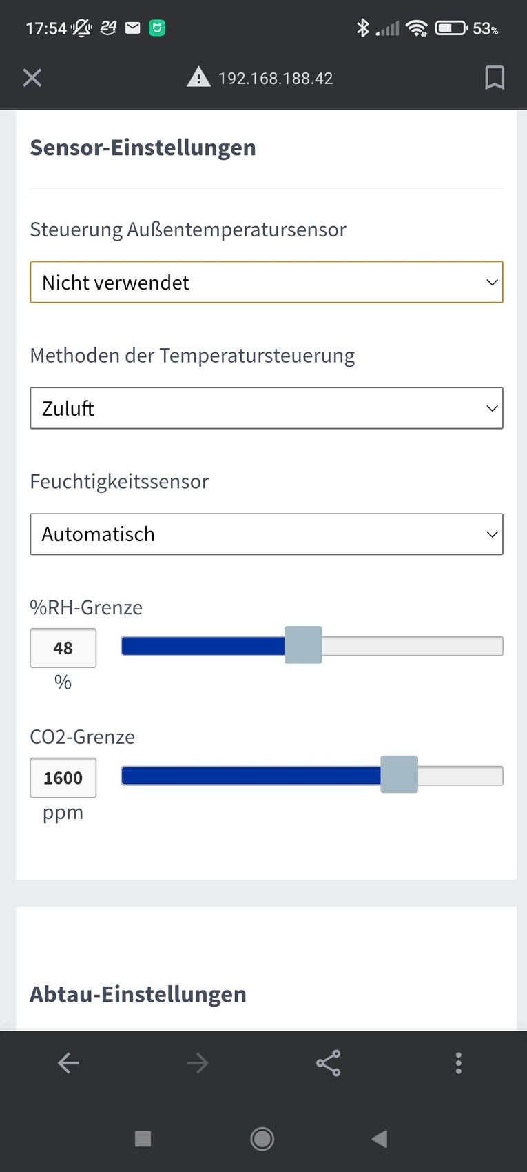

Additionally, I raised the relative humidity limit from 48% to 55%, as the air felt quite dry, according to the graph.
I lowered the CO2 limit to 900 ppm.

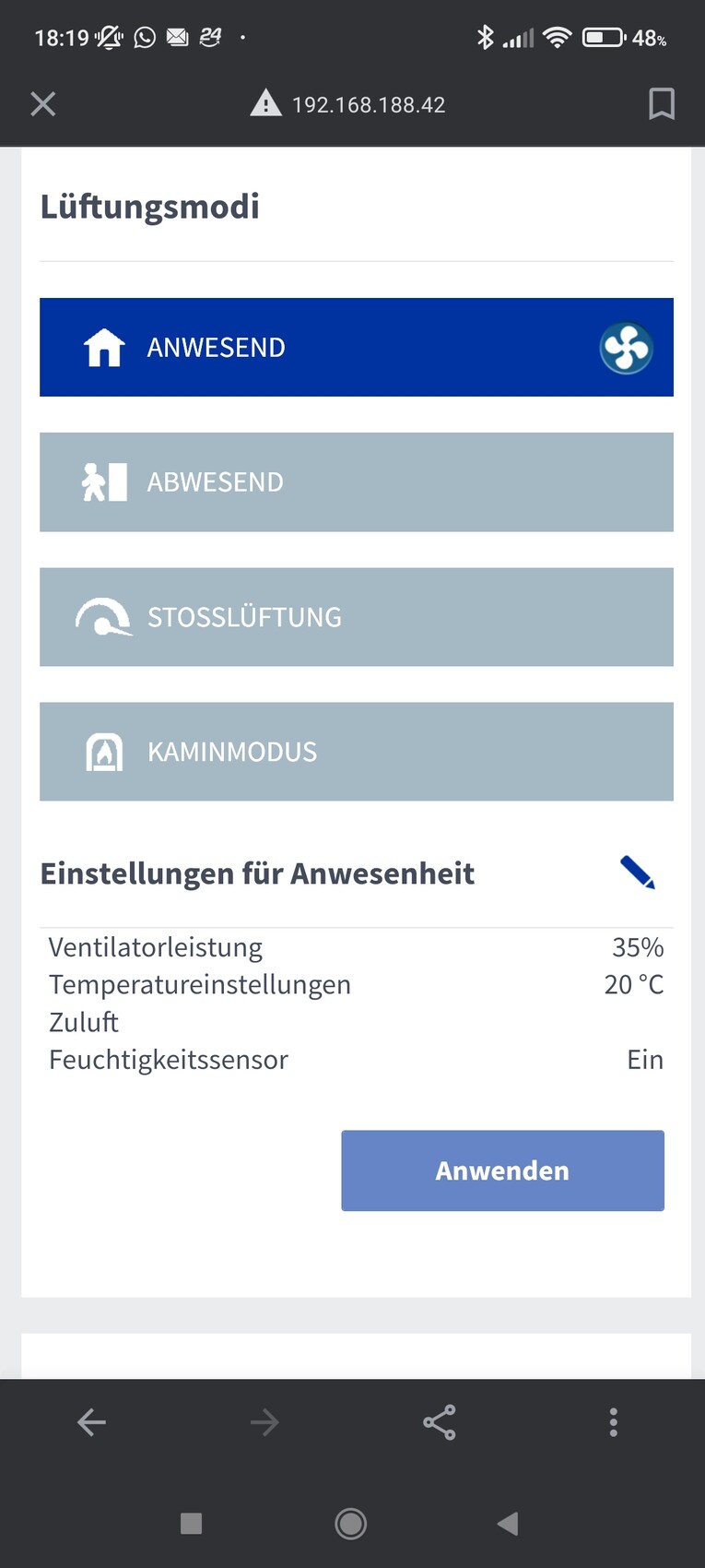

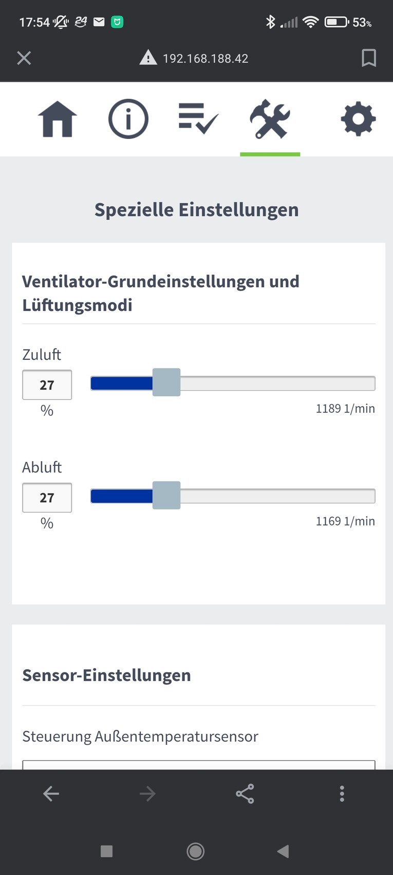

I also reduced the fan power from 40% to 35%. The system became noticeably quieter, which surprised me given the small change.

Tx-25 schrieb:
Why is that? Does the air need to be heated electrically if the value is not reached?
The system settings also showed a supply air temperature of 15°C (59°F). According to the pictures, however, the supply air was at 20°C (68°F). Something doesn’t add up there.
Here I give you @driver55’s standard advice, if he doesn’t want to give it himself 😉
Instruction manual for conditions!
Tx-25 schrieb:
Does the air need to be electrically reheated if the target value is not reached? Yes, that is correct.
Tx-25 schrieb:
Vallox stated an optimal value of 15°C (59°F) in the description. Why is that? Because then no electrical reheating is required, and the air is warmed afterwards by the existing heating system, which is more efficient and cost-effective.
Tx-25 schrieb:
According to the pictures, the supply air was at 20°C (68°F). Something doesn’t add up there. Yes, that’s because your heat recovery is working and warming the air. The 15°C (59°F) should be considered a limit value for colder outdoor temperatures than are currently the case.
