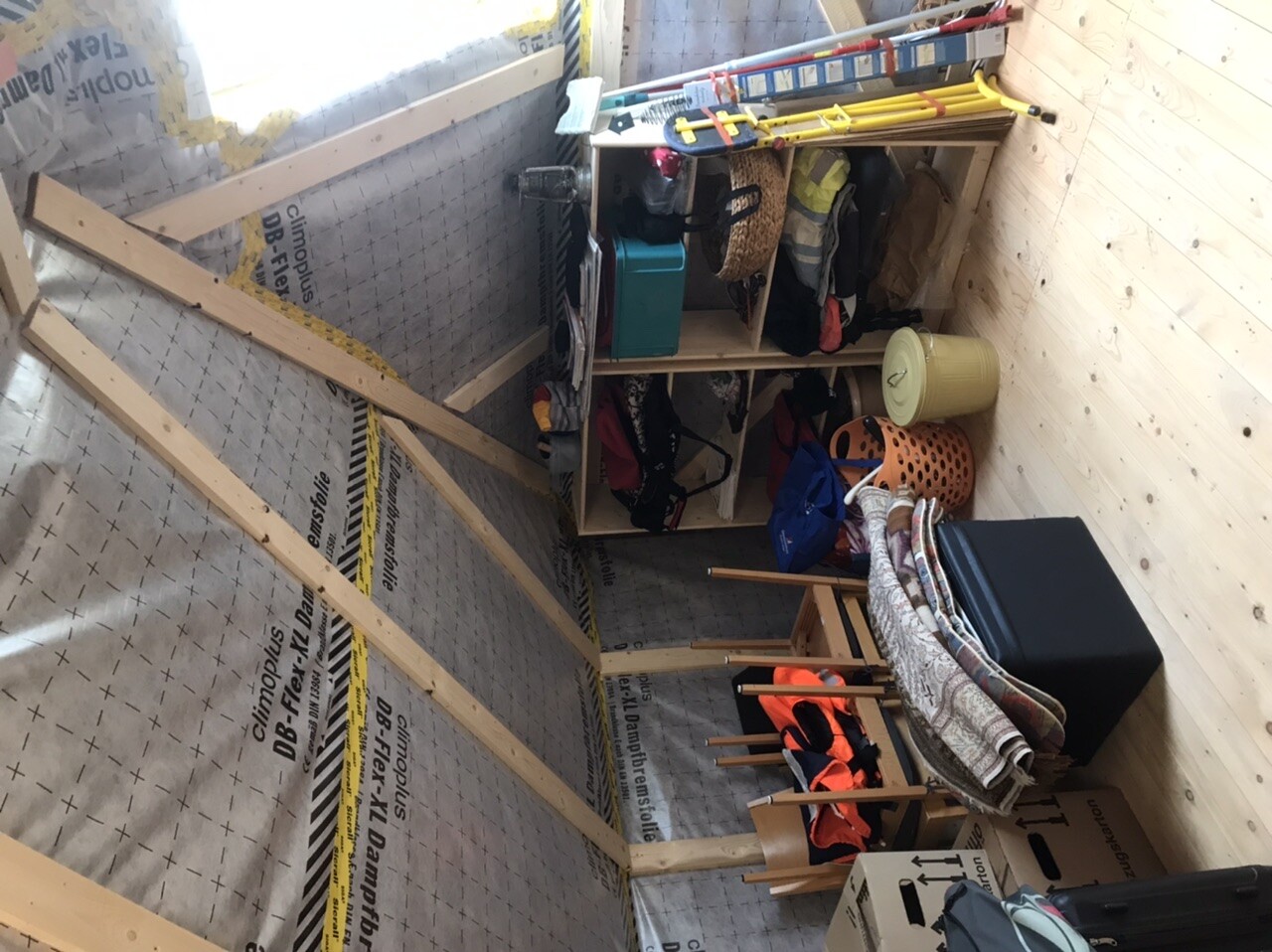

It is unheated but fully insulated all around. Everything is fine. Dry and reasonably warm in winter, dry and fairly cool in summer.
Attic storage room with wooden shelf, clothes, tools, baskets, and ladder.
