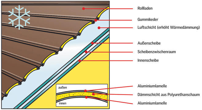

I believe that these types of roller shutters are installed above average in new builds nowadays, just as triple glazing is commonly installed and considered standard today.
However, this is only a guess, and I don’t have any price comparisons between insulated and non-insulated roller shutters. Maybe a forum member can provide more concrete information here? Almost no one installs insulated roller shutters; it’s complete nonsense. That’s it!
That is not entirely correct. Aluminum roller shutters with PUR insulation are state-of-the-art and are, of course, installed daily—though not by low-cost general contractors. However, I know of a large nationwide general contractor in Germany (mainly residential construction and terraced houses) that only installs these. (In large quantities)
Foaming the shutters not only improves the insulation values but also results in greater structural stability, which allows for larger surface areas.

ludwig88sta16 Dec 2019 17:18Bookstar schrieb:
Almost nobody installs insulated roller blinds, total nonsense. That’s it!I know someone who is currently building their own house and has installed them.

ludwig88sta16 Dec 2019 19:39ludwig88sta schrieb:
Insulation layer within the slats / the roller shutter itself, not the roller shutter box.
