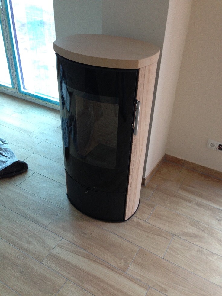

We have our stove set up the same way you plan. About 30-40cm (12-16 inches) behind the stove on the wall is an expensive speaker. I placed a thermometer on it once, and the temperature was no more than 2-3°C (4-5°F) warmer than the rest of the room.
Attached are 3 pictures showing how it looks in our home (taken right after installation). The stove is called "poleo 106 by attika."
Our wood box is located to the right of the stove.
PS: Keep in mind fire-resistant flooring if you don’t have tiles (like we do).
