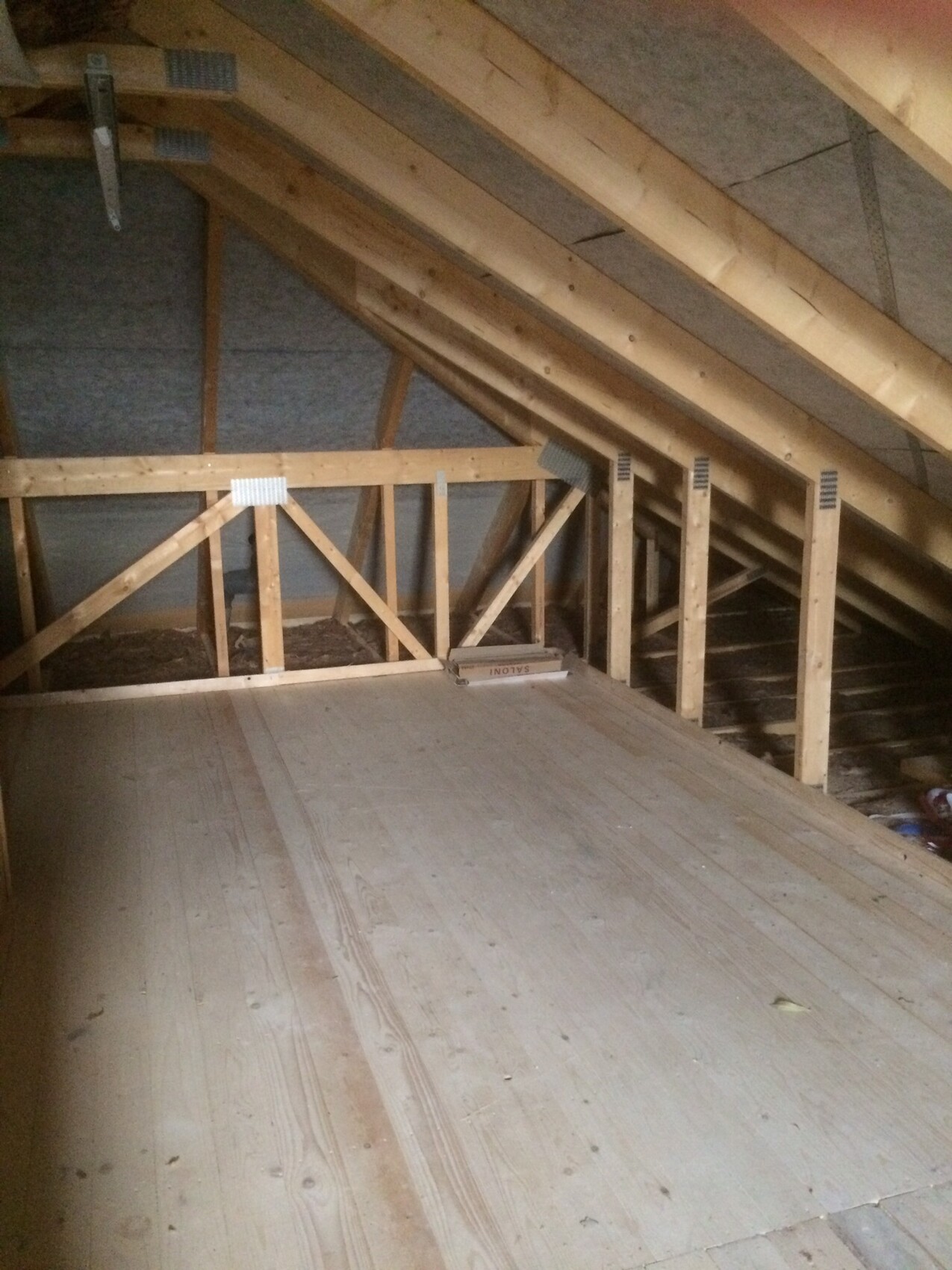

I have a question about who is responsible for the costs. I started building my house in September 2016 and successfully completed it in October 2017. The house is single-story. My problem is that I have very large cracks between the walls and ceiling on the upper floor. They are almost 2 cm (0.8 inches) wide. The upper floor does not have a concrete ceiling; it only has drywall. Last summer, I installed OSB boards on the attic floor and screwed them onto the roof beams. According to the construction company, I should only leave space for ventilation at the sides and the gable. I followed these instructions. However, the site manager now tells me that the cracks were caused because the OSB boards expanded and, since they are screwed in, pushed the entire roof structure upward. Fixing this would cost me about 1000 euros.
About a week ago, I removed all the screws from the boards on the attic floor. The site manager said the roof structure would lower again, but so far nothing has happened. The cracks are at the top of every room. I screwed the OSB boards onto the attic floor in July of last year, and the cracks appeared in November.
Is it really possible that the OSB boards could push the entire roof structure upward by almost 2 cm (0.8 inches)? I would be very grateful for any advice, as I don’t really understand this issue.

Yvonne, you are right.
But look at the pictures. This is too extreme. Something is not right. The story about the OSB boards also seems strange to me, but these boards must have something to do with it, don’t they?

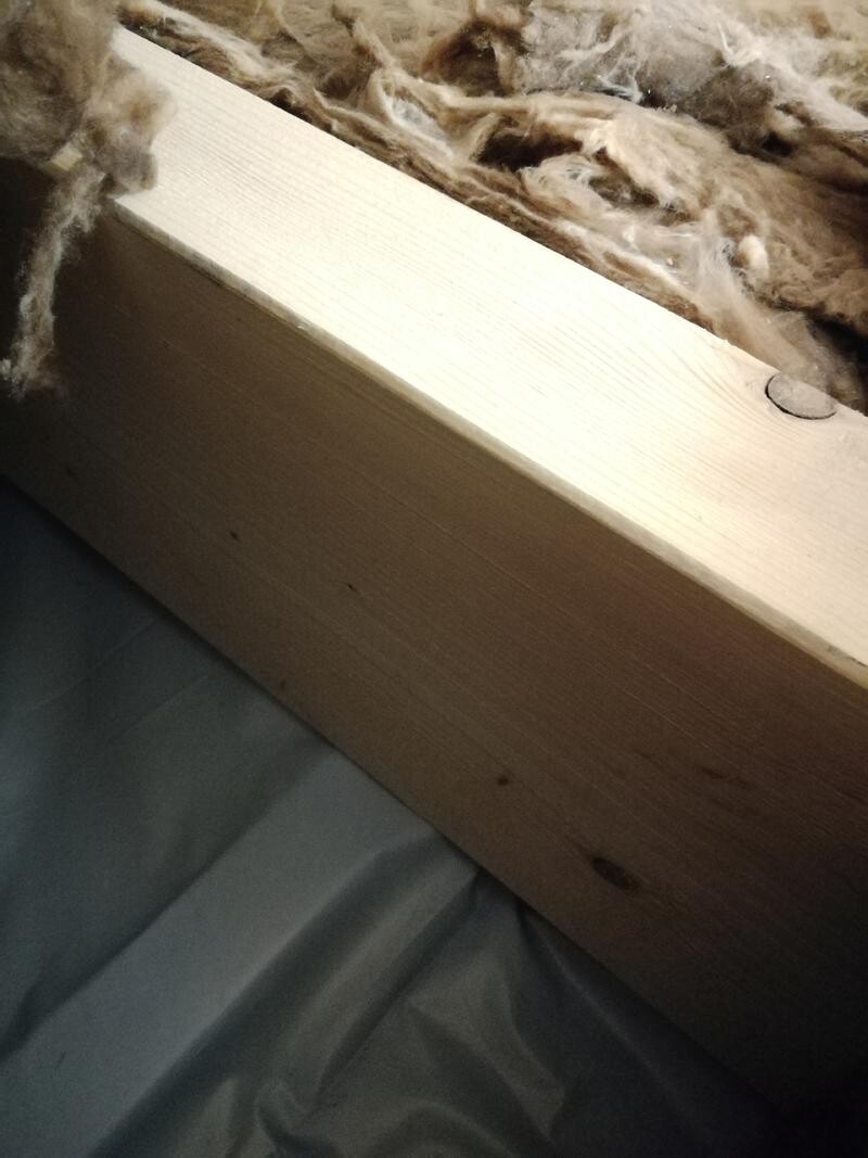

Is the roof structure made of KVH (timber beams)? Is there wooden battens under the drywall?The roof structure was built in December 2016 during dry, cold weather. Heating was not yet in use at that time. The drywall ceiling was installed in June, and painting was done in July. Yes, the roof structure is made of KVH (timber beams). I will upload a photo of the attic shortly... The drywall panels are screwed onto the wooden battens.
