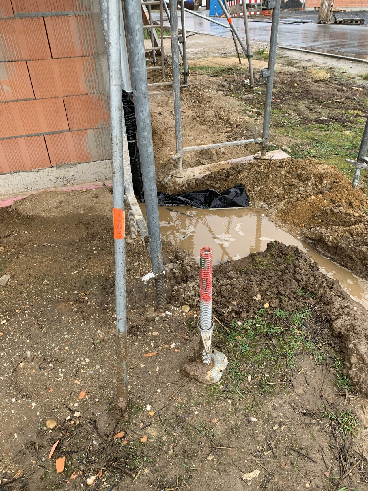

Andre77
23 Feb 2020 16:36
Man in red T-shirt working on the edge of a house roof, standing on a ladder.
Instead of the membrane, I wanted to install a yellow flexible hose right where the membrane is so that I can lead it away to a distance. Currently, my downspout is there with a membrane attached at the bottom, but there is no slope to allow proper drainage... right now, there is always a puddle there.
The downspout ends about halfway across the foundation slab or even lower.
On the house side shown in the picture, it's still okay... everything is dry... but on the other side of the house, it is more problematic...
Construction site with foundation work: mud, puddle, supports and scaffolding around a wall.
Construction site with steel scaffolding, wet ground, puddle, red support post next to trench, brick wall on the left
