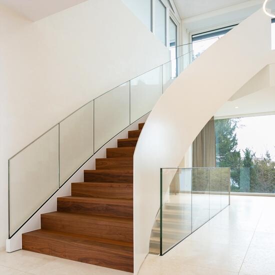

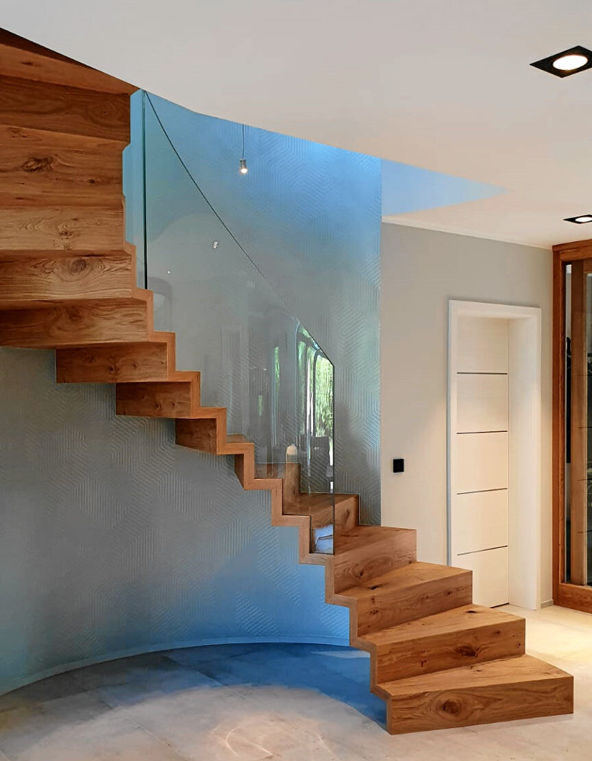

What don’t we like? Why? I could imagine a nicer staircase, perhaps a longer, more open design. Overall, the hallway feels a bit large.

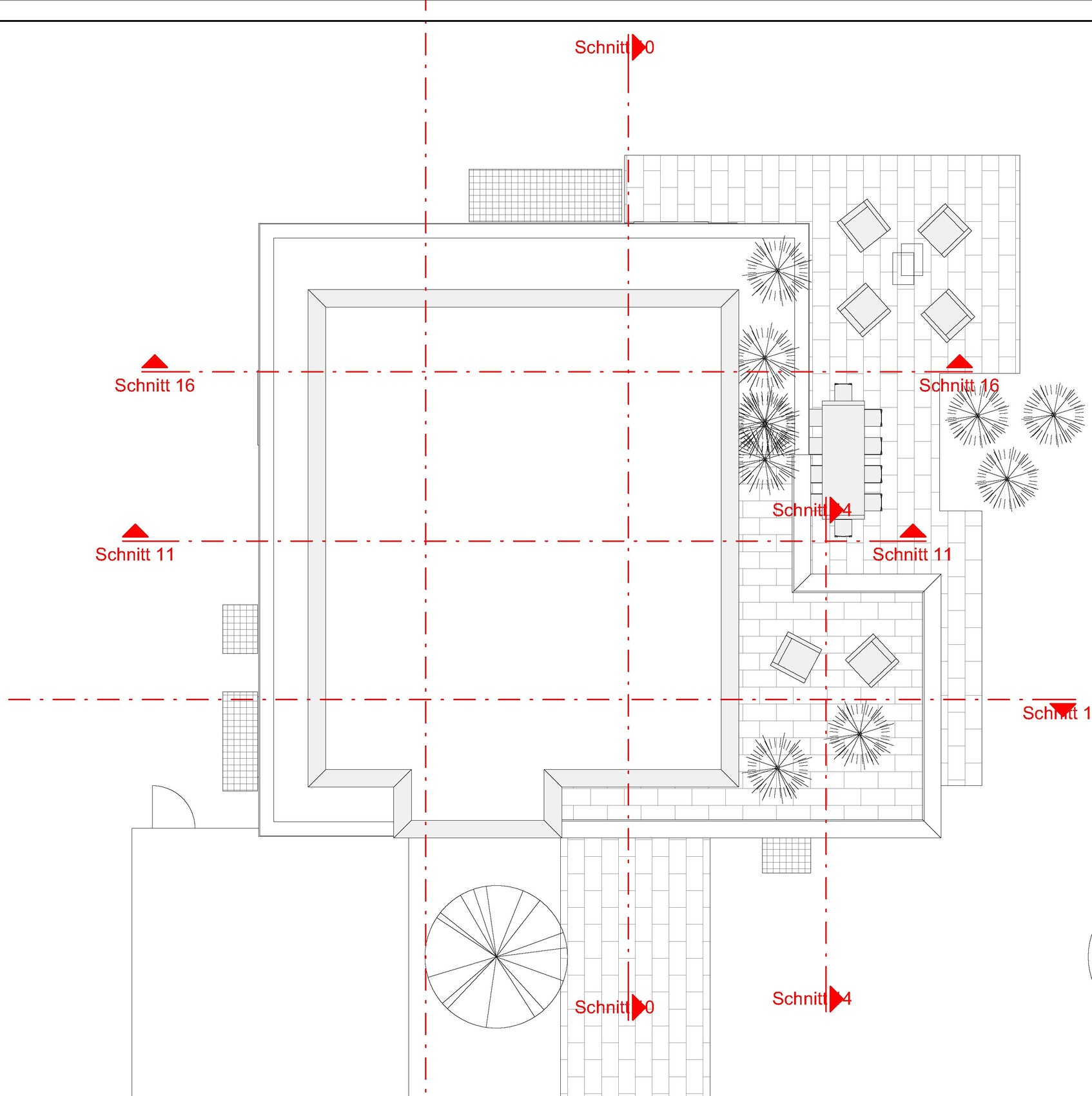

The upper-floor terrace seems somewhat oversized. We are wondering if the overhang casts too much shade on the ground floor.

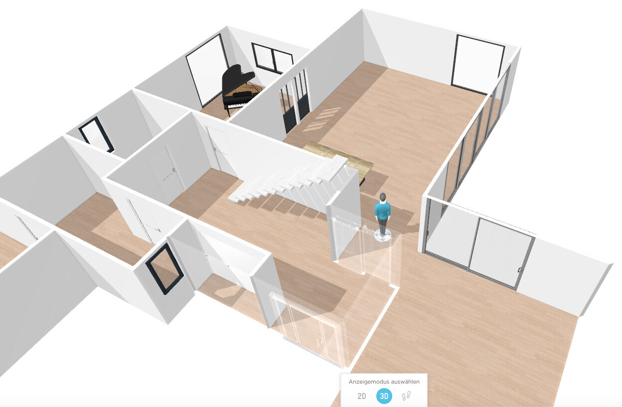

At the moment, I find it hard to visualize the staircase. On the other hand, I think the layout in the entrance area is better this way. The guest room also gains a lot of space.
The canopy is still under discussion, especially regarding how large the overhang will be. Apparently, it can be simulated, etc. I simply tend to prefer less.
To be honest, the image is from an earlier version. Back then, the roof was lower.
Nice-Nofret12 Oct 2020 10:39We have a patio roof of 3m (10 feet) in front of the living room; it does not obstruct the view, not even the sky. It is still bright enough, and since September, the sun shines into the living room again; in December, it reaches deep into the room. Our rooms have a ceiling height of 270cm (9 feet).
I can only recommend a generous patio covering. It is worthwhile because it provides coolness in summer and all-year-round weather protection for the outdoor furniture.
I like the new plan; perhaps the stairwell could be designed large enough to install an elevator. I still think that is better than having a stairlift in old age.
Pinky0301 schrieb:
I find spiral staircases unsuitable for a house of this size; they are more commonly found in terraced houses / row houses.Really? Okay, exceptions prove the rule...

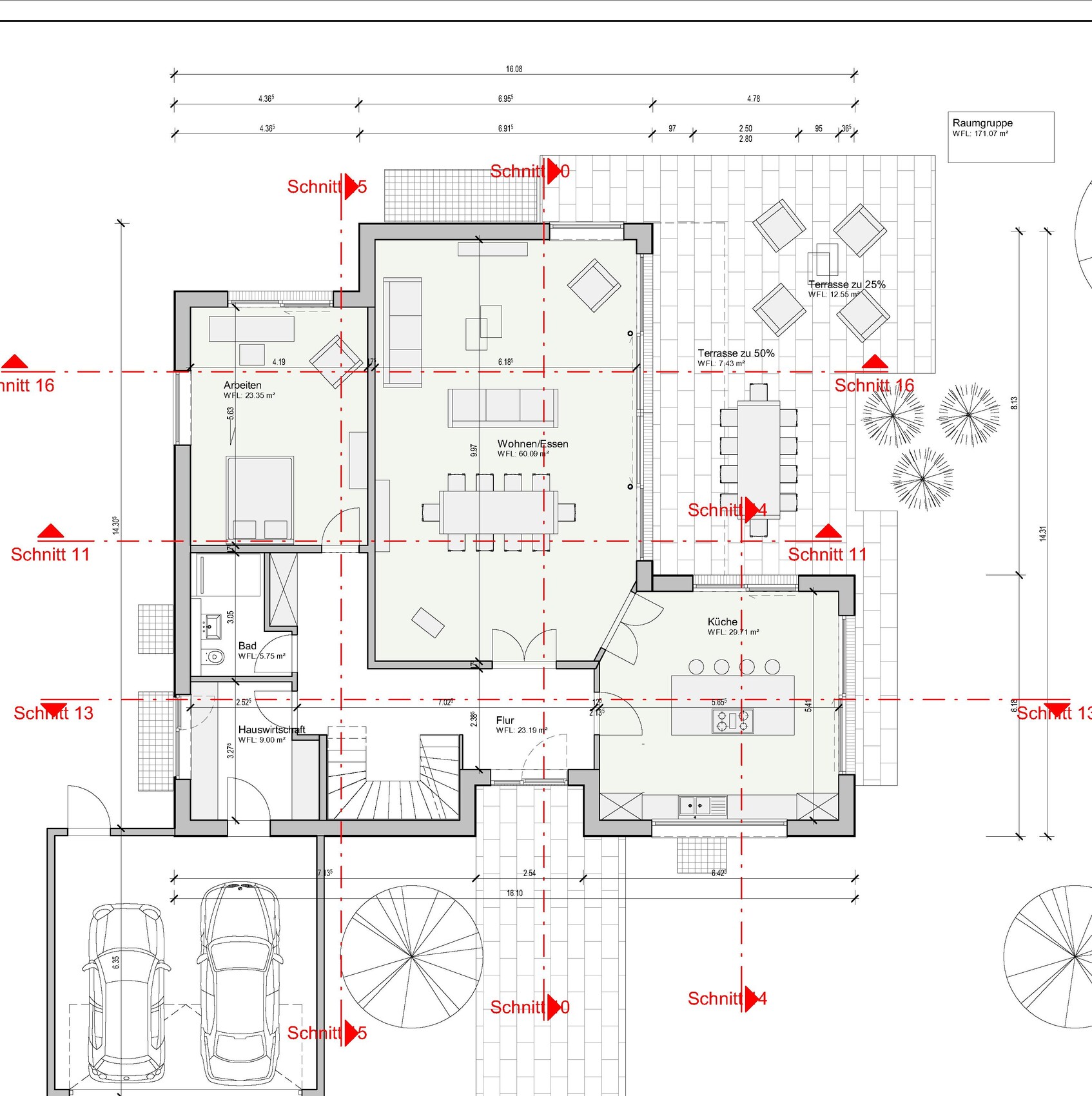

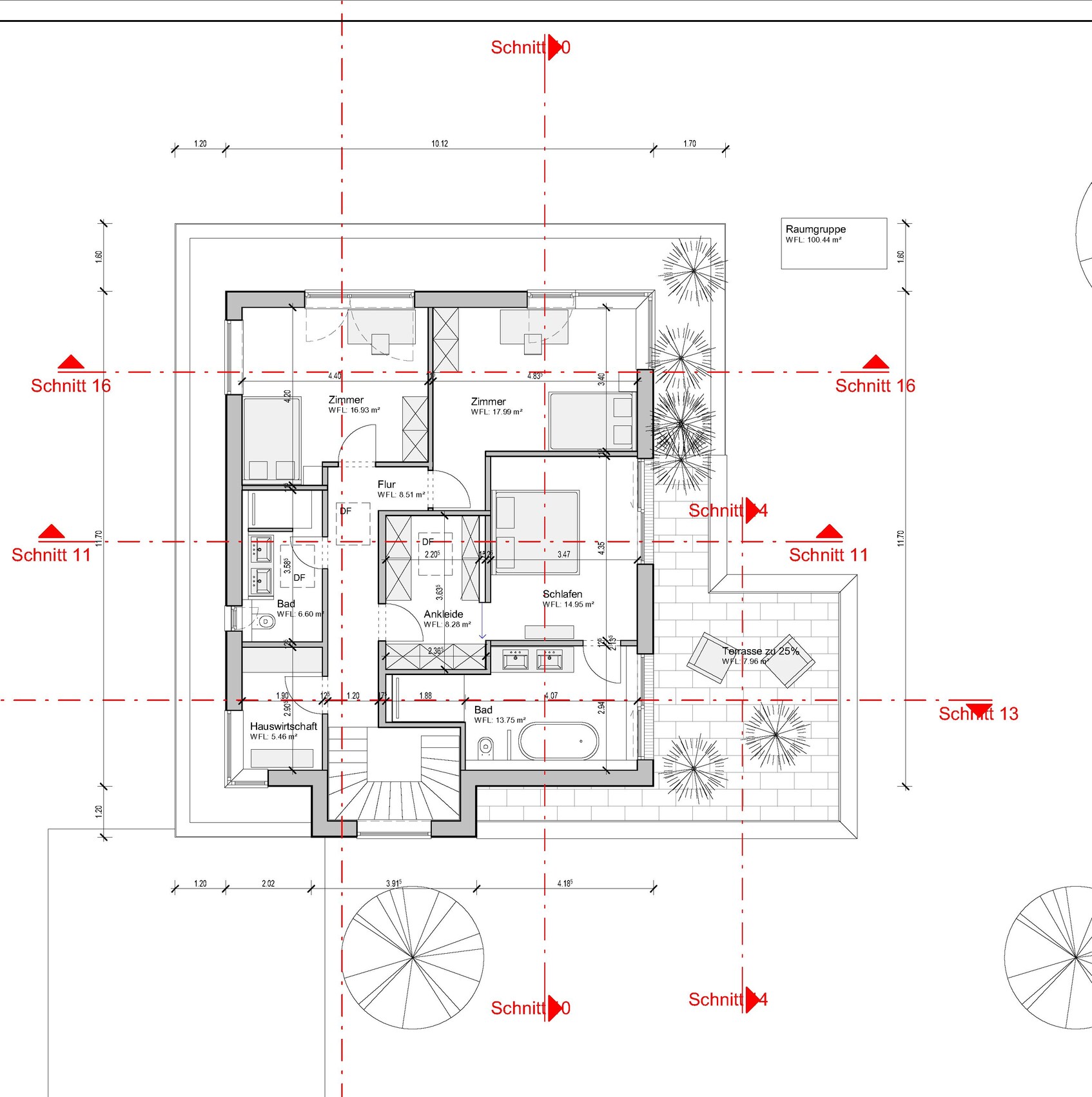

I would like to revive this topic and share the initial floor plans. Unfortunately, it turned out that the old building regulations from 2016 still apply to our plot. This means only 66% floor area is allowed upstairs and a 1 m (3.3 ft) setback from the ground floor. Because of this, the wrap-around terrace is now gone, but the design upstairs is more compact and manageable. The hallway is a bit narrow, but this way all areas are well-sized.
It is a bit unfortunate that you cannot access the master bathroom without going through the bedroom. The utility room upstairs could possibly be a little larger.

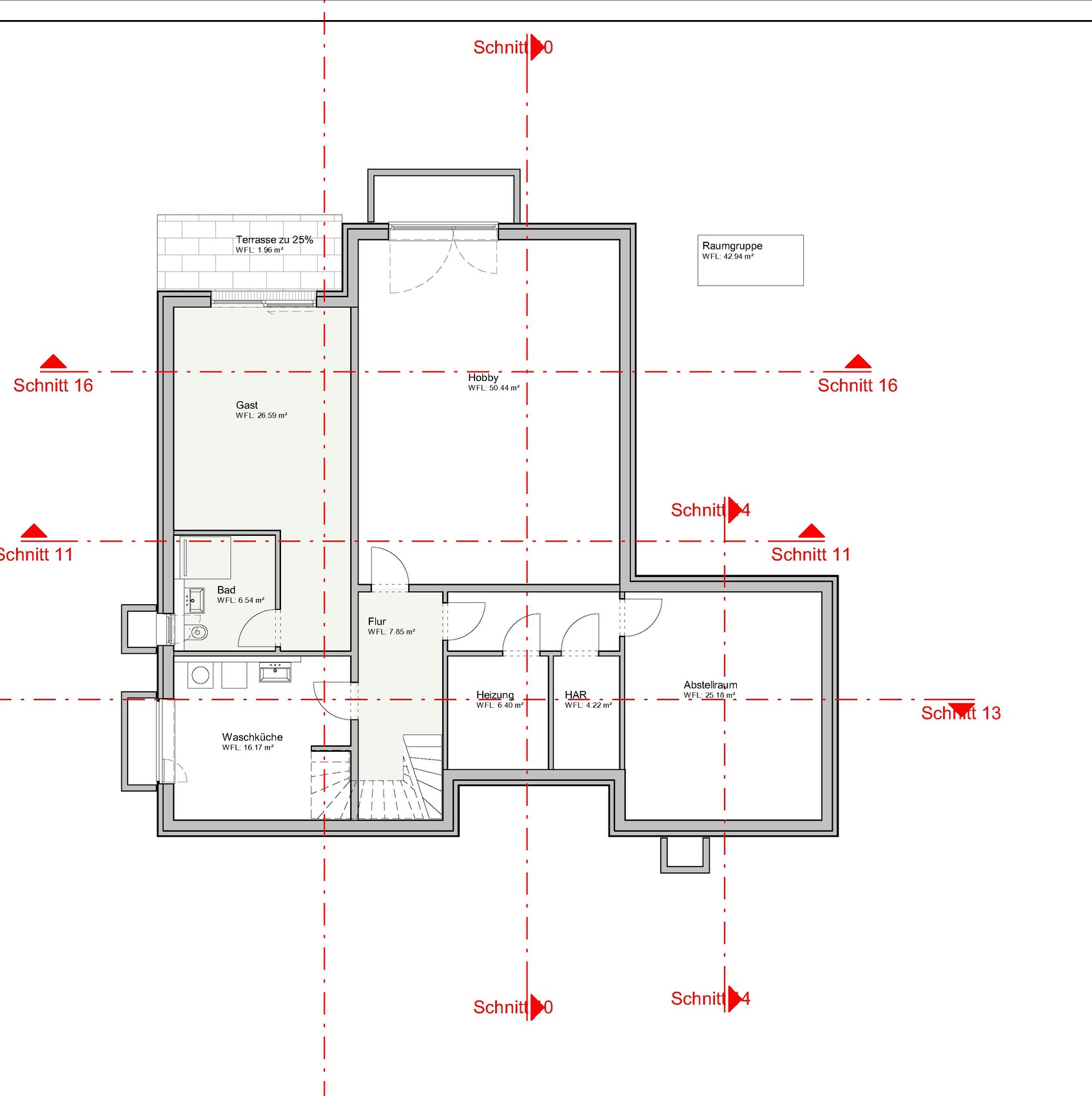

The utility room on the ground floor mainly serves as a buffer zone and storage room rather than a full utility room. I like the idea of having the kitchen open to the living/dining area with a hinged/sliding door set at an angle. The home office also has a better layout now.
We are planning the basement for now and I think we will include it if the budget allows. It’s not something we can add later.
