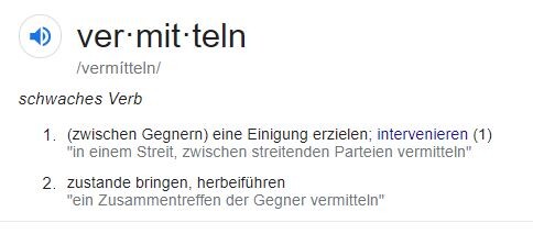

derschwax6 Oct 2020 12:21ypg schrieb:
The idea conveyed is: if one part becomes larger, the other has to adjust or be designed differently… a planner knows what conveying means.And every craftsman as well.
Everyone here knows: it is your favorite word Is that so?
derschwax schrieb:
And every tradesperson. He is also an expert in plans.
By the way:
Nice word – despite its weakness … in this case, it means to convey spaces.
