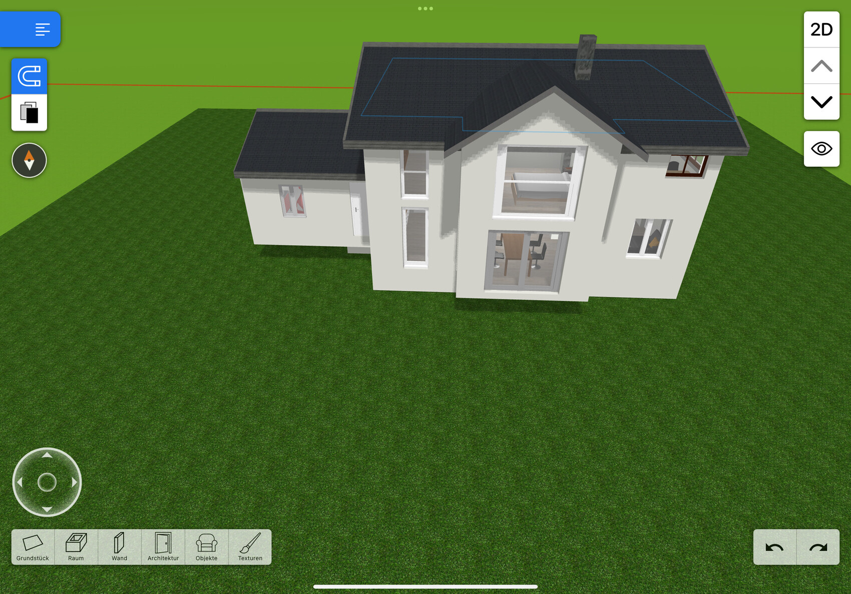

I would appreciate honest and constructive feedback on our self-drawn floor plan. Many, many hours and thoughts have gone into it already. As a perfectionist, I don’t want to leave anything unchecked.

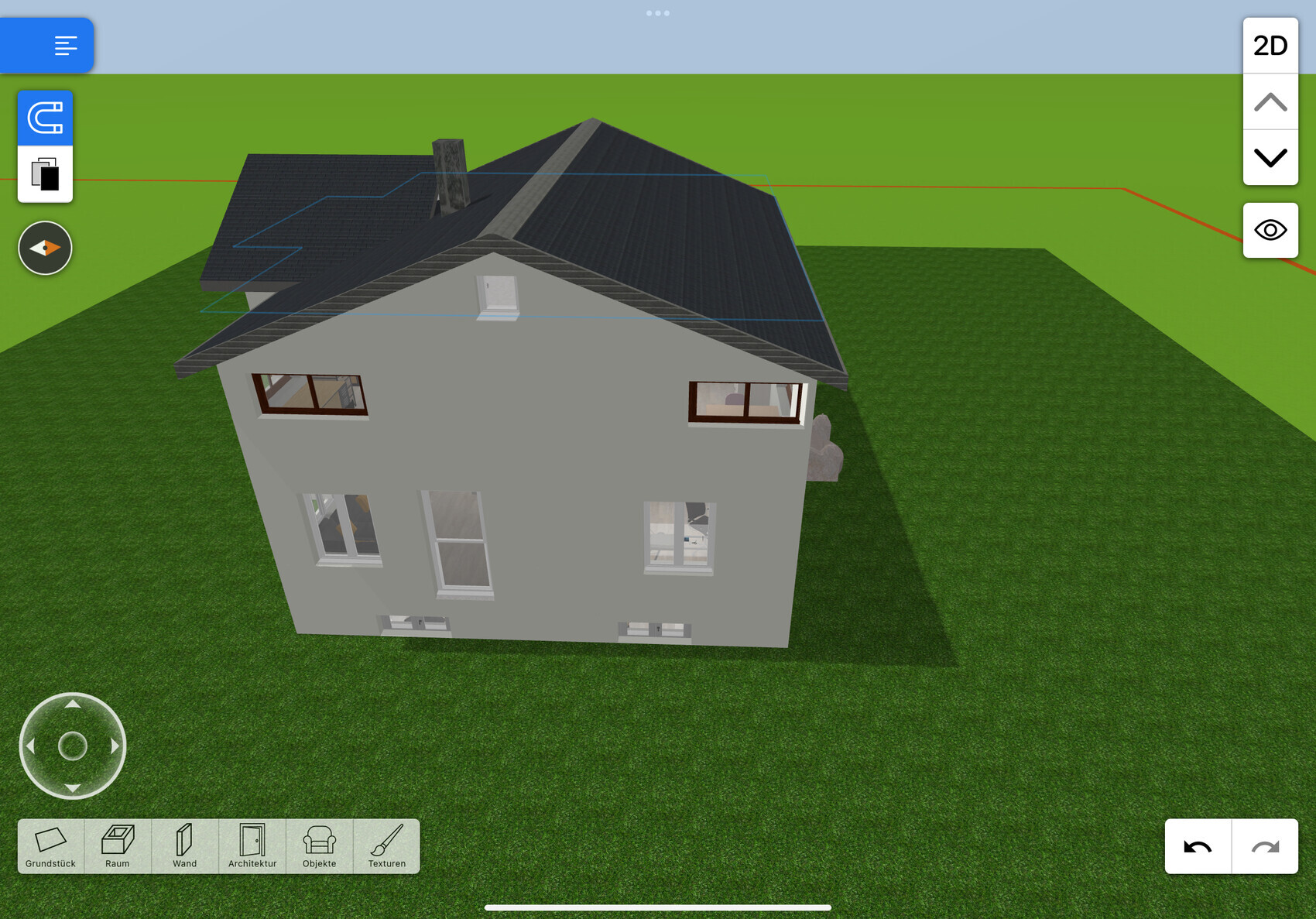

Windows are currently our big focus. With a knee wall height of 2 m (6 ft 7 in) desired, the question is how to design the windows in the children’s rooms.
Corner window? One window? Two windows? Roof windows are out of the question.

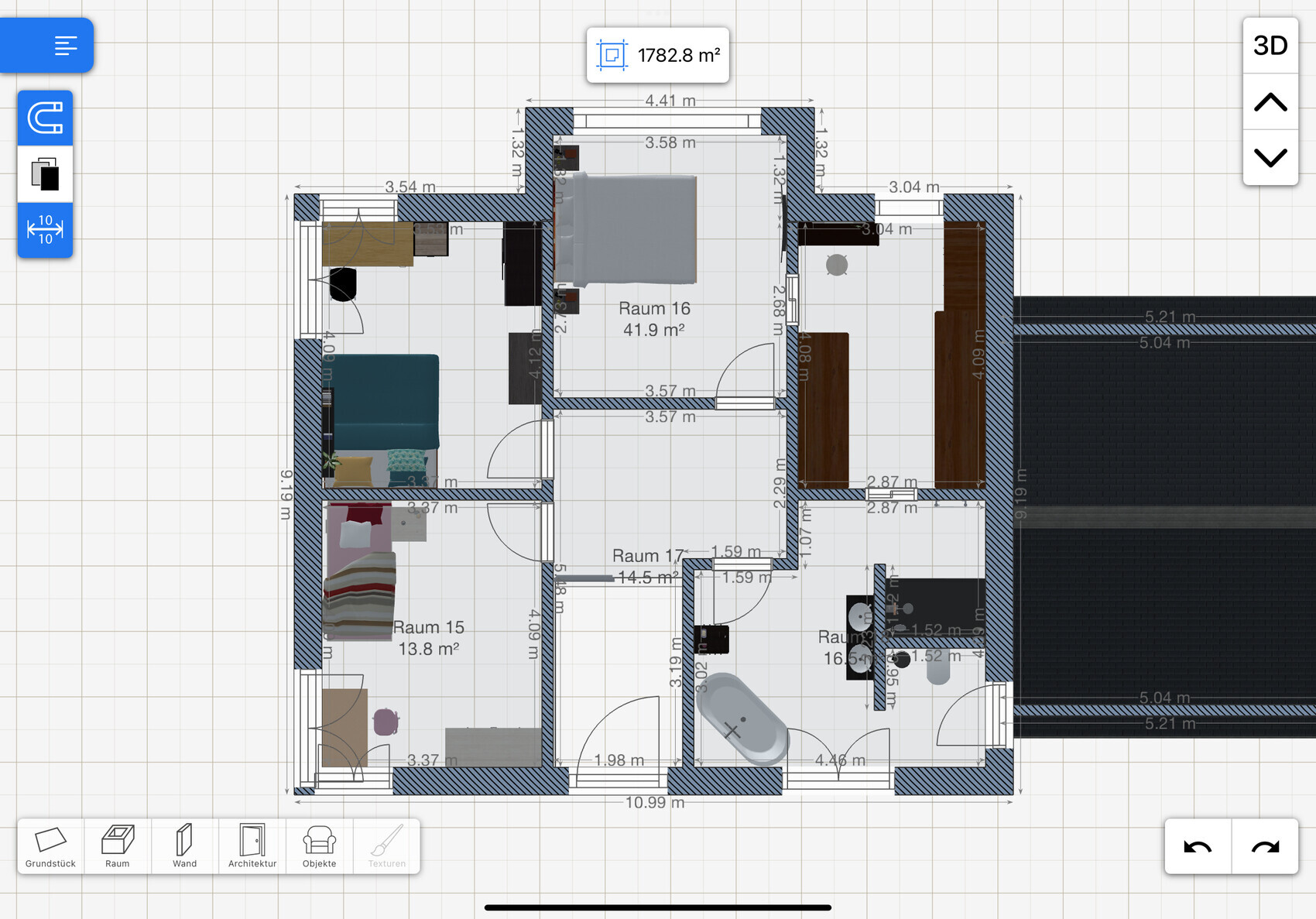

Is the staircase too narrow? Currently 2 m (6 ft 7 in) wide by 2.77 m (9 ft 1 in) long.

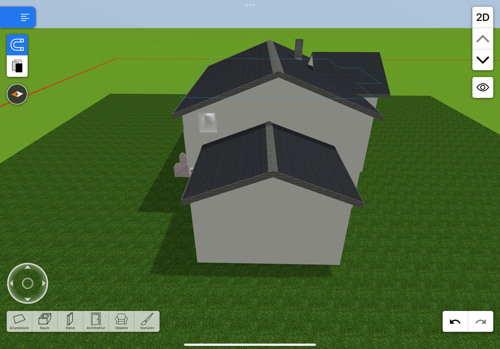

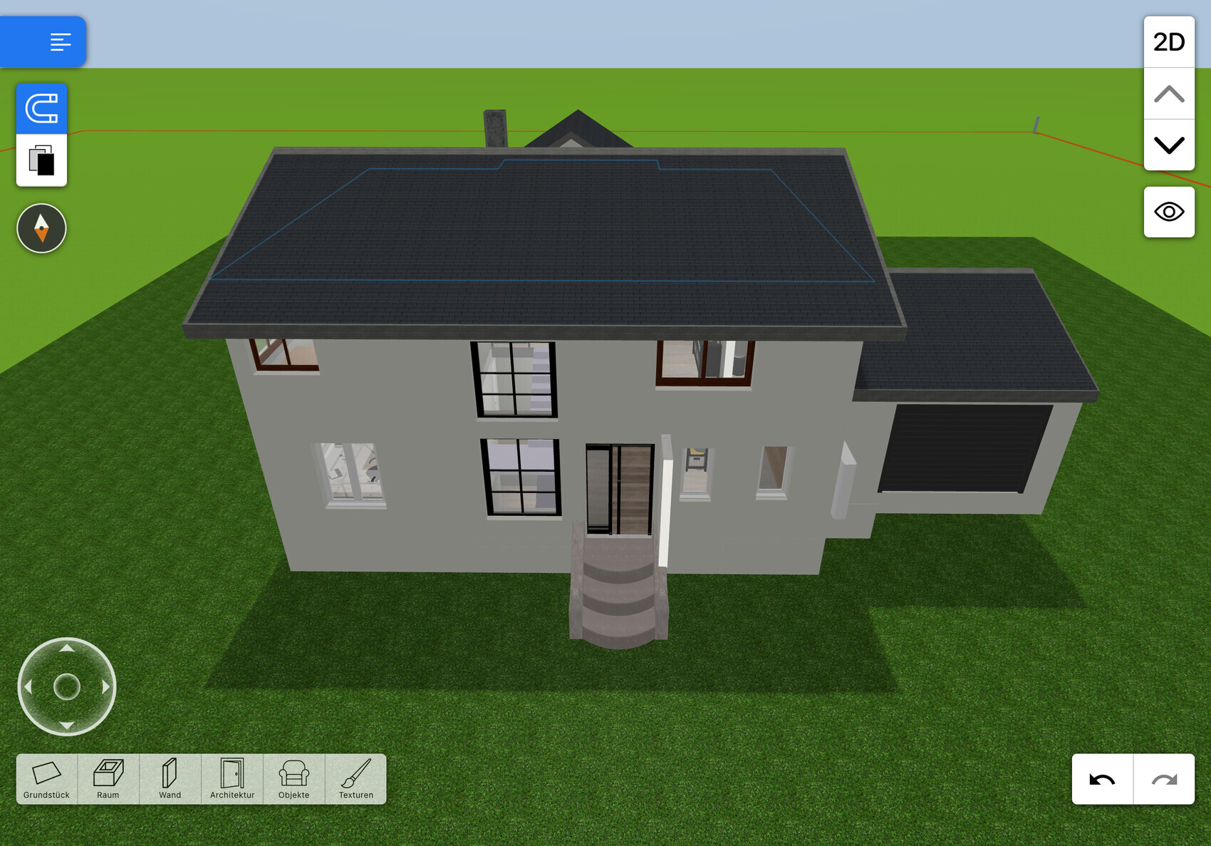

I will now focus only on the broad issues that should be obvious to anyone who can look, even if they are not familiar with the world of design: Take a look at the facades and how uneven and impractical the windows are placed. Maybe you are one of those who like things to be “special” (many say that about their own designs that are basically unbuildable because nothing really fits), but just consider how many different kinds of windows you have used and how inconsistently they are placed at various heights without any apparent reason. The largest panoramic window is located in the bedroom, where you actually don’t need warming sunlight.
With a knee wall height of 2 meters (6 feet 7 inches), you won’t get proper daylight in the room unless there are also gable windows. By the way, you end up looking at the underside of the roof overhang. Two windows placed around a corner are better for ventilating bedrooms.

If you are designing stairs, you should at least know whether a double-turned staircase with different measurements or a staircase with a landing is intended. I don’t see either here. A door frame next to a chimney—I've never seen that before—and it seems the chimney on the upper floor was simply forgotten.
