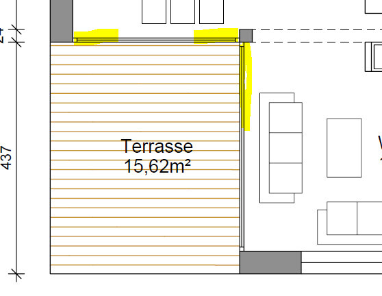

pincher1123 Feb 2021 12:11RomeoZwo schrieb:
I think the 4 windows in front of the entrance door are intended as a privacy screen, a second vestibule (but more like a wind tunnel), or whatever (?).Correct. The front door is hidden behind the outer vestibule. However, this will be replaced by a kind of canopy with side protection.
pincher1123 Feb 2021 12:19ypg schrieb:
Yep! Subtract 180cm (70 inches) for the tall cabinets for the oven and fridge from the 4 meters (13 feet), and you’re left with 2.20 meters (7 feet 3 inches). One meter (3 feet 3 inches) for knives and the coffee machine—everyone’s got something like that—so you’re at 1.20 meters (3 feet 11 inches) plus a 2-meter (6 feet 7 inches) island. In our two-person household, we have more, and it’s tight.The pantry will be reduced in size, but the kitchen counter will be longer.
pincher1123 Feb 2021 12:26Crossy schrieb:
The bed in the master bedroom won’t work like that. At least not with nightstands. Unless you’re planning to sleep permanently on a 1.4 m (4.6 ft) futon. How do you get from the living/dining area to the garden? The bed is drawn as 2 m (6.6 ft) long. So that should work.
We want to access the garden from the living/dining area through the large windows or doors. I’ve attached the plan again. We might still enlarge the space behind the table a bit.
pincher1123 Feb 2021 12:30Alessandro schrieb:
Rotate the bed in the bedroom and do without the window facing the open space. You don’t want to look directly into the children’s room, and the child certainly doesn’t want that either. We had already considered that. I don’t think either the children or we want to constantly be able to see into each other’s bedrooms. ;-)
pincher1123 Feb 2021 12:32icandoit schrieb:
I assume north is at the top right corner of the site plan.
For better understanding, here are the contour lines spaced 1 meter (3.3 feet) apart.
The ground floor is 1.5 meters (5 feet) above the entrance![ATTACH alt="einfamilienhaus-am-hang-feedback-zum-aktuellen-grundriss-474324-1.JPG"]57853[/ATTACH]Exactly right, @icandoit Thanks for your effort!
