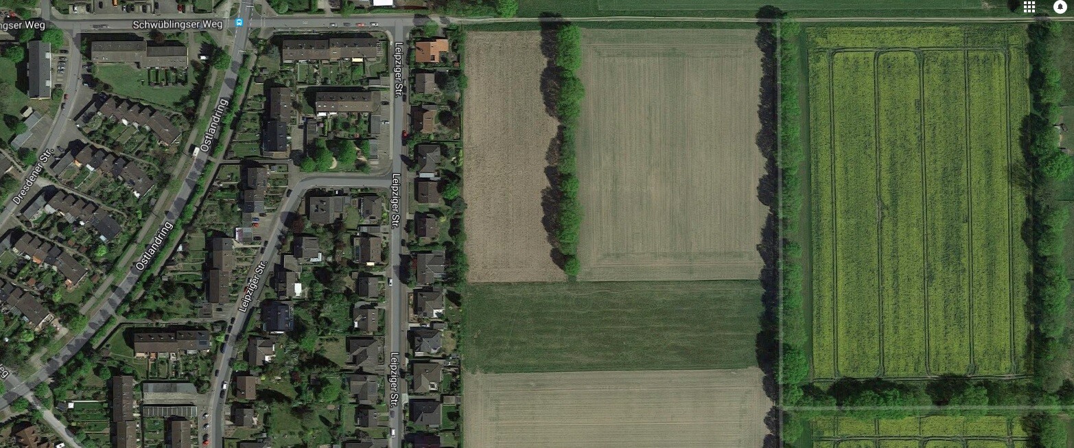

The trees are quite tall, but they are in a row with some spacing between them. This is the row of trees parallel to Leipziger Str. in the photo.
I had indicated the building boundaries, but we are missing one picture. On the north and south sides are the boundaries with the neighbors. On the west and east sides, the distance is three meters (10 feet).

I have to correct myself—I misread the plan. The gray area is the road, not the white one. So the L-shape still needs to be mirrored.
