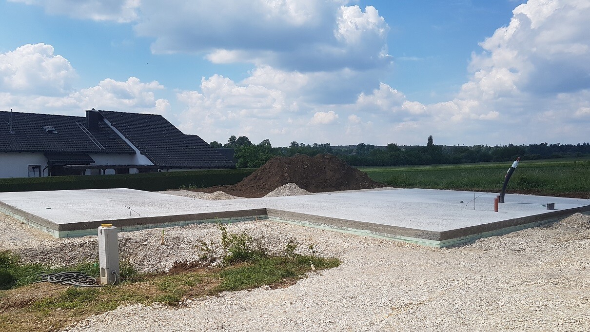

A severe weather warning has been issued for our building site tomorrow from 2 p.m. to 5 a.m. the following day. It is a red alert with warnings of heavy rain, hail, and hurricane-force winds.
At the moment, our base slab is prepared for the concrete pour scheduled on Monday.
Current status:
- 18 cm (7 inches) of perimeter insulation installed
- plastic sheeting on top
- spacers and one layer of reinforcement steel
Can I leave everything as it is shown in the picture without worry, or should I secure anything or take other precautions?

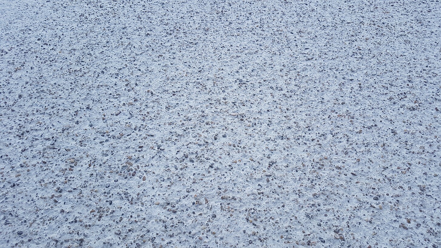

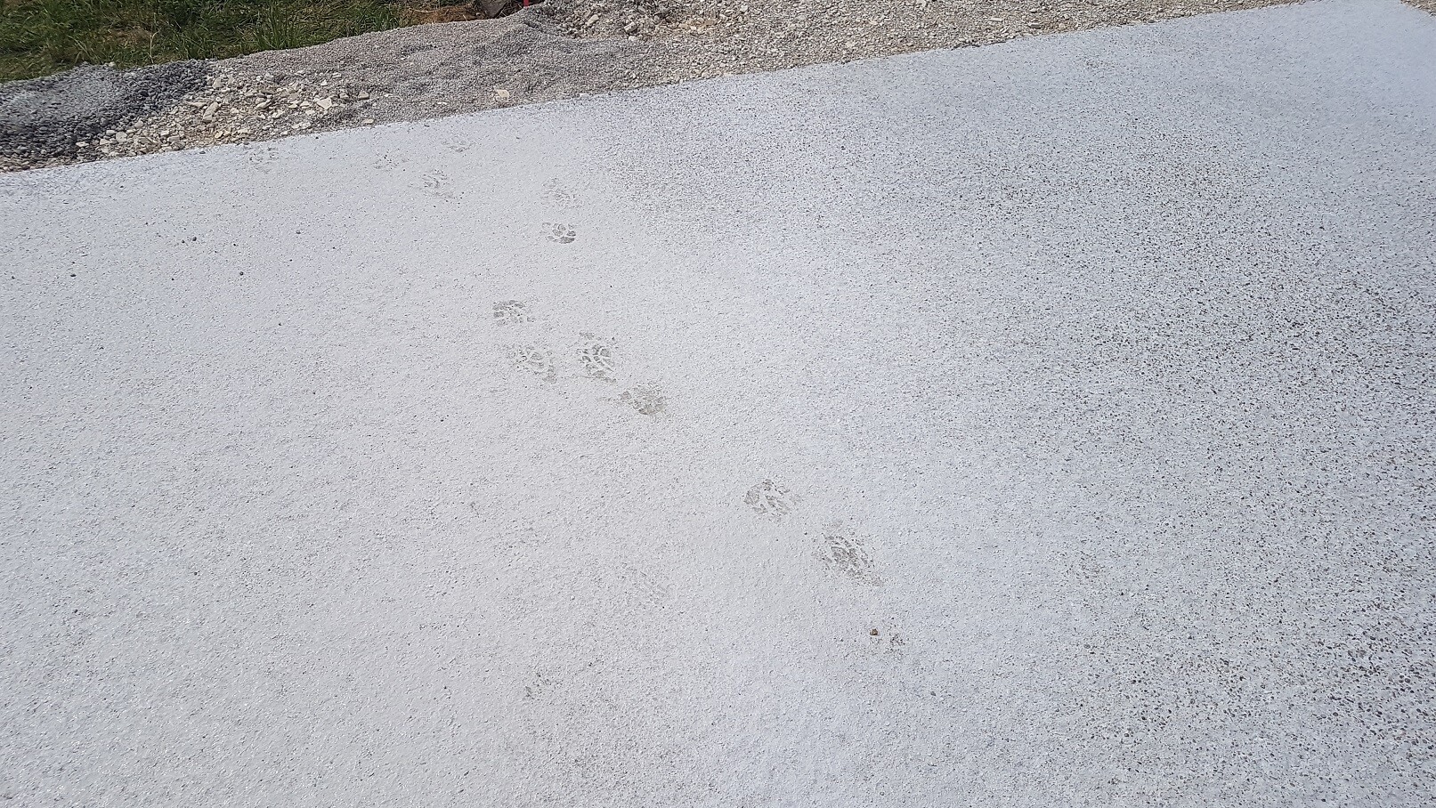

It was still too soft for heavy rain, so now it is bumpy. The fine material was washed away, but the pebbles remained. However, the binder is cement. That did not wash out. Definitely not. Just wait and see how it looks once it has hardened. Whether you need to add more on top, or if the screed specialist can level it out. There’s nothing you can do today anyway.

The surface doesn’t look too bad; it’s not exactly attractive, but it’s acceptable.

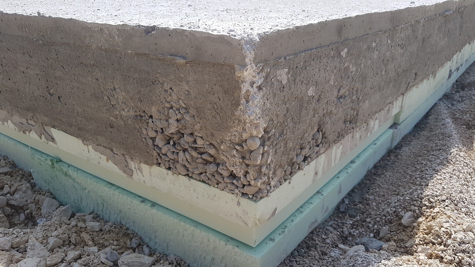

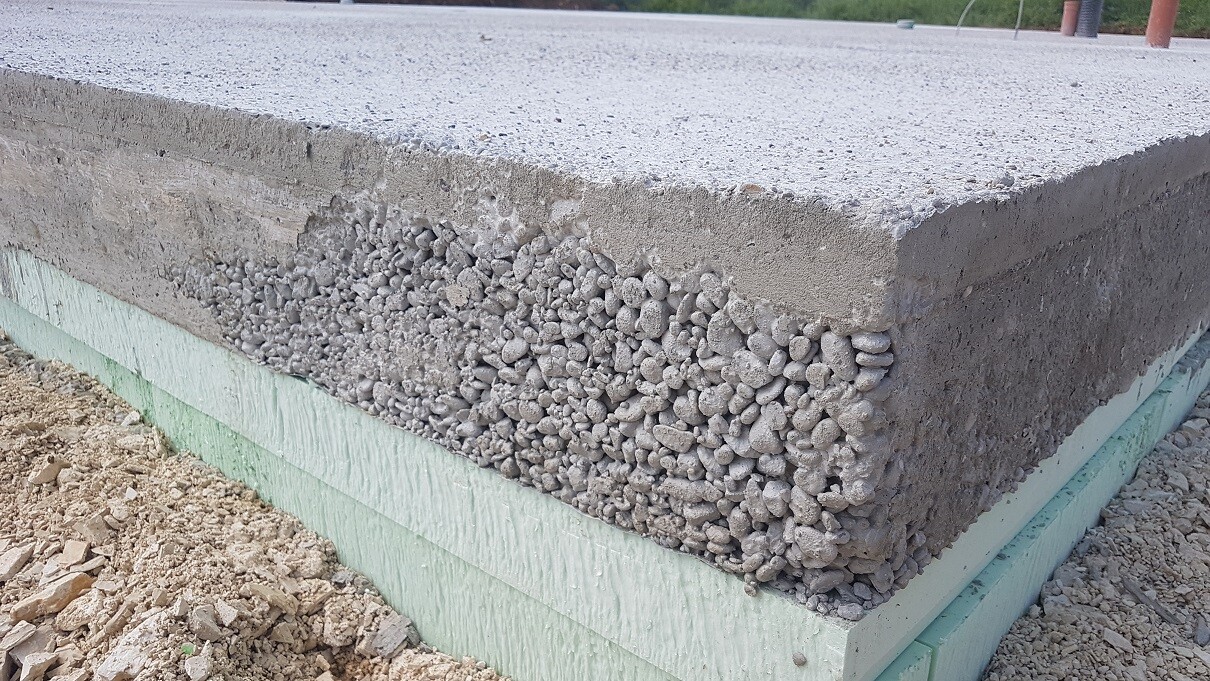

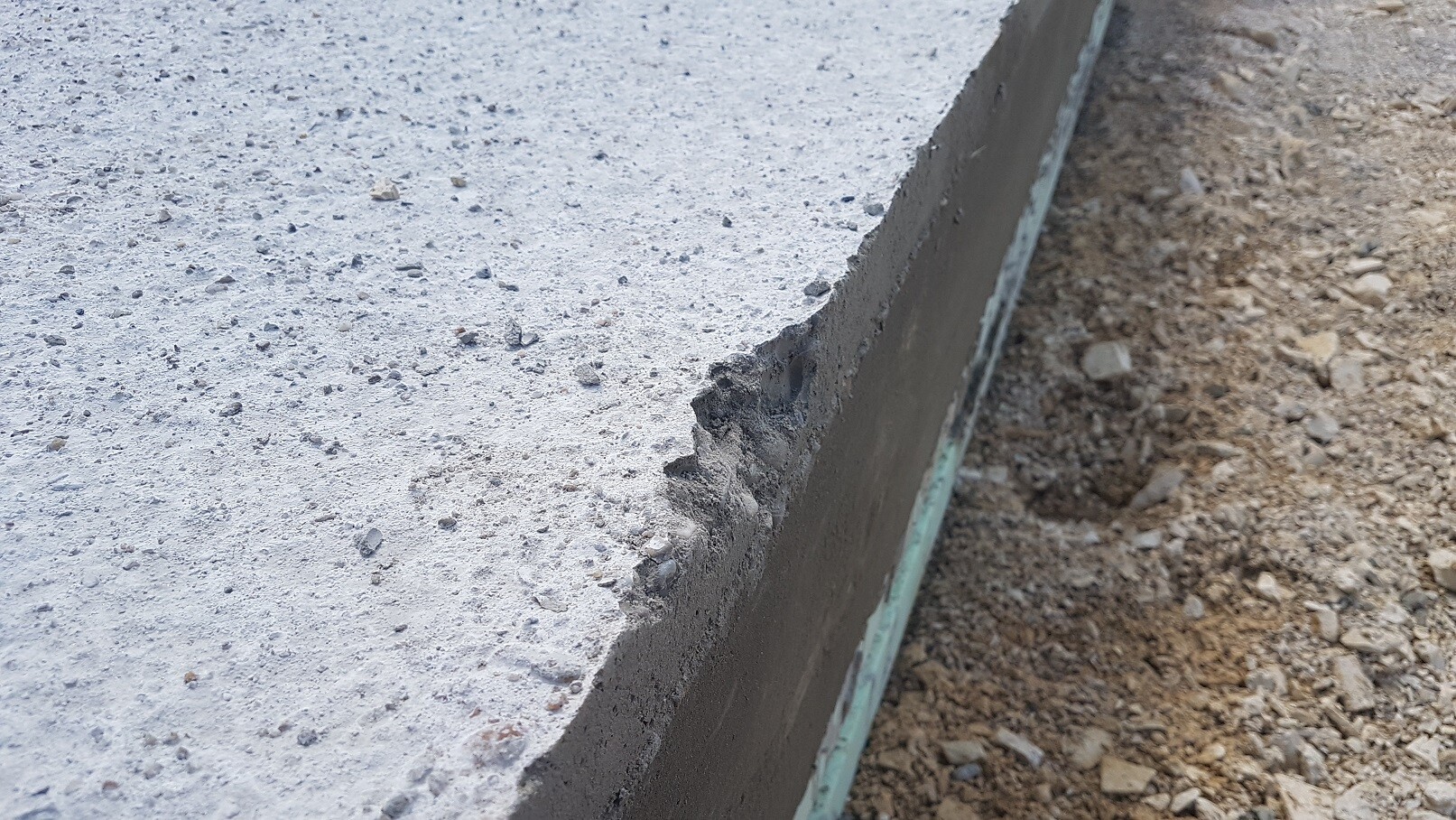

However, what was visible after removing the formwork is less pleasing to me. As a layperson, I can’t judge if this is still okay, especially at the corner, but the site manager from the foundation crew said it was completely fine (which is understandable, of course).
I would really appreciate honest opinions on the following pictures:
