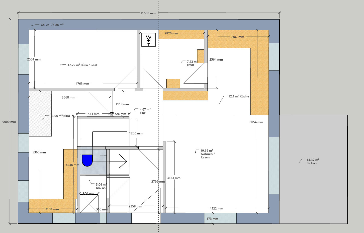

- an accessible and senior-friendly apartment on the ground floor (about 90-95 m² [970-1,020 sq ft]), entrance also from the street side
- the ground floor has an approximately 3 x 5 m (10 x 16 feet) extension towards the garden (northeast), which is used as a balcony on the upper floor
- possibly the walls between kitchen and living room on the ground floor can be removed, which might improve accessibility

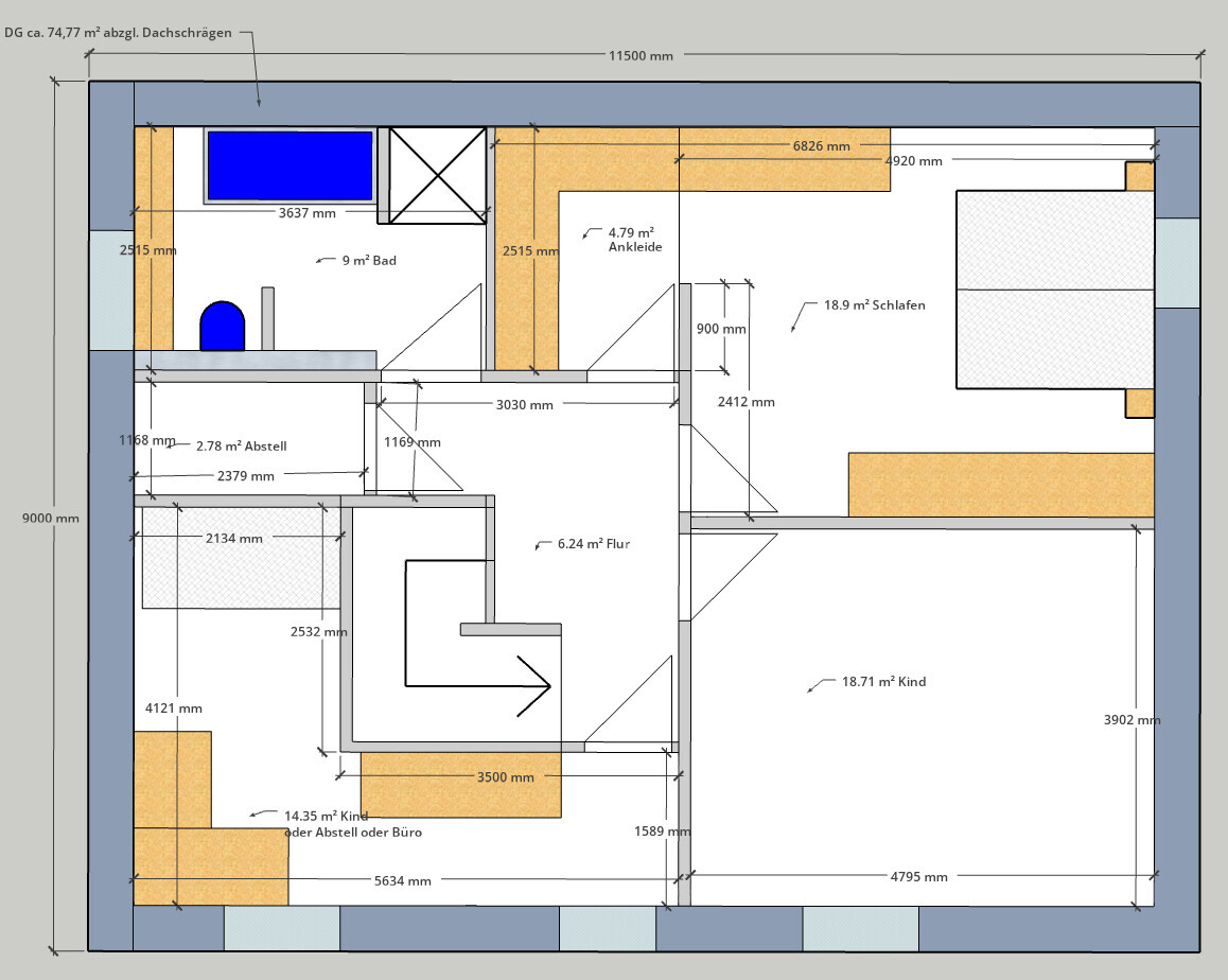

- a two-story apartment on the upper floor and attic floor with about 77 m² (830 sq ft) each, minus roof slopes; separate entrance via external staircase on the (side) gable wall
- special feature on the upper floor: the guest toilet is located under the stairs (I know of an apartment where this was under a roof slope with 1.5 m (5 feet) height — which worked fine, so this should be possible here as well, although footstep noise could potentially be an issue)
- roof pitch on the street side (left in plans): approximately 41°, on the garden side with a knee wall height of 1.2 m (4 feet) (possibly higher) about 25°
- in the floor plan, I have drawn the rather thick 473 mm (19 inches) exterior walls of my passive house; thinner walls and thus larger rooms are always easier to achieve than vice versa
- door widths are generally set to 90 cm (35 inches) (primarily for accessibility on the ground floor)
- whether the extension in the basement is basemented or only has a cantilevered slab depends on budget and the QNG calculation
- windows and furniture are only roughly sketched in
I tried to use the space as efficiently as possible, although the two L-shaped rooms on the upper and attic floors bother me slightly (on the other hand, my childhood bedroom looked similar).

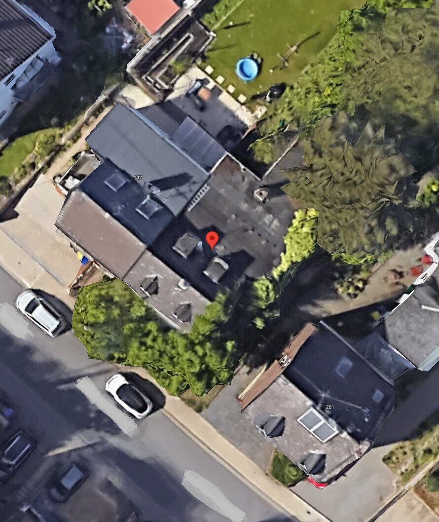

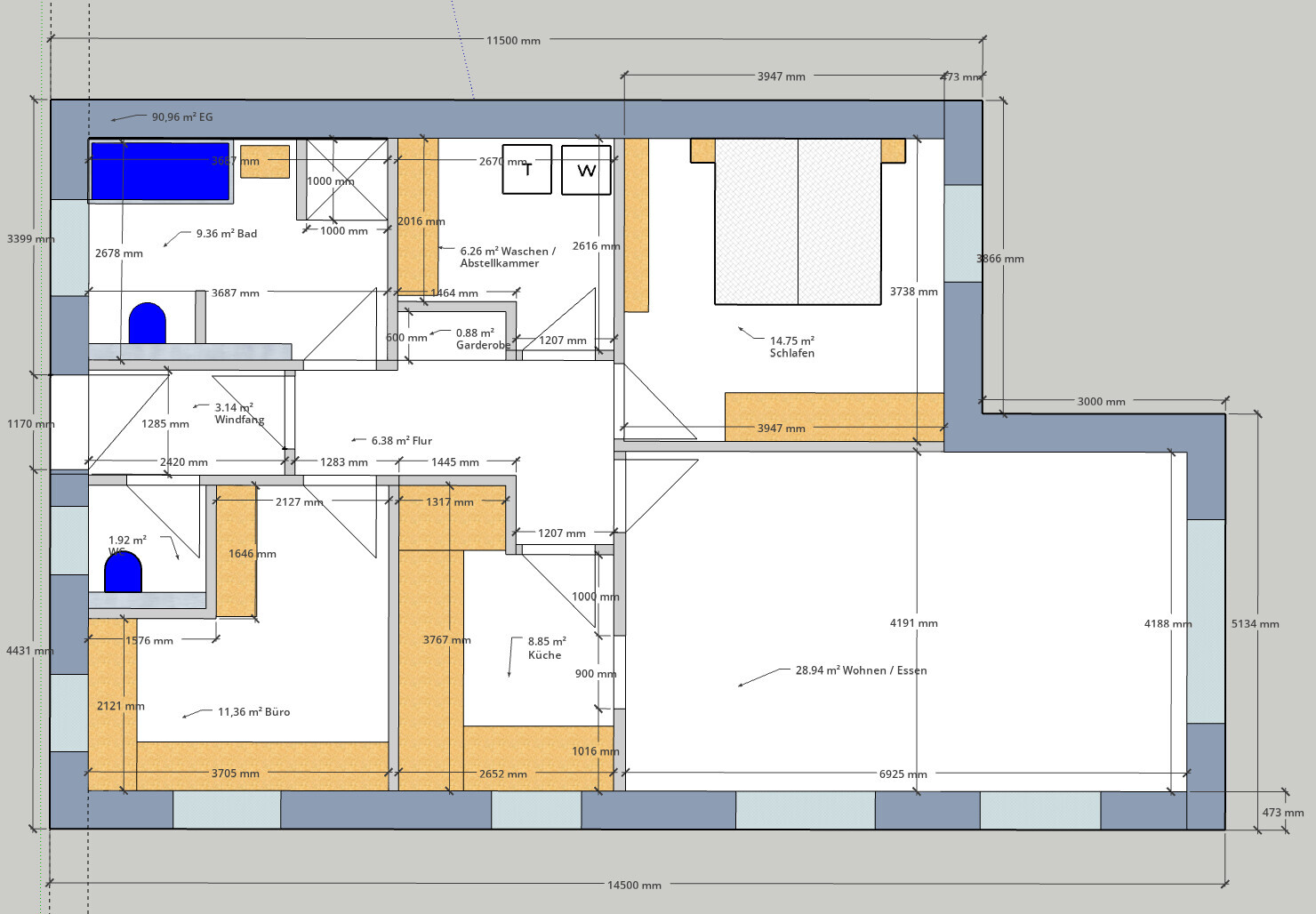

Could you please share a clear site plan, even a hand-drawn one, showing the entire setup? A picture says more than a thousand words. Also, the floor plans are not entirely self-explanatory.
Planning tip: Washbasins also need space in bathrooms, and wardrobes require at least 60 cm (24 inches) in width for planning. Please also consider accessibility issues – on the ground floor, there is no way for a wheelchair to pass through the door and hallway.
samot-dwarf6 Sep 2024 01:37According to the current parking space regulations (thanks for the search term), I need 3 parking spaces, which can be reduced by one-third to 2 spaces depending on the area zone and its public transport connection (however, I can only check this tomorrow, as the geoportal where I can determine the zone is currently not working). Alternatively, I might be able to pay a buyout fee of about 4,000 EUR to the city if the creation of parking spaces is not possible. Additionally, I need 5-6 bicycle parking spaces, which I can provide in the basement or alternatively near the carport. In theory, I could reduce car parking spaces to one-quarter by providing 4 more bicycle spaces, but with only 3 parking spaces this will (probably) not be possible.

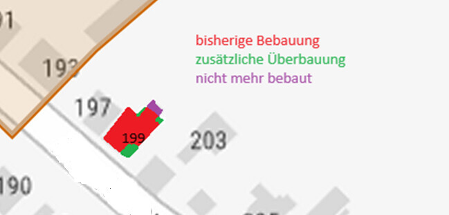

I have attached an aerial photo that still shows the old, demolished house. All trees on the property were removed (except for those in the unseen far back part of the garden, which is irrelevant for the construction). The new house will have approximately the same dimensions, except that the extension at the rear right will be shorter.
I have also attached a site plan from the geoportal, where I have color-coded areas that are no longer or additionally built over.
Regarding accessibility, I agree that the corridor would need to be 21.5 cm (8.5 inches) wider (1.5 m (59 inches) instead of 1.285 m (51 inches)), but alternatively, a width of 1.2 m (47 inches) would also suffice if there was a turning area of 1.5 x 1.5 m (59 x 59 inches) that I could reach by widening the kitchen doorway by 30 cm (12 inches) (then it would be an L-shaped kitchen instead of an awkward U-shape). Alternatively, I could design the living/kitchen/dining area and corridor to be completely open, meaning to omit both doors plus the sliding door and the small section of wall in between.
I originally planned the proper cabinets with a depth of 60 cm (24 inches), and bookshelves or similar somewhat narrower. However, the specific furniture will ultimately be the tenant’s decision — I don’t know if they might still have a built-in wall unit from their great-grandfather, or if they’ll buy new furniture at IKEA, or just own a large chest of drawers :-). So the furniture is just a placeholder to show that the layout is roughly workable.
Regarding the sinks, you’re right, I was too lazy to draw them in. Since I’m not planning luxury apartments, they will probably only have simple sinks (so no modern, 3-meter-wide (10-foot) double sinks or other “fancy stuff”), so the free space available in the bathroom should be sufficient for this.

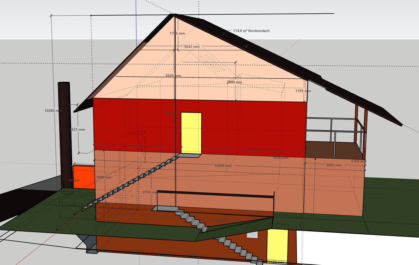

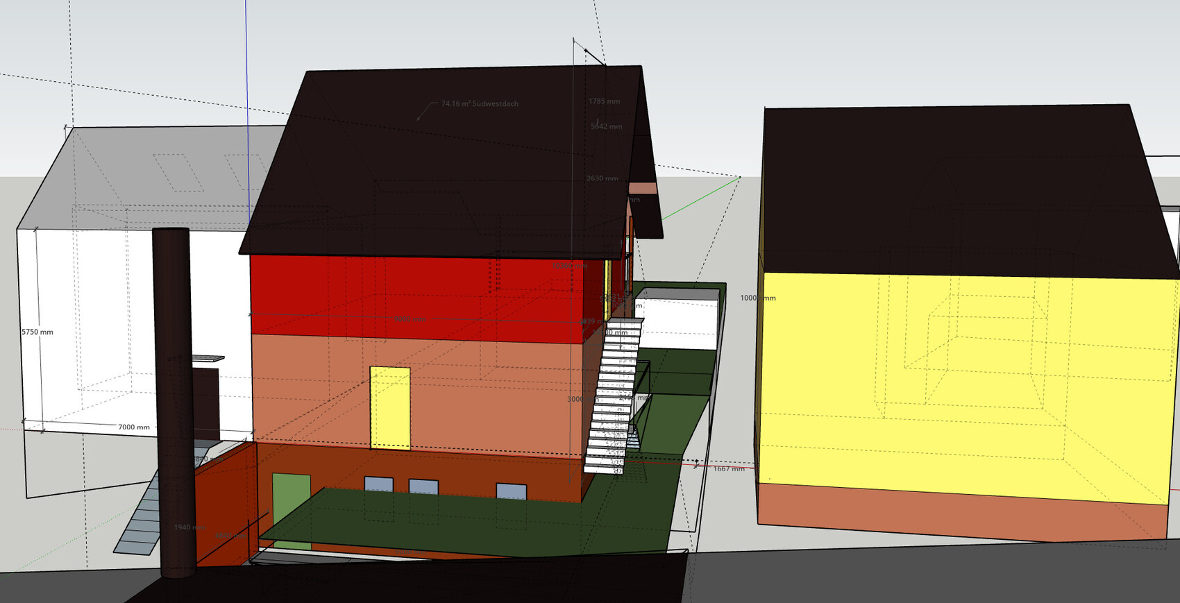

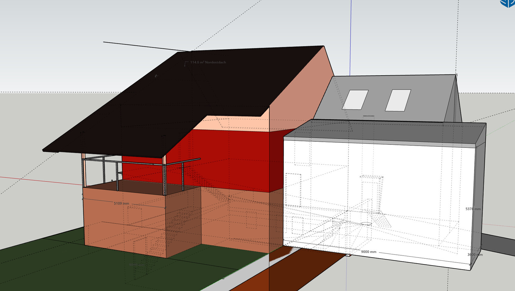

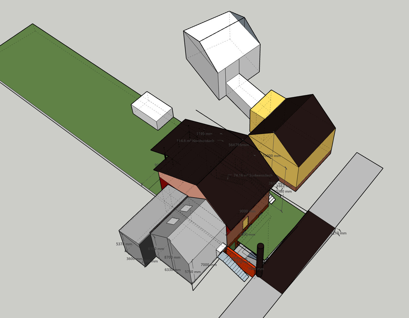

samot-dwarf6 Sep 2024 01:47PS: Here is another screenshot from SketchUp, showing a bird’s-eye view from the west (this perspective shows the entire ensemble best). Please note that the roof overhangs are drawn at approximately 1 m (3 feet).
You can change the perspective by holding down the mouse wheel (I wouldn’t recommend this for the floor plan). Zooming also works with the mouse wheel. By pressing H, you can then use the left mouse button to move the map/plan left/right/up/down.
