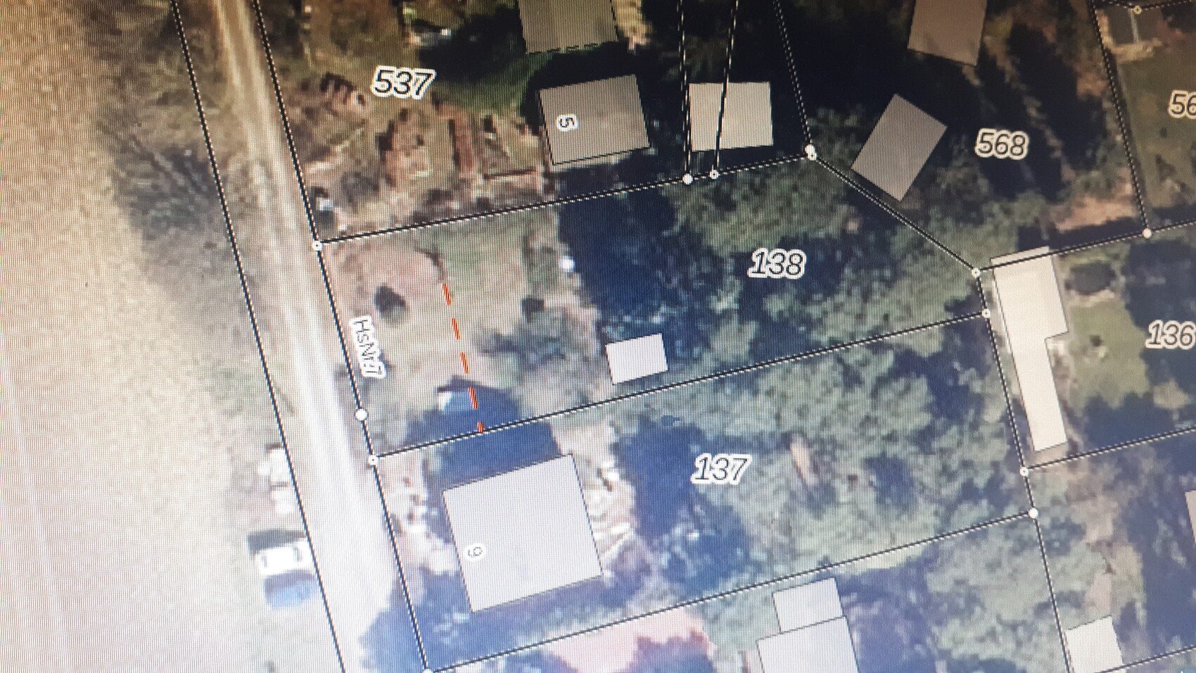

The tip about the Geoportal was helpful. In the BrandenburgViewer, you can also see the soil layers of the surrounding fields (across the road): sand.
We can also read measurements there, but we’re not completely sure about the flatness. The front part looks visually level; this is where the house is planned to be built (at the same elevation as number 9). The rear part is wooded and slopes down in two steps, about 1.5 meters (5 feet) lower.
(The photo was just taken with a camera; the marked route is between the fence and the tree that will remain.)
hanghaus20003 Jun 2021 14:08How long is the street frontage? I would rather position the house like No. 5. Otherwise, you will have the neighbor directly to the south.
What is that at house No. 5? It looks so untidy.
The street frontage is 17.5 meters (57 feet), and the lot extends almost 50 meters (164 feet) to the rear. After 19 meters (62 feet), the property drops by 1.5 meters (5 feet), where two steps and a staircase have been installed. The area is quite wooded. So, a lot of trees would need to be cut down (if permission is granted) and the terrain carefully shaped. We like the small forested area at the back very much; there is currently a cabin and a nice shady, private terrace there.
I have no idea what is left standing at number 5. When we visited, there were normal flower beds, and it looked neat. However, number 9 is currently undergoing a full renovation.
