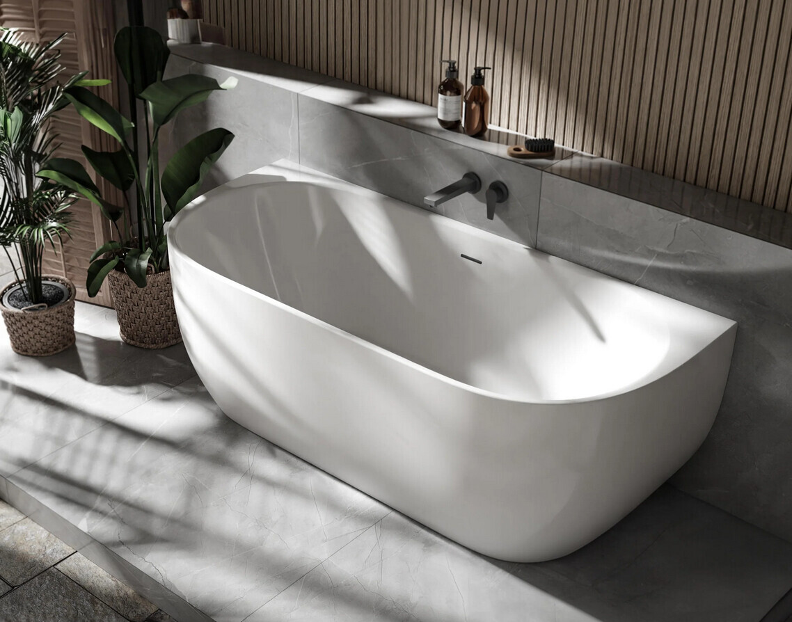

kiam1302Hello everyone,
I would like to install the following bathtub in a fully tiled bathroom:
In the manufacturer’s installation manual, there is an illustration mentioning the DIN18523 standard:
What should I apply between the tile and the bathtub?
Is it purely for decoupling/soundproofing, or is it sealing?
I cannot use a traditional bathtub sealing strip, where part of it is embedded in sealant, because the tiles are already installed on the wall.
Thank you very much and best regards

Allthewayup5 Nov 2025 09:08This is a bathtub sealing tape that is adhered to the front edge of the tub before it is installed against the wall. The matter is anchored in the DIN standard mentioned in the picture.
Do you have any suggestions for which product I could use?
A traditional bathtub sealing tape is glued to the end face of the tub, and the other end is embedded in a waterproofing material before the tiles are installed.
In my case, the tiles are already on the wall, which is common for this type of bathtub.
nordanney5 Nov 2025 09:26kiam1302 schrieb:
Do you have a suggestion for which product I could use?The type of secondary waterproofing is clearly shown in the image. For this, there are self-adhesive butyl sealing tapes available from various manufacturers (usually adhesive on both sides), which are no longer visible after the silicone sealing. The manufacturer basically doesn’t matter.
