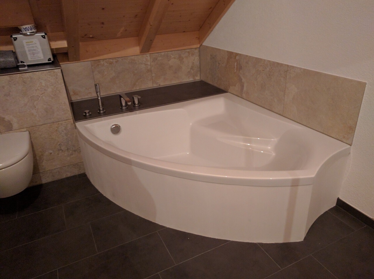

Do you happen to have a picture of your bathtub?
