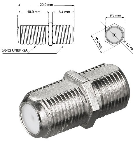

To avoid issues with filters/dampening, it is best not to use such a junction box, but simply an F-connector coupling [1] for the two cables. This then acts as just a cable extension.
Does anyone happen to know if something like this is also available as a (flush-mounted) outlet?
Thanks.
Metal pipe plug with external thread and hex head
Uwe826 Jun 2016 14:37
