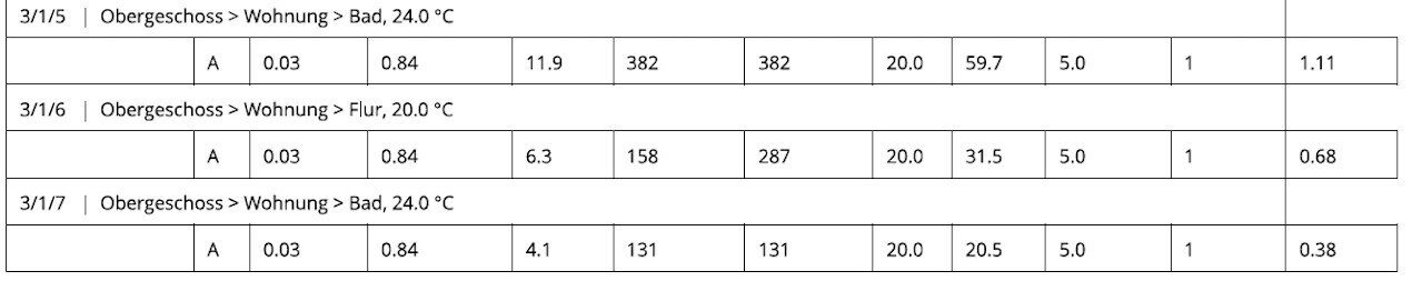

When will it be ready on your end? Otherwise, you could still hire a professional for the planning?The sanitary inspection took place on August 23rd, and since then I have been waiting for the heating load calculation, which I received yesterday in the attached form. We were told quite early on that the windows and sanitary installation are the bottlenecks in the construction. Therefore, I don’t want to delay that trade.RotorMotor schrieb:
The list only shows one bathroom, and now there are two more bathrooms?We have a toilet on the ground floor and two bathrooms on the upper floor. All three are also listed. 🙂Edit: I just noticed that, for some reason, the forum is cropping the screenshot. For completeness, I’m attaching the bottom three rooms again.

fromthisplace23 Sep 2022 20:18We received feedback today: the children's bathroom and the master bathroom will be installed with 10cm (4 inches) spacing at no extra cost. We can accept this compromise.
