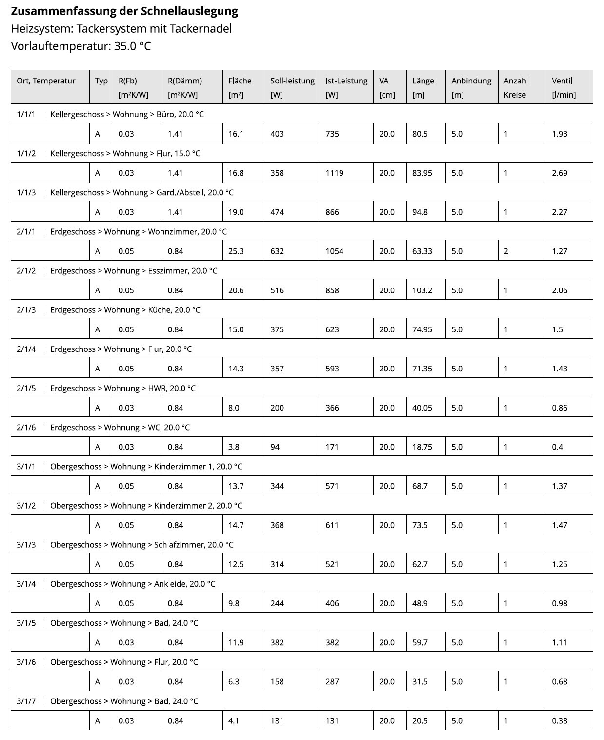

fromthisplace19 Sep 2022 17:14Our plumber is planning the heat pump’s supply temperature at 35°C (95°F) with pipe spacing consistently at 20 cm (8 inches).
I then requested a cost calculation for approximately 30°C (86°F). (see attachment)
I received this without further explanation. Before discussing it with him, I would like to clarify the following points:
1) I understand that the item "Length" refers to the planned pipe length for the room. If multiple heating circuits are planned there, do I need to multiply the "Length" by this number? Is that correct?
2) I understand that more materials (pipes, manifolds, fixing clips) and more labor add to the cost. Am I missing anything?
3) If I have understood 1) correctly, I arrive at a total length of 1,059.71 m (3,478 ft) and 17 heating circuits at 35°C (95°F), and 1,929.2 m (6,331 ft) and 27 heating circuits at 28°C (82°F) supply temperature. The difference is 869.49 m (2,853 ft) of pipe and 10 more heating circuits.
In terms of cost, where should we expect the price for this additional performance to be at the current stage? Will the construction costs increase significantly or is this trade unaffected?
F
fromthisplace19 Sep 2022 17:41The additional costs are estimated to be 3,980 euros. I do not have a detailed breakdown of individual items.
What do you think: Is this fair? Is the investment worthwhile over the lifetime of the heating system?
SaniererNRW12319 Sep 2022 18:46fromthisplace schrieb:
What do you think about this: Fair?In my opinion, the price increase is fair. For DIYers purchasing materials online, the extra cost already exceeds 1,000€ (about $1,100). These are the cheapest online prices, not premium branded materials or standard wholesale prices. Plus, the installation time is nearly doubled. If it fits your budget, go for it. In my view, it has many advantages and only one disadvantage.
Advantages:
- More comfortable floor, as it is not as warm (yes, some women complain that the floor is no longer "nicely" warm...)
- Energy savings
- Less demand on the heat pump = less strain on the system
- Future-oriented, beneficial when reselling the house
- Reduces your home's carbon footprint
Disadvantages:
- Costs more money
