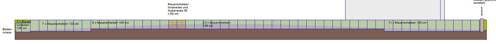

What is this about exactly: L-shaped blocks – are the height measurements supposed to indicate the free height on the downhill side of the height difference – is the "concrete" in which the wall panels are set meant to be a foundation ... ... ...?1. The planned height difference between our property and the neighbor’s ranges from 35 cm to 100 cm (14 inches to 39 inches).2. The top of the wall should be level along its entire length; the land slopes down at both the front and back.
3. The L-shaped blocks will be installed "with C20/25 concrete," according to the quote.
Is this explanation sufficient?
