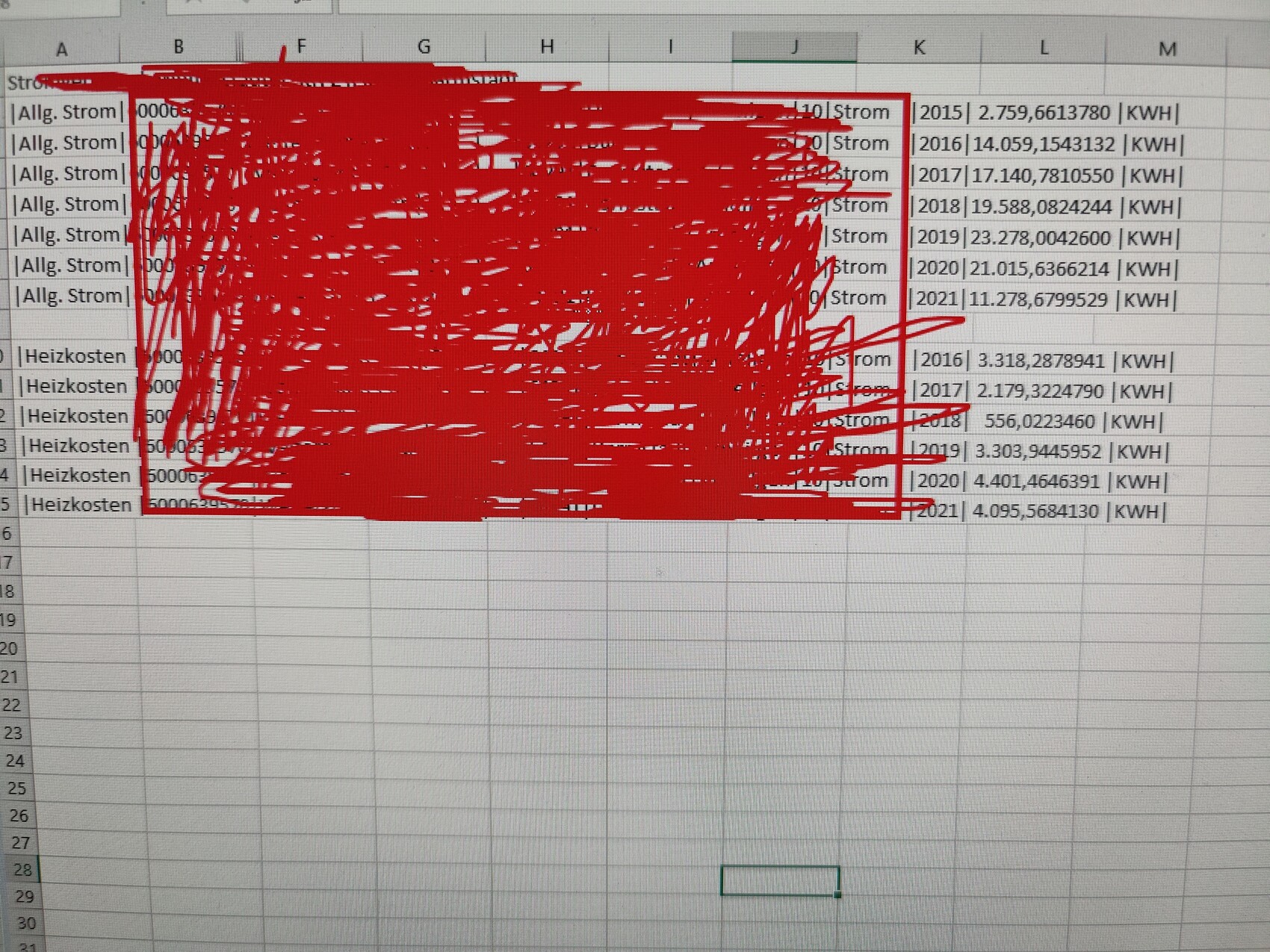

We have received the following data:
Heating costs
2016: 3,318.28 kWh
2017: 2,179.32 kWh
2018: 556.02 kWh
2019: 3,303.94 kWh
2020: 4,401.46 kWh
2021: 4,095.56 kWh
General electricity
2016: 14,059.15 kWh
2017: 17,140.78 kWh
2018: 19,588.08 kWh
2019: 23,278.04 kWh
2020: 21,015.63 kWh
2021: 11,278.67 kWh
Is this sustainable? We would be moving in as six people and would need to heat every room because of the children. Best regards
Screenshot einer Excel-Tabelle zu Strom- und Heizkosten; zentrale rote Markierung verdeckt Daten
Excel-Screenshot: Energiekosten-Tabelle, rote Markierung verdeckt sensible Daten.

Do I understand correctly that the electricity for the electric underfloor heating was measured separately? If so, the values are fine—unless additional electric heating elements are not included in the measurement.
However, the year 2018 remains a mystery in terms of heating costs—did they have open fires inside the house that year?
The remaining electricity consumption is quite high; such levels are typical for households with a pottery kiln, operating a hot tub, using a sauna, running a server farm, or similar.
If you have information about other high-consuming devices, you can get a clearer picture.
To put the electricity bill into perspective, also consider the absence of other energy sources (oil, gas). Then the 400–500€ figure doesn’t seem so bad anymore.
If the house otherwise seems ideal, I wouldn’t see the electricity costs as a decisive factor preventing a decision.

Looks like the headings got swapped 😉. From 2016 to 2021 an average of 17,500 kWh at 30 cents per kWh equals about 440 € per month.
