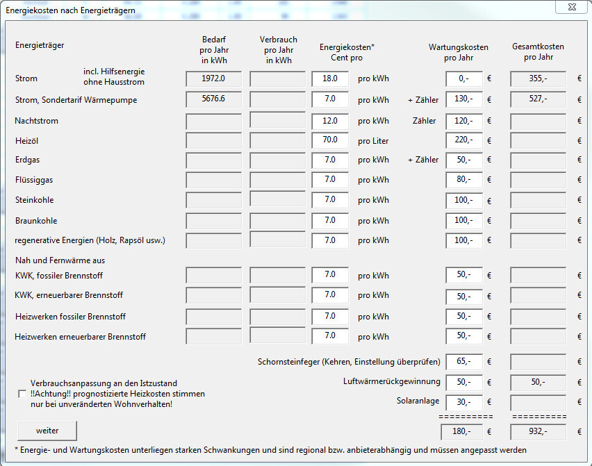

kalle200017 Dec 2015 00:54Hello everyone,
First of all, thank you for your quick responses!
At first glance, it seems that this is apparently correct. The 240 m² (2583 sq ft) referred to the floor area. But the wall area of about 260 m² (2799 sq ft) makes more sense. We have also planned a controlled ventilation system with heat recovery. A fireplace as well, but mainly for aesthetic reasons.
My concern is that the heating costs with an air heat pump could end up being quite high by the end of the year. Hence the idea to improve the insulation. The additional cost from T12 to T8 for our shell builder is about 6000 euros.
Attached are the thermal insulation certificate and the heating costs. I had to remove some parts so the file would not be too large. Hopefully, there is still enough information.
Thanks again for your effort and best regards,
Tobias

At a glance: There really is a mistake here... I am not aware of heat pump electricity costing as low as 7 cents.
You should rather expect heating costs of around €1600 (approximately $1700) per year.
The energy saving regulation also refers to a heating demand of 19,000 kWh.
