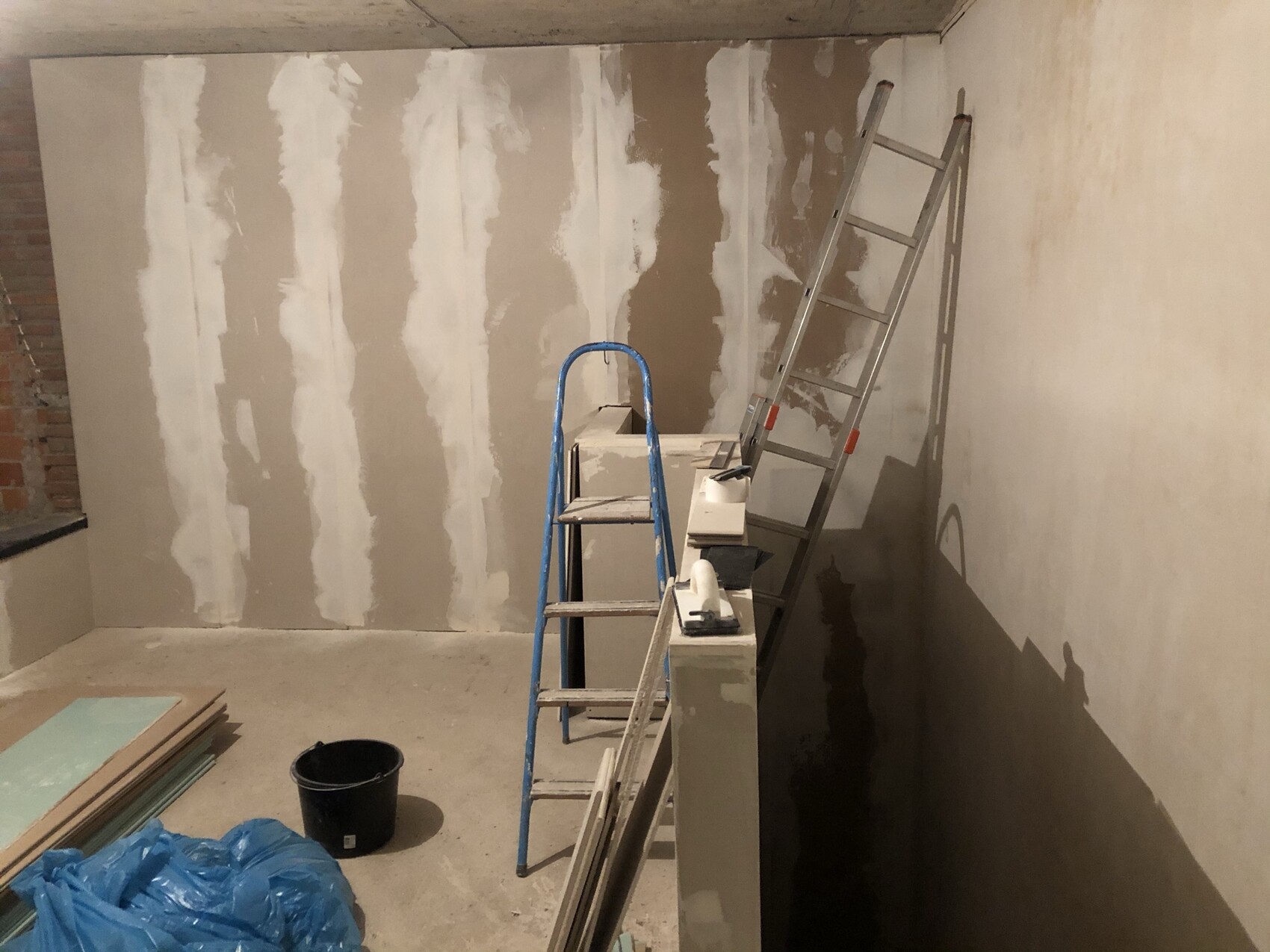

Although I also do some tasks myself. The concealed cistern frames were quickly fixed to the wall in one evening. Drywall installation isn’t rocket science either – but I definitely won’t build a room divider like that again...

Complete DIY drywall work (just one wall and the room divider).

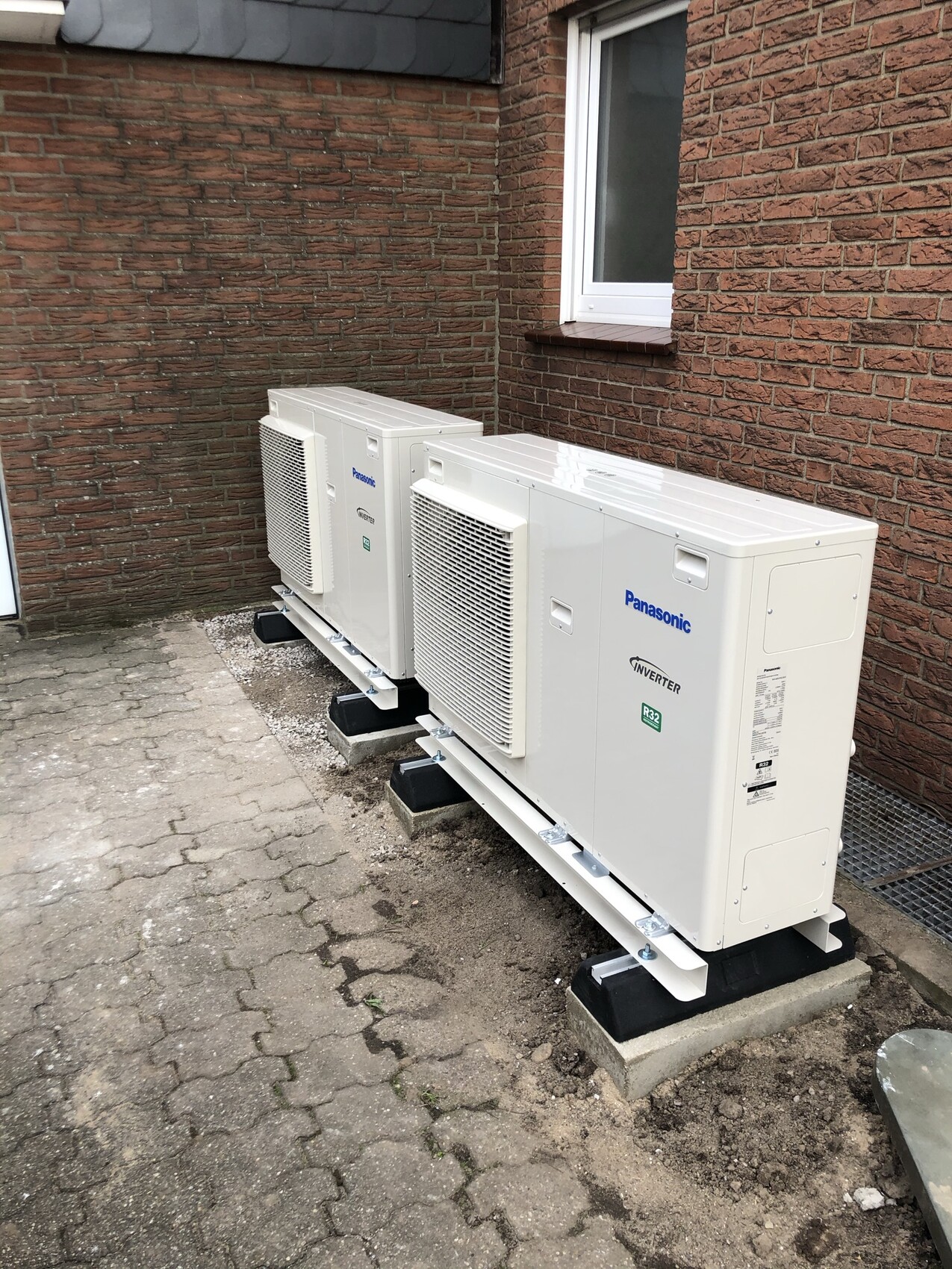

nordanney4 May 2021 10:56Here is an update on what has happened so far:
Problems encountered so far:
Costs so far approximately €90,000 (T€ 90). Screed scheduled for 17.05. (May 17). Hardwood flooring is already stored in the basement. Bathrooms can then be completed – except for tiles, everything is ready. New radiators for the rented upper floor apartment are also ready.
Larger upcoming expenses will include bathroom tiles, some paint (partly already available – fine plaster) as well as exterior insulation after summer.

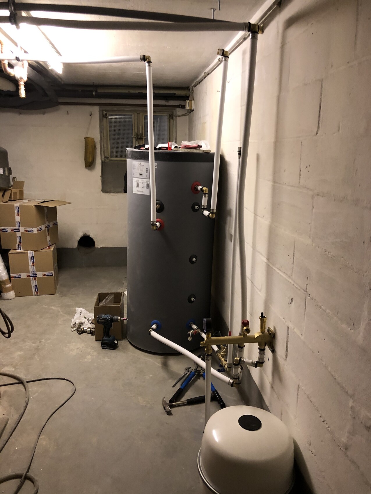

- Sanitary pipes completed
- Window installation in progress
- Heating system installed, heat pumps set up

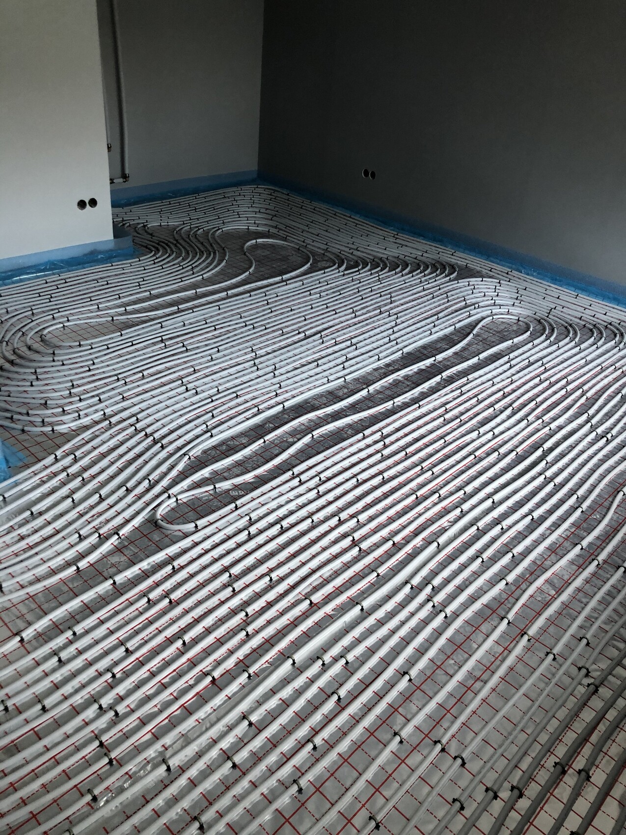

- Underfloor heating currently being installed
- Drywall completed

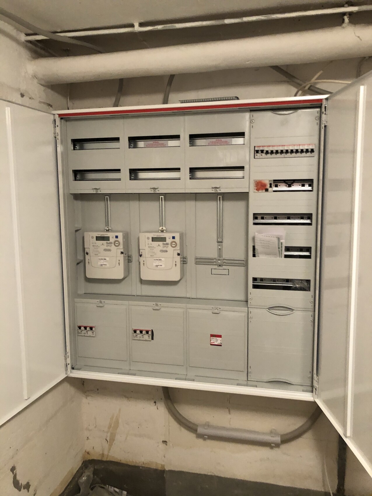

- Electrician nearing completion

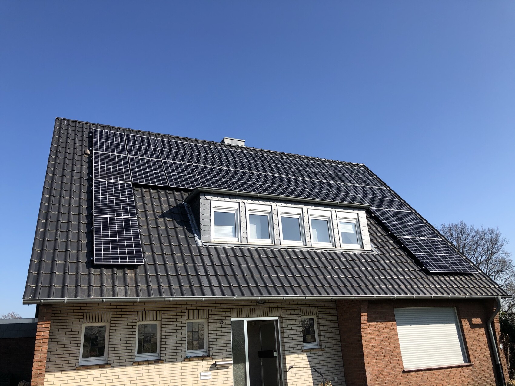

- Photovoltaic system operational
- Wallbox charging the new car
- Core drilling for decentralized mechanical ventilation and installation of ducts/devices done

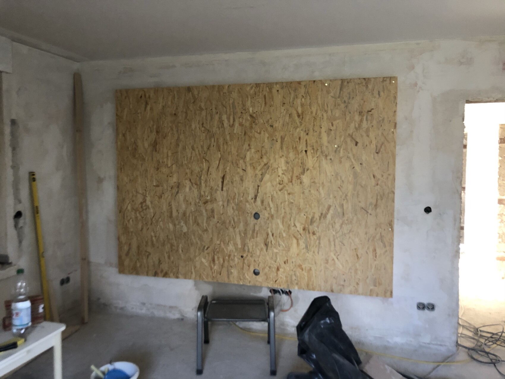

- TV wall prepared (LED strips will be installed around it, area covered with 60x40cm (24x16 inches) natural stone from Planeo)
