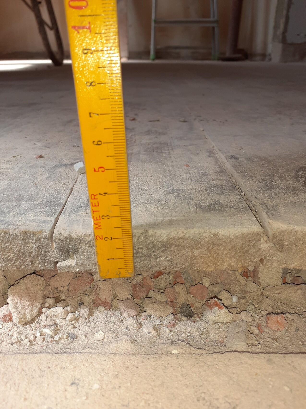

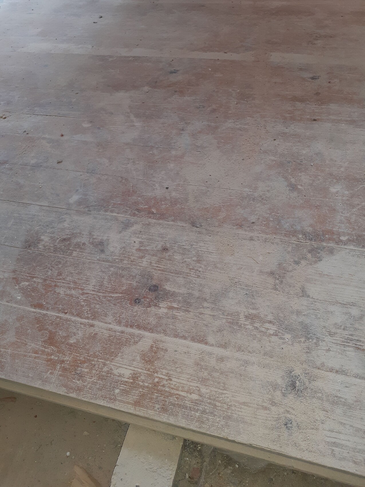

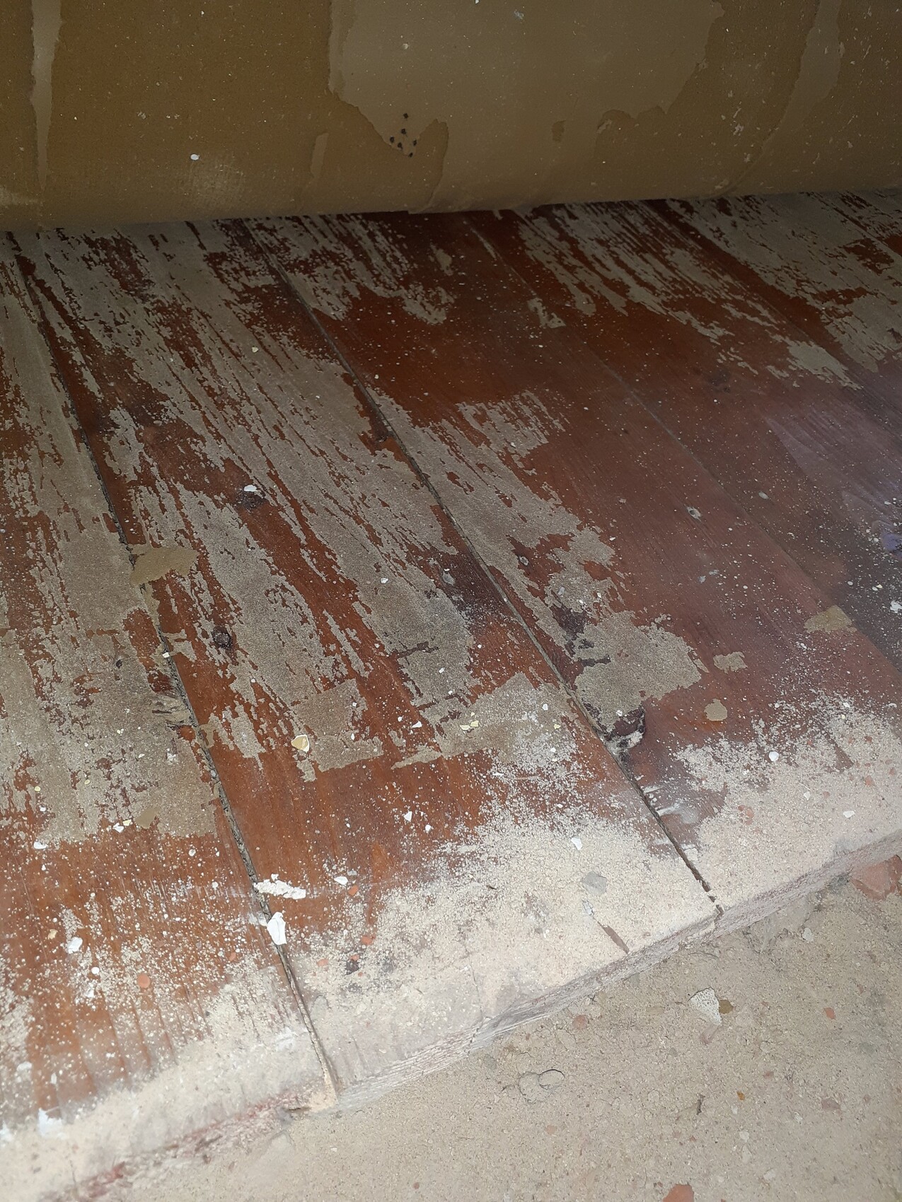

How would you weigh these options, also considering the condition of the floorboards (see pictures)?

From the photos, it appears that the old floorboards are laid on a solid substrate and are not nailed to joists?
If that is the case, the thickness of the boards is not very relevant, as there can be no deflection under load.
And renovating the old floorboards by removing an estimated 3mm (about 1/8 inch) of material would not be very significant.
The wood boards still look to be in excellent condition in the photos.
Therefore, nothing speaks against a full surface renovation of the floorboards!

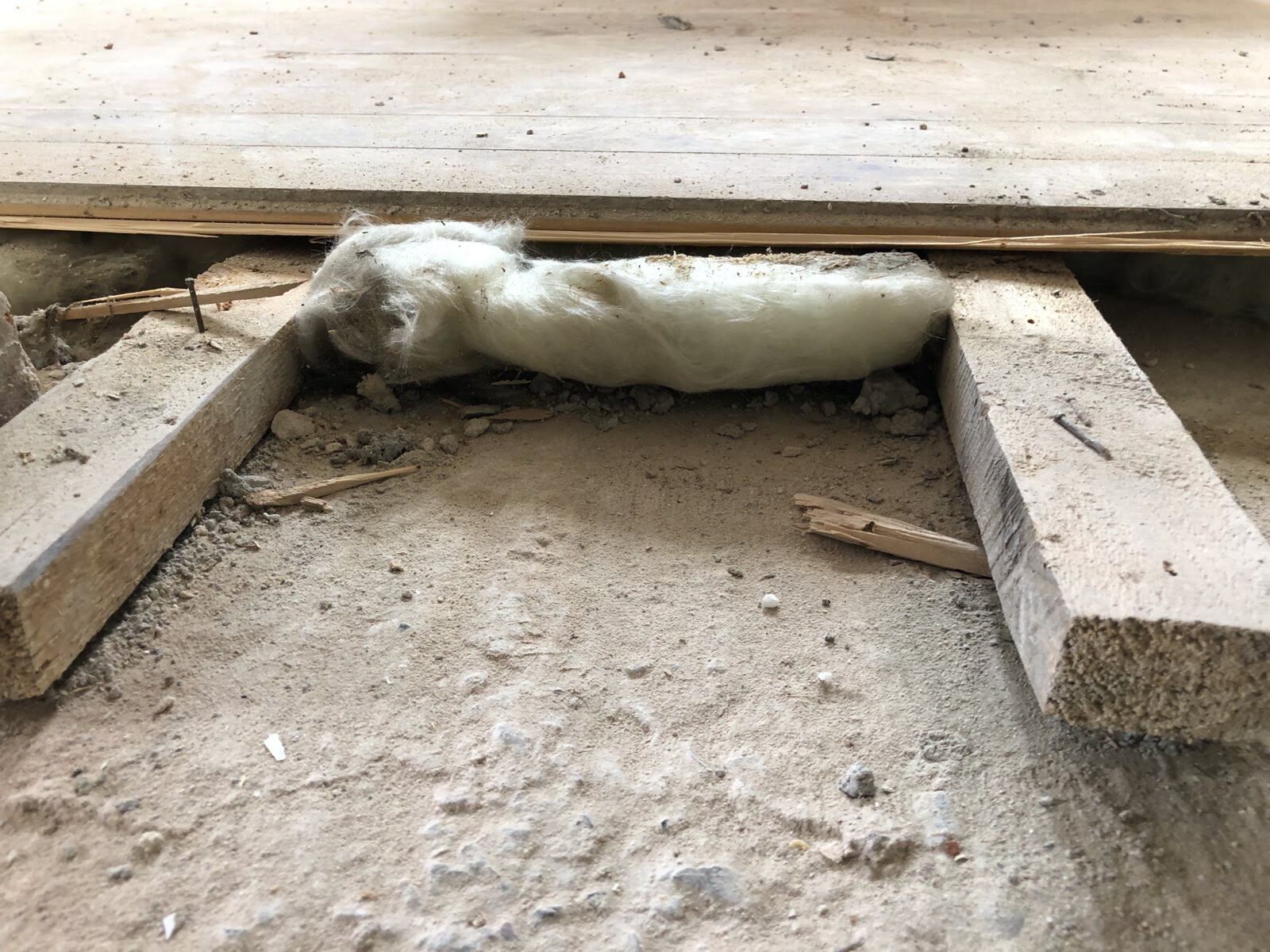

Schorsch_baut20 Jun 2024 15:57I would renovate the floor because it seems there is no insulation underneath.

Yes, there is a cavity beneath the floorboards; they rest on beams about 5cm (2 inches) thick, and underneath there is some kind of insulation wool. I can take some photos of it over the weekend.
