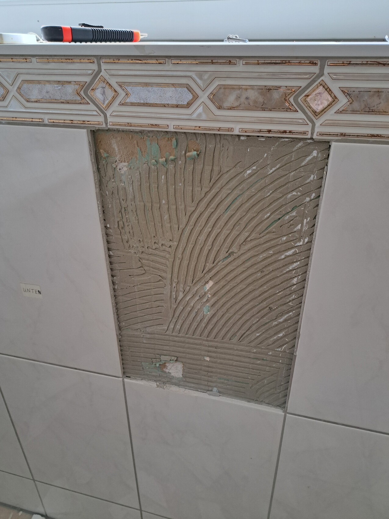

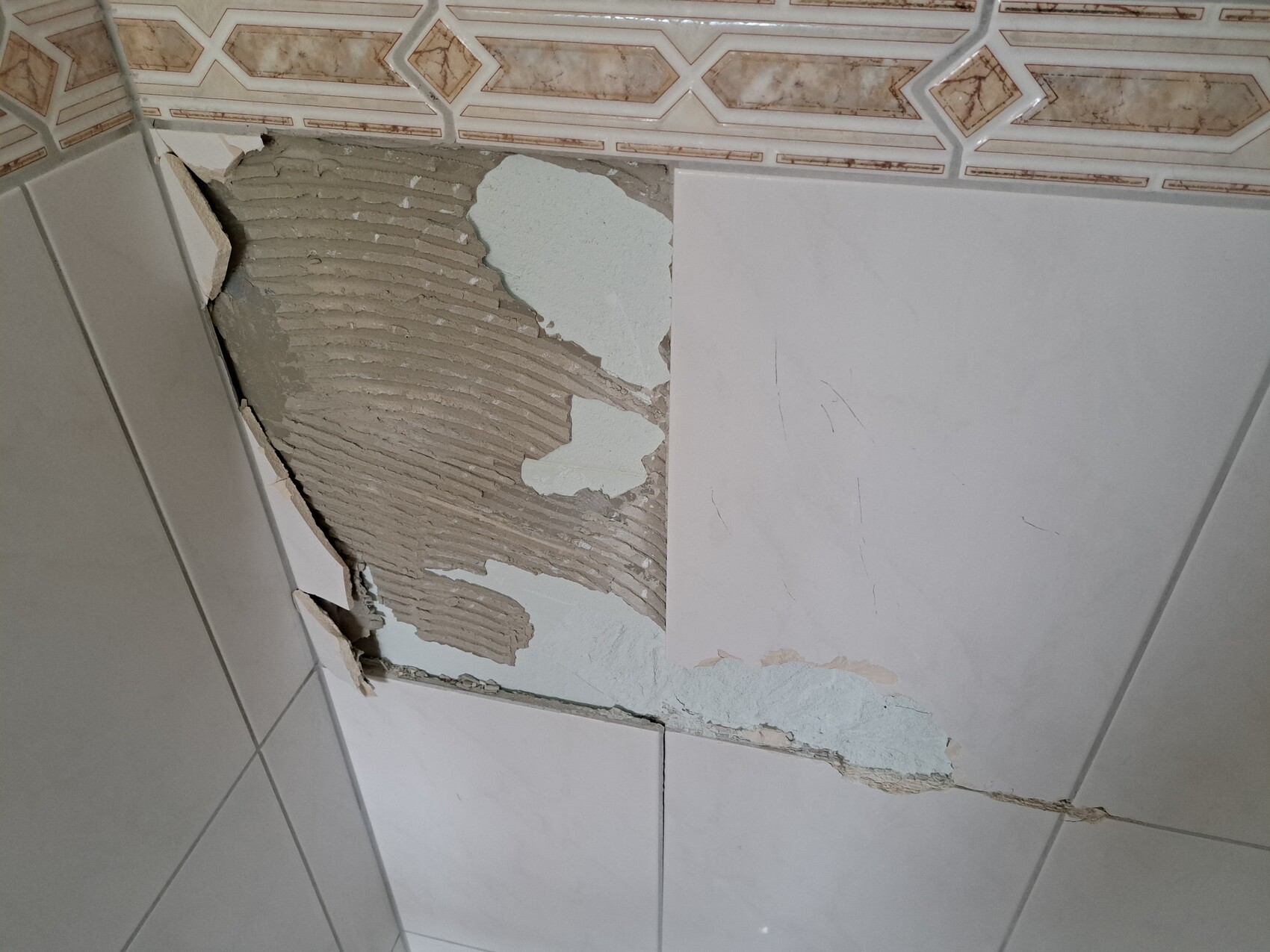

bruno19904 Apr 2024 11:17Hello,
I just tried to remove the tiles from the drywall panels. It doesn’t look too bad; some adhesive is still stuck, but I was able to remove it with a milling tool or fill in any damaged areas with putty.
In the shower area, it’s worse. I found something like gypsum (green), and the demolition hammer really makes holes in it. There must be a concrete wall behind it. Was drywall used here for waterproofing back then?
How can this be repaired? It will be primed and waterproofed again before installing new tiles anyway.
bruno19905 May 2024 16:39In the end, the drywall sheets were completely removed due to holes appearing in many places. New sheets and new tiles were installed afterward.
