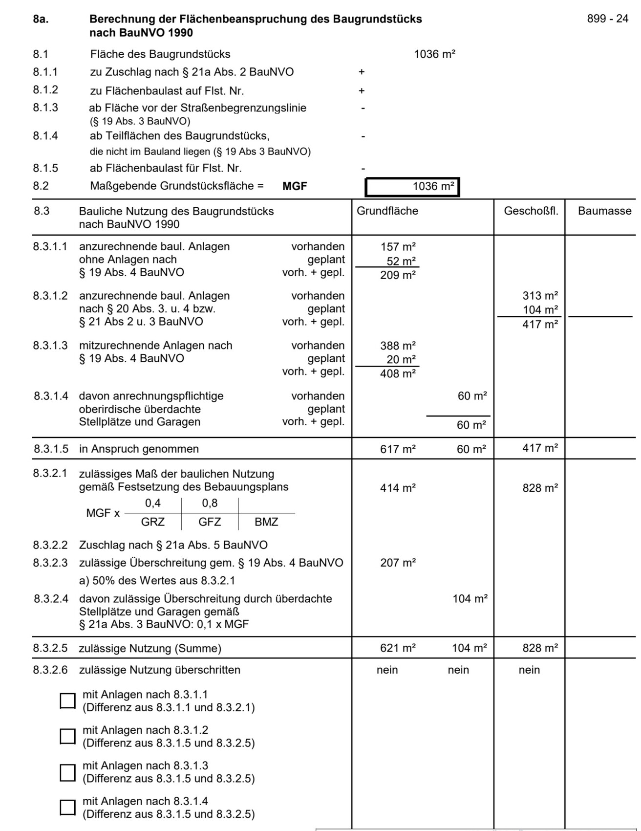

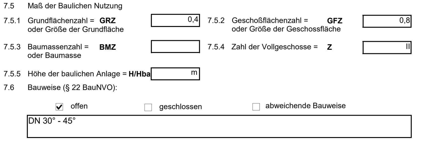

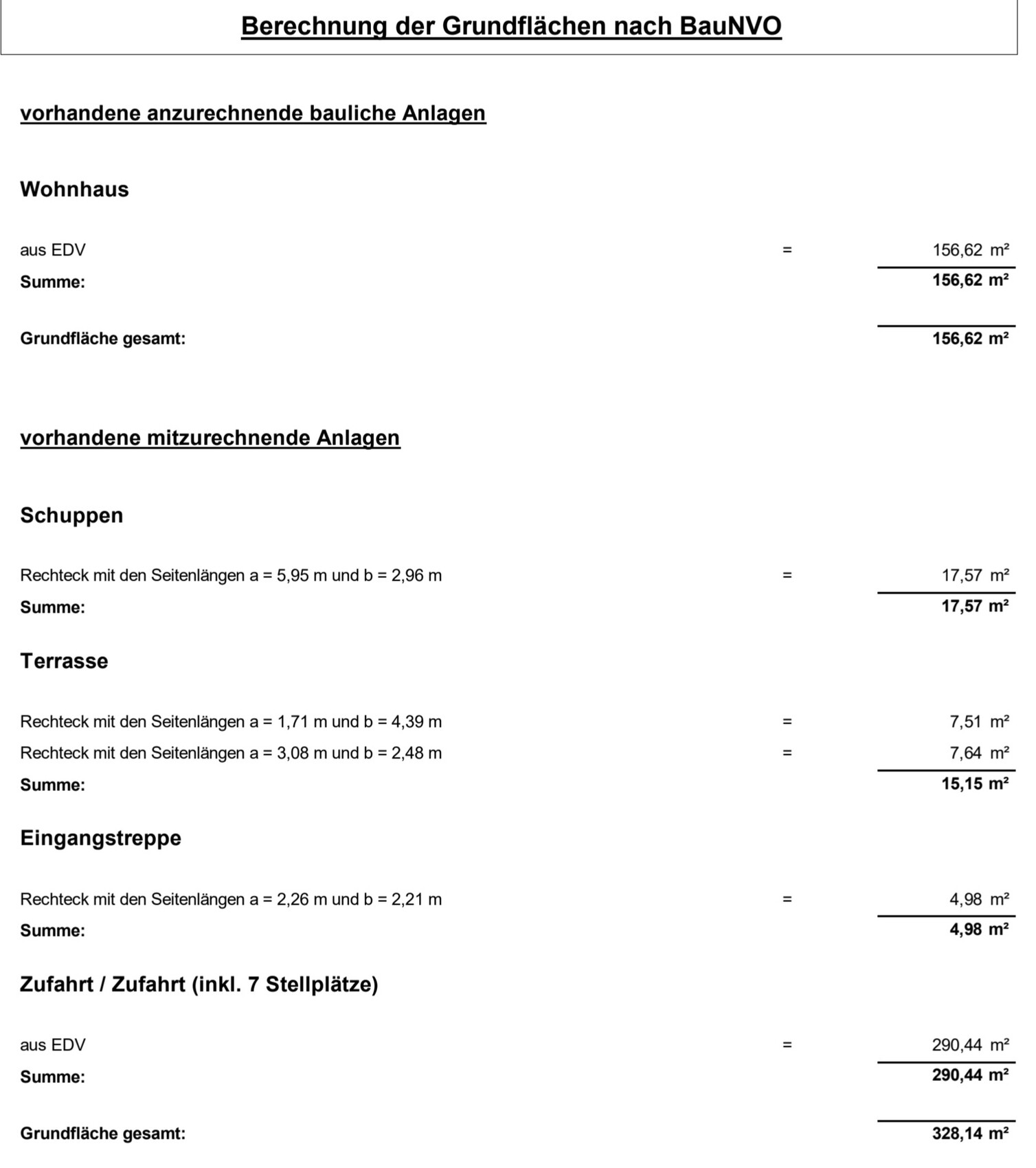

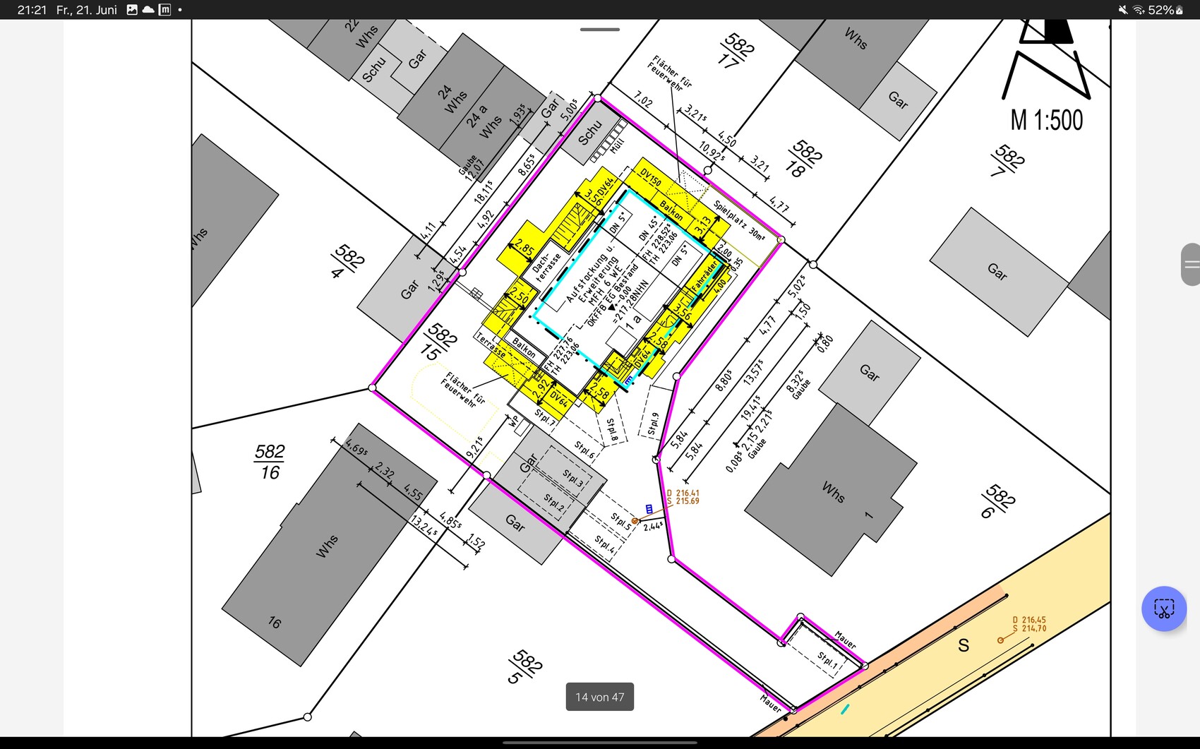

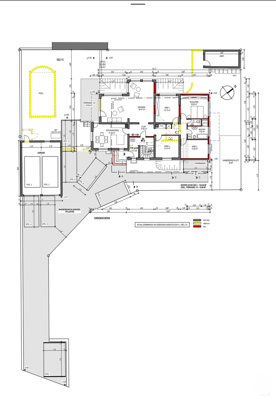

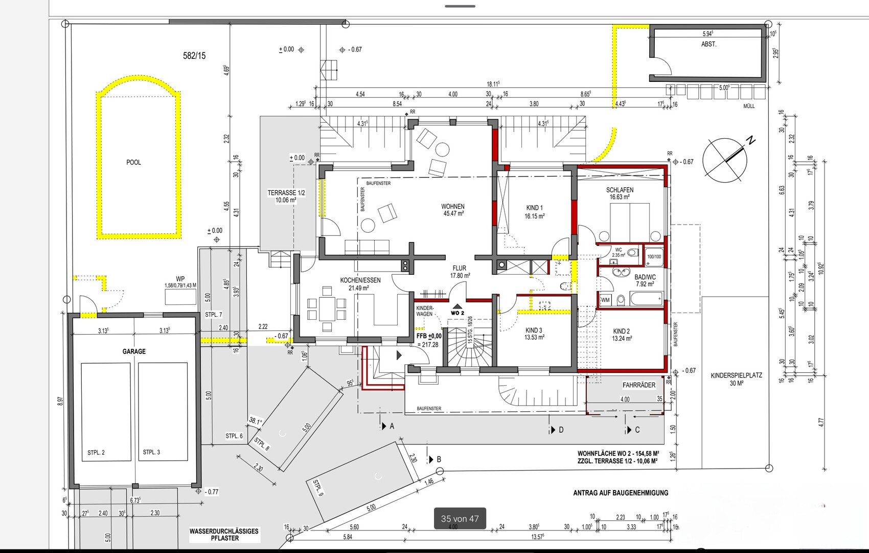

I am renovating my parents’ house in Baden-Württemberg and we have planned to convert it into a 6-unit multi-family building, as the space is no longer needed in old age. We will also add an additional floor and an extension.
Due to the many required parking spaces (1.5 per housing unit), we are currently 4m2 (43 sq ft) below the maximum allowable surface area. The problem is that I would have to demolish our swimming pool (existing structure) because of this. I find this idea terrible (pool replaced by parking space), and the architect is currently overwhelmed or fully booked, so she is no longer putting in the effort she did at the beginning. I hope to find some great ideas here.
A tip in advance: the neighbors are unfortunately not very open to changes. Special exceptions are therefore unlikely... no exceeding of any limits at least.
I thought maybe parking spaces 6 and 7 could get a carport. Is that possible with the required setbacks and the existing garage area?
As I understand it, these two parking spaces would then count as “countable covered above-ground parking spaces” (see picture), which, together with reducing the path width to the bike rack to 1m (3 feet 3 inches), would free up the few square meters required for the pool.
Is all of this feasible? I am very open to additional or new ideas and perspectives.
P.S. If anyone is interested in more details, views, or plans, just let me know.
According to current building regulations, I would never be allowed to rebuild the pool there again, so I really do not want to give it up.

I wonder how parking spaces 2, 3, and 7 can exit if the cars parked in front of them do not move. There seems to be a lack of order and zoning here.

nordanney21 Jun 2024 23:30ypg schrieb:
I wonder how parking spaces 2, 3, and 7 can be exited if the cars in front of them are not moved. There seems to be a lack of order and zoning. Convert the garage into duplex parking if it’s already being extensively renovated. That way, you immediately get four (usable) parking spaces. Otherwise, the rest of the spaces are just drawn in without any real sense, as they are practically unusable.
I’m not in the mood to analyze the submitted documents right now, but who is the target group? Do all apartments look like this? If you say there are six units, is it a six-story building? Apartment 2 is already quite spacious... The rest will be converted into micro-apartments to generate the highest possible returns.
