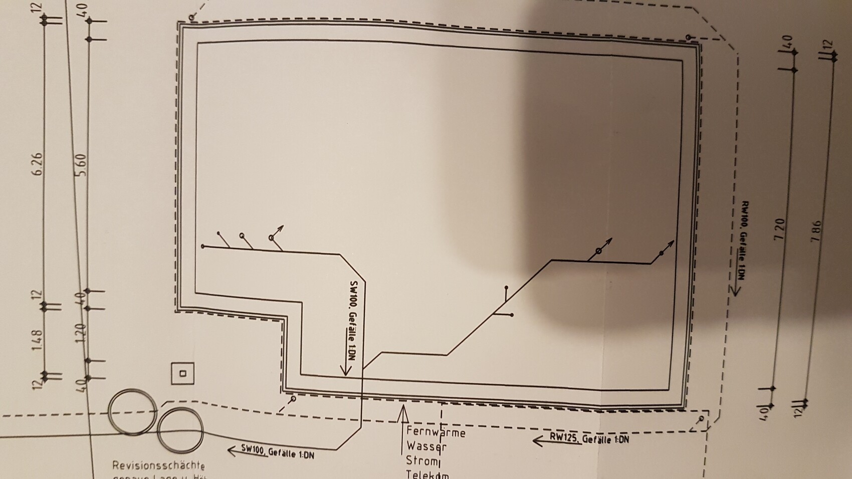

... to me, it seems like a fool’s errand.Could you please explain what you mean by that? Thanks in advance.Well, the support doesn’t just carry its own weight, it’s supposed to transfer loads. It will hardly be able to do that on something that is more or less just a single point. In my opinion, a single pile foundation can only be an inside joke.
I doubt that the slab-on-grade will be continuous. Most likely, the slab is insulated on the outside. The insulation layer would then also define the building envelope boundary. Therefore, I would actually expect the slab (simplified) to correspond to the building’s footprint minus the entrance area. The entrance might, therefore, have to be constructed by the builder on site.
If the support column does not carry any structural loads, it could be placed on a small slab or a pad foundation. It still needs to be clarified exactly what will happen with the wooden beam during construction. Most likely, the house manufacturer will want to know at what height the support column should “end,” as it will probably be attached at the ceiling between the ground floor and first floor.
K1300S schrieb:
Perhaps the foundation around the support is also meant to be sufficiently large. But then it almost reaches the main slab, and installing them individually is a hassle. In my opinion, insulation baskets along the joint are the most suitable option. However, the supplier should have an answer to that—and as you know, I would never consider excluding the slab from the contract, whether for money, kind words, or songs of angels. Interfaces have to align properly, and there has to be ONE responsible party for that.
Sine_bati7 Jan 2021 20:27K1300S schrieb:
Maybe the foundation around the support is also meant to be sufficiently large. As always, one or two pictures (of the plan) would be more helpful than a thousand words. 😉Attached is the image showing how the foundation is planned. I believe everything should be structurally sound. ;-)
Here we have different options to design the entrance and the stairs.
