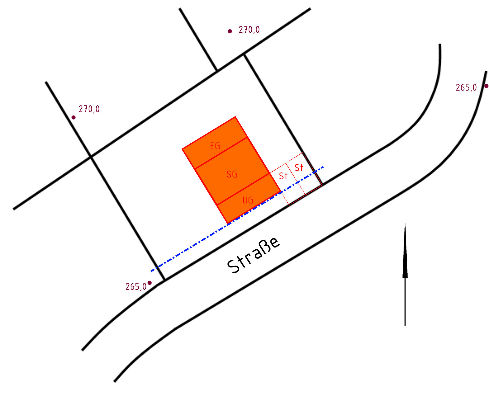

SimonHolzwarth schrieb:
slight slope
The term "slight" is very subjective. For me, living in the lowlands of the Lower Rhine region, this would be considered a moderate to steep slope. As an engineer, I need concrete figures:
Orange-colored building structure (ground floor/basement/lower basement) at the roadside, blue dashed line, heights 265/270
The elevation data urgently needs to be detailed, especially because the embankment shown in the development plan is not dimensioned. It is also essential to obtain the finished road elevations.
