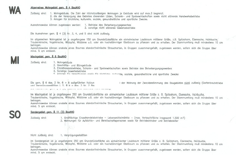

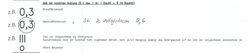

A part of the legend in the zoning plan was still missing
Building use form sheet with example value 0.3 for floor area ratio.
11ant23 Mar 2025 14:58
57Christian schrieb:
The development plan specifies WA + I + o
This means "general residential area," "single-storey," and "open building structure" (i.e., no continuous perimeter block development). Here, I would expect a more detailed definition of single-storey, including terms like TH T and TH B (eaves height valley and eaves height hill), to regulate houses situated below or above the street differently.
