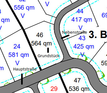

I am currently working on the planning. I have a plot of land that borders both a main road and a side street. Where would you place your driveway? The side street will only be built next year, so I would have to create a temporary driveway on the main road for now. If the driveway is built on the main road, I can start construction immediately.
What would you choose?

Are you even allowed to access the property via the secondary road?
How much traffic is there on the main road?
What is the speed limit on the main road?

haydee schrieb:
Are you actually allowed to access the property via the side road?
- Yes
- When I did test drives, I never met any vehicles coming the other way or following behind me.
- Walking speed
Hope this clarifies things a bit more.
haydee
29 Jun 2020 14:24
In that case, I wouldn’t wait. If it’s like here with 50 km/h (30 mph), 9,000 vehicles per week, mostly Monday to Friday, I wouldn’t access the main road because of the curve. Plan a door to the side street so children can exit there if needed.

Walking speed on a main road?
Is the plan oriented to north?
If yes, then south is at the bottom.
Access from the side street would therefore block the south-facing garden.

haydee schrieb:
Plan a door to the side street so the children can go outside if needed.
-Good tip, thank you.
-Main road meaning the primary residential street within a new development. The side street is a dead-end road. I should have just included the full layout to make it clearer, sorry.
Access from the side street would block the south-facing garden.
-Exactly, south is at the bottom. I would position my garage to the north, with the driveway also from that side, so the south garden would remain intact.
