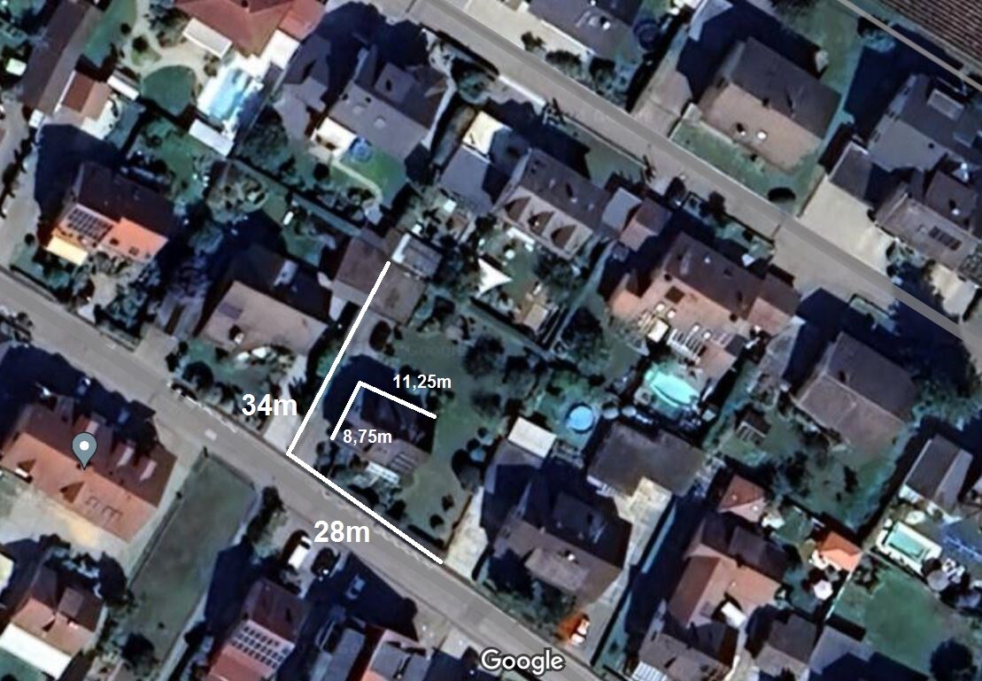

If it is a 34 zoning area according to the building code, then what matters is how the surrounding area is developed. So the lot coverage of a property and also virtual building lines apply. If you plan a design with zigzag shapes like that, it is also useful to provide measurements to check whether the lot is even suitable for building so that you can comfortably fit a small, adequate house with some garden space.
Please take measurements and share a Google Maps screenshot showing the neighboring buildings.

Here is a Google Maps screenshot. I hope the area shown is large enough:
Satellite image of a residential area with marked lot; side lengths 34 m and 28 m (112 ft and 92 ft).

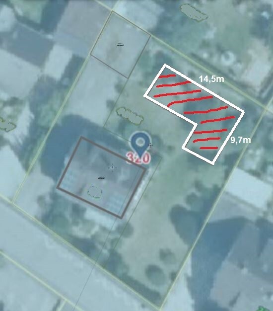

Furthermore, here is the rough idea regarding the outline and placement of a potential house:
Satellite image: on the right an L-shape with red hatching; dimensions 14.5 m x 9.7 m (48 ft x 32 ft).

That's a crazy idea. You also have to provide parking spaces, and then you're dealing with surface sealing—almost complete sealing, even with the dense development in the area. The other house would basically have no garden and only a terrace right in front of your nose. Have you checked if there is a development plan / building permit for the area?

Zone 34 does not allow for hinterland development in your area. This is likely to be a limiting factor as well.

I just realized now that you cannot have a garage extending along three additional property boundaries. There is a 9 or 12 meter (approximately 30 or 40 feet) rule in almost every regional building code.
The driveway on the right is about 9 meters (30 feet) wide and cannot really be used as part of the property.

Is that so? It seems to me that the neighbor to the right also has development behind the building (a flat-roof bungalow).
nordanney
2 Jul 2024 07:53
Is that so? It seems to me that the neighbor also has a backland development with planning permission (flat-roof bungalow).
I would have considered that a shed.

I’m only seeing now: You cannot extend a garage along three additional property boundaries. There is a 9-meter (30 feet) or 12-meter (40 feet) rule in almost every state building code for this.
The “driveway” on the right is about 9 meters (30 feet) wide and can’t really be used as part of the plot.
Is that correct? It seems to me that the neighbor to the right also has a backyard building (flat-roof bungalow).
That is just a shed and not living space.
