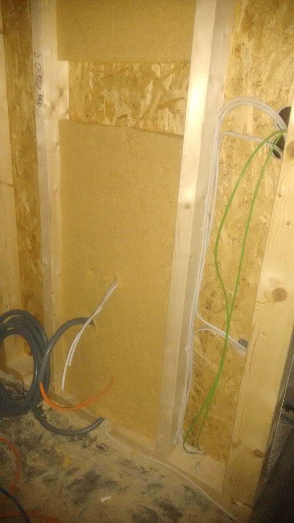

We secured the cables using cable clips and perforated metal straps, leaving large loops (the loops appear open in the pictures). These were then pulled through the insulation. The wood fiber insulation used is so soft that you can pull it apart by hand. On the floor, we marked where the cables are located. Then the walls were closed up with OSB and drywall, and only afterward were the holes drilled. For the back box installation, the insulation was carefully removed.

stefanc8423 Sep 2017 17:31Hm, okay, the mounting is definitely a valid point, yes.
Thanks for the photos!
I had also considered using a hole saw but wasn’t sure if it would work well with the soft material. And there’s definitely a big risk of hitting a cable with the saw. Then I just hope that manually pulling it apart really works.
