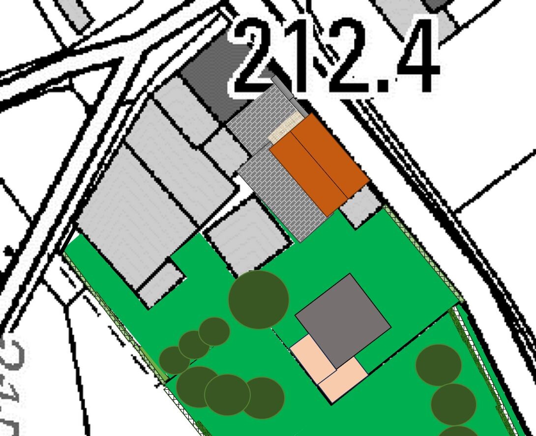

Site plan (oriented north), see attached.

At least your yard property falls under §34 and not §35, so the house does not have to be a farm worker’s apartment nor limited to existing old foundations. However, the site plan section suggests that demolishing buildings on your property might change the boundary between built-up and non-built-up areas. So, for the house at a specific desired location, you should submit a preliminary building inquiry both with and without demolition. I would also choose the site considering that the house remains accessible via public roads even after a possible subdivision of the property.

The question that comes to mind: are the barns still in use, and if so, how? You mark one that would need to be demolished, but what about the others?
Because I would basically want a house on a plot that could function independently without the yard, if necessary.
The bank financing usually requires that the property ownership and the builder be the same person. So, to my knowledge, the property must be subdivided.

K a t j a schrieb:
Yes, it’s terrible! Nobody wants to live between such a massive cluster of buildings and walls. It really needs a breakthrough, I think.
I find the idea of demolishing the central barn and placing the house there quite good. Maybe also remove the outbuilding and the garden shed. That would probably allow a separate driveway. It depends on how busy the road is. If it’s more like a motorway, the buildings might still serve well as a noise barrier.
If money were no object, I would tear down all barns and the chicken coop and build along the left side road.
The road is a district road leading into the village, so it is regularly trafficked, and noise protection is exactly why we would like to keep the building.
Unfortunately, money does matter, so I have been pondering for a long time about how to develop the property sensibly in the long term. It would probably be easier to demolish buildings if it were currently unoccupied...
majo5254 schrieb:
The road located on the eastern side of the plot is a ring road, so access should generally be possible.And to the northwest, is that also a road? I would try to ensure that, if necessary, the two plots could be merged. That is also how I would plan the construction. Preserving a barn is never a bad idea, as it can replace an expensive carport or provide additional storage space.Is there an aerial photo available?
I would try to ensure that it is possible to divide the property into two if needed. That’s how I would plan the build.
Keeping a barn is never a bad idea. It can replace an expensive carport or provide extra storage options.

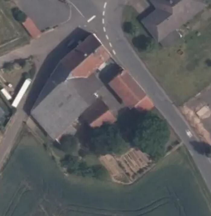

Is there an aerial photo? To the northwest, there is a paved access road leading to agricultural land/fields. Traffic is significantly lower there, only the occasional tractor.
We will definitely consider the possibility of dividing the property in the planning phase. You never know what the future holds.
Attached are a) an aerial photo and b) an idea of how the house could be positioned. The terrace would face south (boundary development), and part of the agricultural land could be used as a garden replacement. If division of the property becomes necessary, access could still be arranged from the district road to the east.
With this positioning, we would initially be as far away from the farmyard as possible and could gradually demolish existing buildings as more space is needed.
K a t j a schrieb:
Could it be that the outbuilding suddenly almost doubled in size? And why is the new house now placed in the garden? I thought it would be difficult to get a building permit / planning permission there, and connections would also be more complicated.The outbuilding only appears doubled from an aerial perspective. The building has a large roof overhang extending into the courtyard. The building itself is the same size as shown on the original site plan.
The positioning in the garden is to potentially make a plot subdivision easier to implement. This is just a suggestion for discussion.
Regarding approval, I still need to clarify the exact boundary between the inner and outer development zones to see if it runs within the property.
majo5254 schrieb:
A suggestion for discussion.Unfortunately, I don’t have a clear idea of how you plan to provide access. Could you include paths and driveways in the drawing?Similar topics
