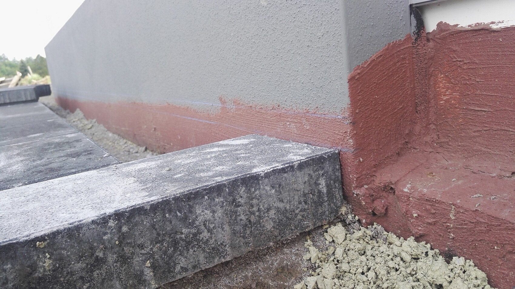

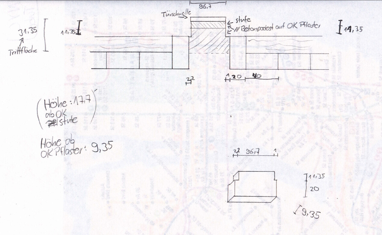

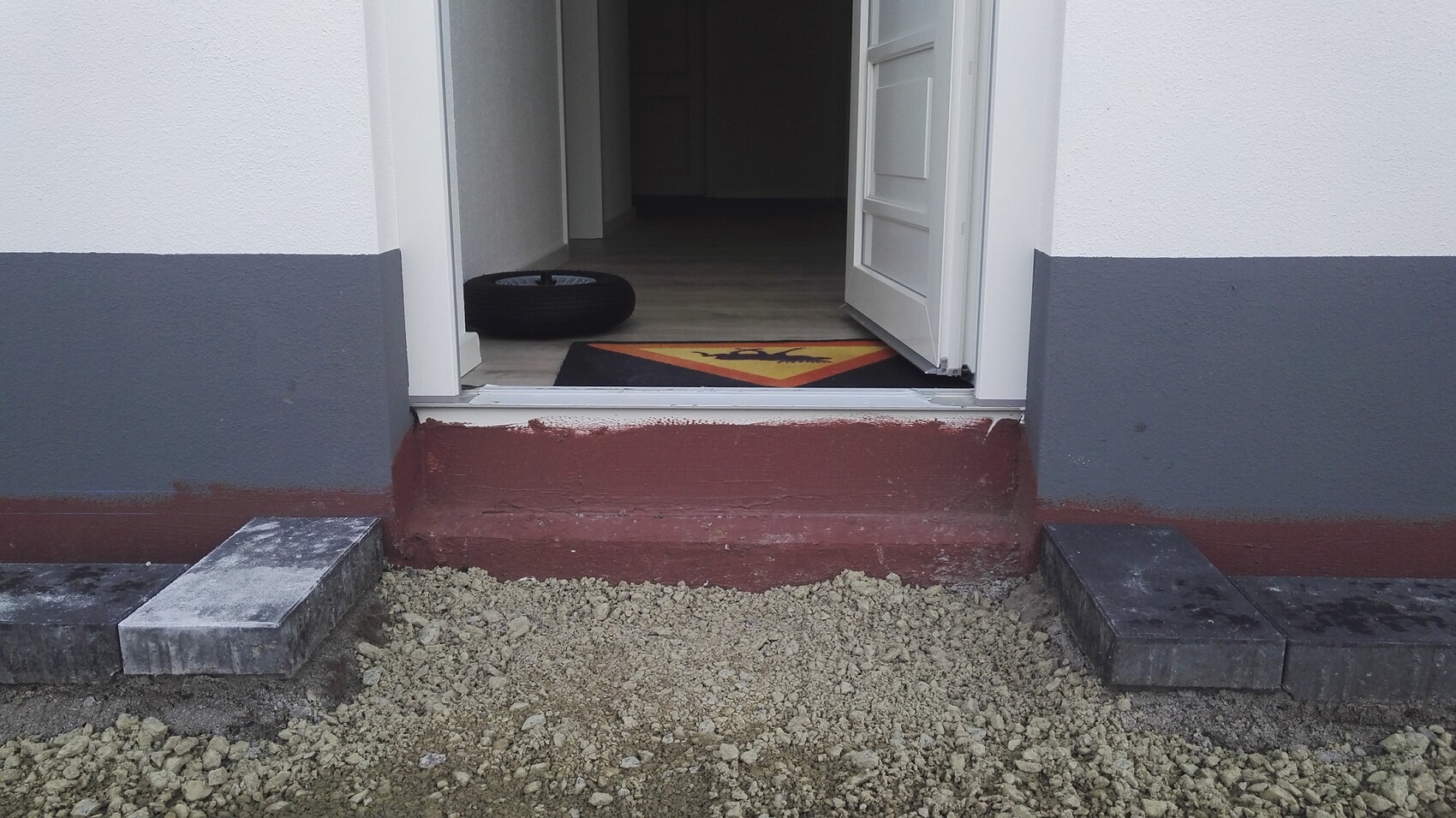

Here is a sketch of the situation, as well as a photo of the current condition.
I would fill with concrete up to the height of the top edge of the paving. This would make the small red step "disappear" for the time being.
On this first concrete base, I could then either form a second base, which would be covered with tiles, or set one or two block steps.
Although there are unfortunately no responses, I want to at least provide the following information.
Currently, there are two options to choose from:
1)
- For the two stones standing perpendicular to the house wall, set the formwork at half their height (= 20cm (8 inches)) and concrete up to the top edge of the paving. This will also cover the red step in the door jamb, resulting in a level, T-shaped concrete surface (see the shape in the previously posted sketch, bottom right).
- A special concrete block step in this shape does not exist, nor can it be cut, because the inside (since it is cast concrete) does not look good.
- A block step made of granite in graphite color costs around 80€ locally, with custom cutting costing 70€.
- The step is probably quite heavy; it might be best to lay the paving and concrete first, then transport the step over the paving using a dolly or roller cart, and finally lift it into place with four people using the four-corner method for the last 10cm (4 inches).
2)
- Pour concrete as in option 1), plus an additional T-shaped build-up (according to the sketch) also cast in one pour with formwork (possibly 2cm (1 inch) shorter on all sides).
- Ceramic floor coverings/terrace slabs from the catalog will then be glued onto this base (one top piece, one front, two sides; the top piece would overhang all sides by 2cm (1 inch) to act as a drip edge).
- Significantly cheaper, at more than 30€/m² (more than 30$/sq ft).
I think option 1) looks best and is more durable; option 2) might be easier to implement.
I don’t know any other advantages or disadvantages (no one is saying anything).
1)
2)
