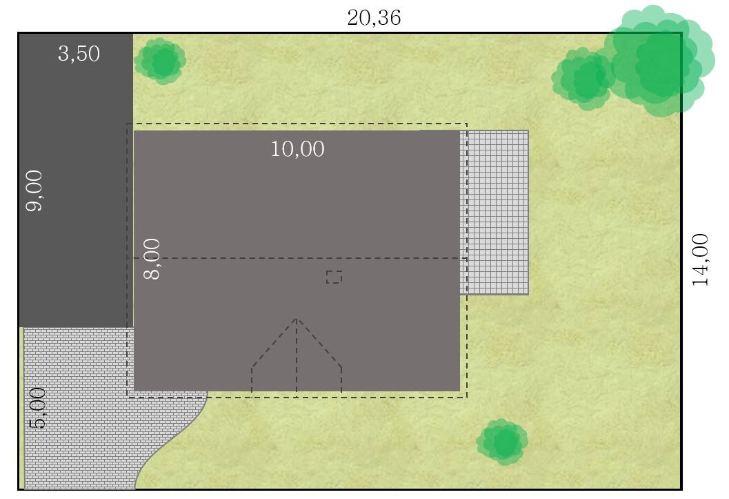

Yes, that works: you can do it exactly like that without any concerns!
See the sketch:
Site plan of a house with garden, terrace, driveway, and trees
