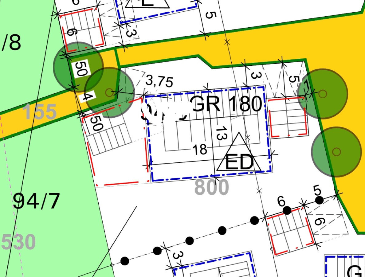

Zoning Plan / Restrictions
Plot size 800 sqm (8,611 sq ft)
Single-story ground level, building area 180 sqm (1,938 sq ft), 18x13 m (59x43 ft) building field, 25° roof pitch, gable roof
Style: modern, 2 full floors with open roof concept, no basement, 2 bay windows that become roof terraces above, high ceiling heights (at least 2.70 m (8 ft 10 in) on the lower floor, open upstairs with up to 6 m (20 ft) wall height, 9 m (30 ft) ridge height possible), total living area approx. 210 sqm (2,260 sq ft).

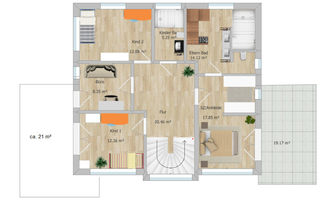

Children's rooms possibly too small at 12-13 sqm (130-140 sq ft). However, planning includes potentially adding a gallery in 10 years once the kids are old enough, which could create additional space. The gallery could then be used as a play or sleeping area. Considering possibly extending the house by 1 m (3 ft) and reducing the size of the bay windows; this would provide more room for the children if necessary. Alternatively, the upstairs hallway could be reduced? Personally, 10 sqm (108 sq ft) was more than enough space for me back then.

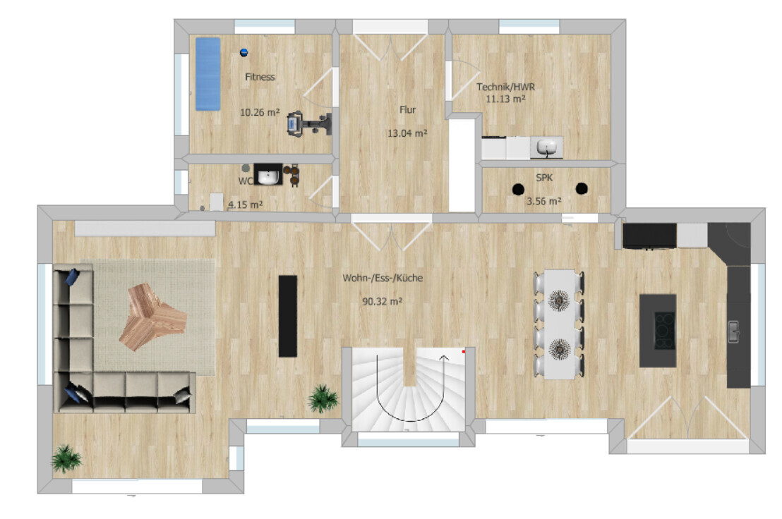

Myrna_Loy11 Apr 2021 00:176 m (20 ft) wall height in a 3 m (10 ft) wide hallway??? And the chimney right in the middle, unobstructed? Unfortunately, very little fits together here.
Thanks for the comments, we will take them to heart and discuss them with an architect. The children's rooms will be slightly larger, and the utility room a bit bigger. We will find a solution for that.
The west-facing balcony can also be accessed from the office. We don’t see that as a problem.
Having the staircase accessible only through the living room also has its advantages. You know who comes and goes and when. :P We also saw it more as a visual highlight.
We are planning to install an air-to-water heat pump. Does the system really require so much space that it could become too tight for the washer and dryer?
The fireplace is planned as a decorative element (ethanol or similar), so no chimney is needed.
The 6m (20 feet) ceiling height is of course the total. We plan 2.6–2.8m (8.5–9.2 feet) ceiling height downstairs, then the ceiling, and upstairs 2.6m (8.5 feet) up to the slope, reaching 4.0–4.5m (13–15 feet) at the ridge. It is still undecided whether there will be an attic after all. Visually, we have seen several open designs (of course partly with open and partly lowered ceilings, like for example in the bathroom) that we quite liked.

Maxwell8 schrieb:
What don’t you like? For me, it’s the distraction instead of continuing the thread https://www.hausbau-forum.de/threads/efh-mit-elw-anregungen-fuer-neulinge.38307/ there :-(
Let a professional handle it.
Bowling in the open-plan living area
Slalom in the building services
Where should the freezer go?
Children’s room smaller than the hallway
Children’s area smaller than the parents’ area
The proportions are off. Sometimes space is wasted, and then it’s lacking where it’s needed.
Who uses balconies when there is a garden downstairs with direct access to cold drinks and coffee?
