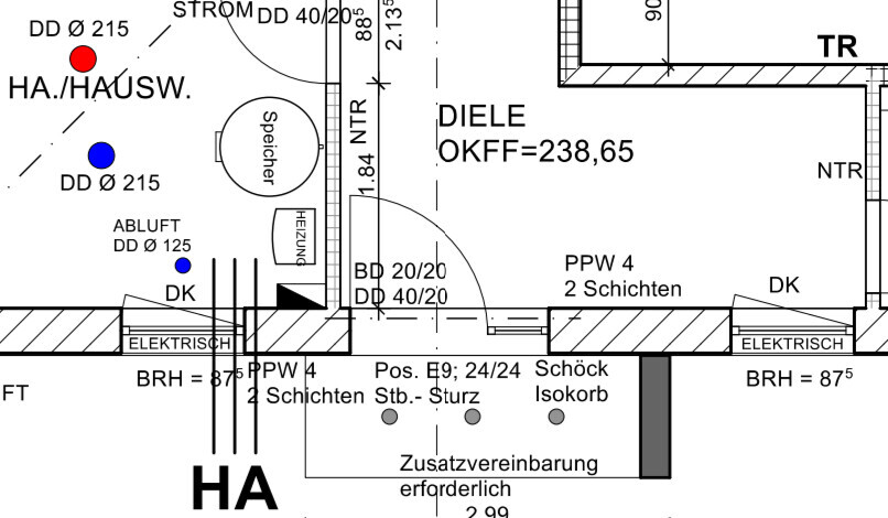

Shiny86
15 Oct 2020 12:14
Sorry, I forgot to attach it...
Here it is
Floor plan of a house with hallway, doors, thermal break, and electrical installations.
K1300S15 Oct 2020 12:23
I had already guessed that. How high is the roof, and what type of spotlights are you considering (with what beam angle)? I could imagine that two might be enough, but it depends. Three, however, with a more focused beam, could also be interesting. The black beam on the right is a wall, correct?
Shiny86
15 Oct 2020 12:41
I have no idea about spotlights. Are there any suitable ones for the porch roof? Ideally, they should be replaceable in case of a defect. Exactly, there is a wall on the right. It’s an inverted L-shaped porch roof. The roof height isn’t specified anywhere. I would probably have to measure it on the elevation plan. How would you position the three spotlights? Does it work as shown, or is the distance to the sides too large and the three spotlights too close to each other?
