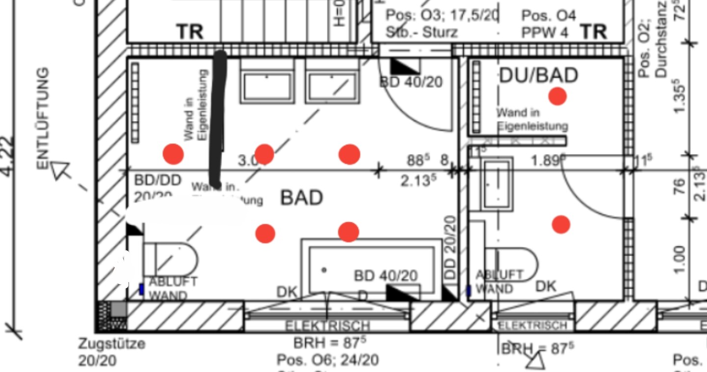

I think it would make sense to use spotlights as the main lighting in the bathrooms upstairs.
Does it make sense like in the picture?
Of course, I’ll need to add dimensions in the next step. But for now, it’s just an idea...
Additionally, I would install illuminated mirrors in both bathrooms.
How far should spotlights be placed from the wall above the washbasin to avoid casting shadows?
If you are going for illuminated mirrors anyway, they would eliminate the shadows. However, I would generally suggest distributing the spotlights more evenly, not clustered so tightly in the middle of the large bathroom. For the sake of symmetry, perhaps five instead of six would be better.
In our similarly sized bathroom, we also have six spotlights that provide a nicely even light, either soft or "dazzlingly bright" (as mentioned here before). I like it.
