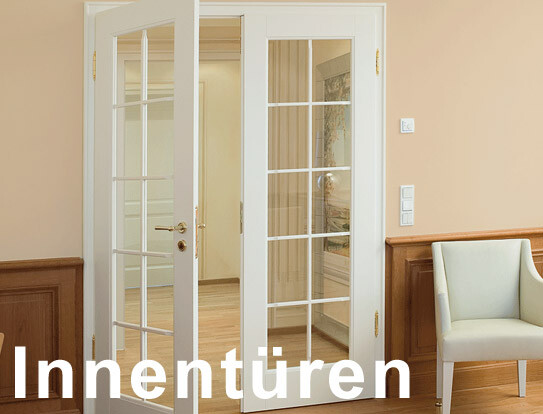

Alex85 schrieb:
On the ground floor, there is an airflow of 40m³/h (about 24 CFM) overflowing from the living room towards the bathroom and utility room. What kind of door is that with the glass panel? With actual glass doors, you have to be careful—they usually hang closer to the floor than a standard door, which can make airflow challenging (causing drafts and pressure differences).
The door will be similar to the one in the attachment. The planned placement also seems a bit odd to me. There is exhaust air in the ground floor bathroom and utility room, with the hallway in between having neither supply nor exhaust air. To me, it would make more sense to add supply air to the hallway. Or am I wrong?
