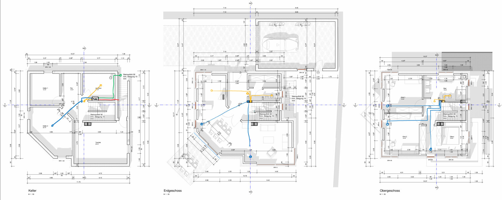

Hello, I’m Matthias,
I am currently in the final stages of planning (hopefully soon submitting the building permit).
I want to build to the KfW55 standard, which requires a controlled residential ventilation system. But primarily for comfort reasons!
At first, I quickly considered Helios, then Zehnder... shortly after that Komfovent. And so it went on from brand to brand. Since this is a major cost factor, I want to do everything right and take some more time to consider your experiences as well.
What is the best way to proceed? How do I decide on a manufacturer? Where should I start?
Which criteria should I consider besides the following?:
- Operating noise (I am very sensitive)
- KNX integration
- Intelligent, room- and demand-based control (VOC & humidity)
- Cooling/air dehumidification in summer (via earth tubes around the house/basement + heat exchanger in the supply air)
- Good accessibility for cleaning
//Key data\\
160m² (1722 ft²)
2.5 floors
3 bedrooms + 1 bathroom + 1 toilet
Open plan living-dining-kitchen area
Basement
Underfloor heating (gas)
That’s a lot of questions... I didn’t want to scatter this piece by piece. Any constructive advice is welcome.

Tolentino schrieb:
It’s true that photovoltaic systems can be installed later, but controlled residential ventilation is either not really feasible later or significantly more expensive. However, photovoltaic systems offer a much greater benefit (not to mention the environmental advantages) compared to controlled residential ventilation.
But we’re going in circles. There are fans of controlled residential ventilation and those who don’t necessarily consider it essential. We can agree on that.
I’m naturally happy about the active participation here. Many thanks in advance.
Now to the comments:
1) In the "Technical Minimum Requirements" for KfW55, a controlled residential ventilation system is required if choosing gas condensing technology. I’m not yet convinced about heat pumps and I’m sensitive to noise. Although modern heat pumps are quite quiet, they are not silent. Since we’re already making a side note about heating systems: I could only consider a heat pump with an ice storage system. Unfortunately, that is very expensive. And when it comes to heating, it’s still possible to switch after several years.
2) My installer really wants to sell me a Viessmann controlled residential ventilation system. However, I’m not convinced by Viessmann. Besides Viessmann, they also offer Pluggit and Helios. But I don’t want to base this decision on the installer’s affiliate contract. I want to choose the controlled ventilation manufacturer based on my own requirements and then, if necessary, find the right installer accordingly.
3) The tip about "Erlus" was great. I didn’t know it yet. I really like the idea of using the "chimney" as a supply and exhaust air riser. I’m going to look into that more closely.
Does anyone have any other tips?
