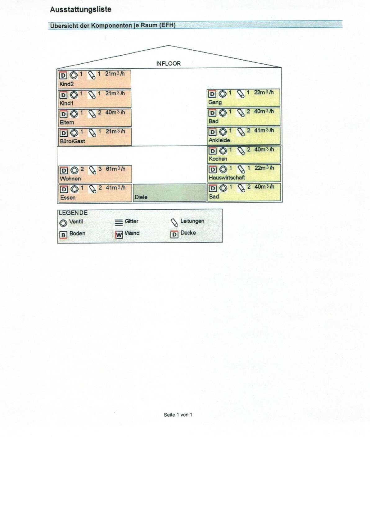

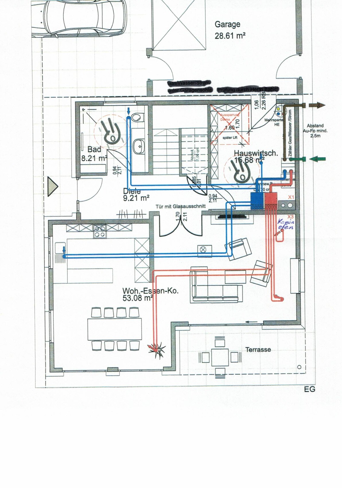

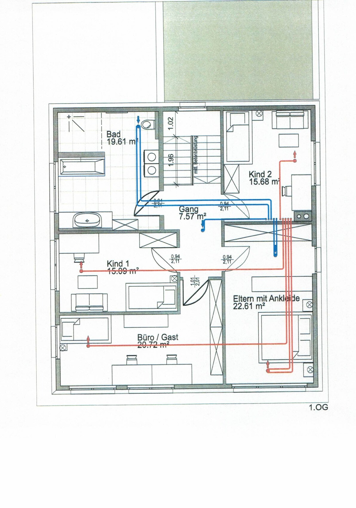

Hello.
We have received the plans for our mechanical ventilation with heat recovery system. In our two full-story single-family house with a flat roof, a Zehnder Comfoair Q350 TR with an enthalpy exchanger will be installed.
I would be interested in your opinion on the planning.
Peter
Ground floor plan: garage, bathroom, hallway, utility room, living/dining, terrace
Floor plan of a house with bathroom, two children's rooms, master bedroom with walk-in closet, office.
Schematic floor plan of a single-family home with color-coded rooms and legend.

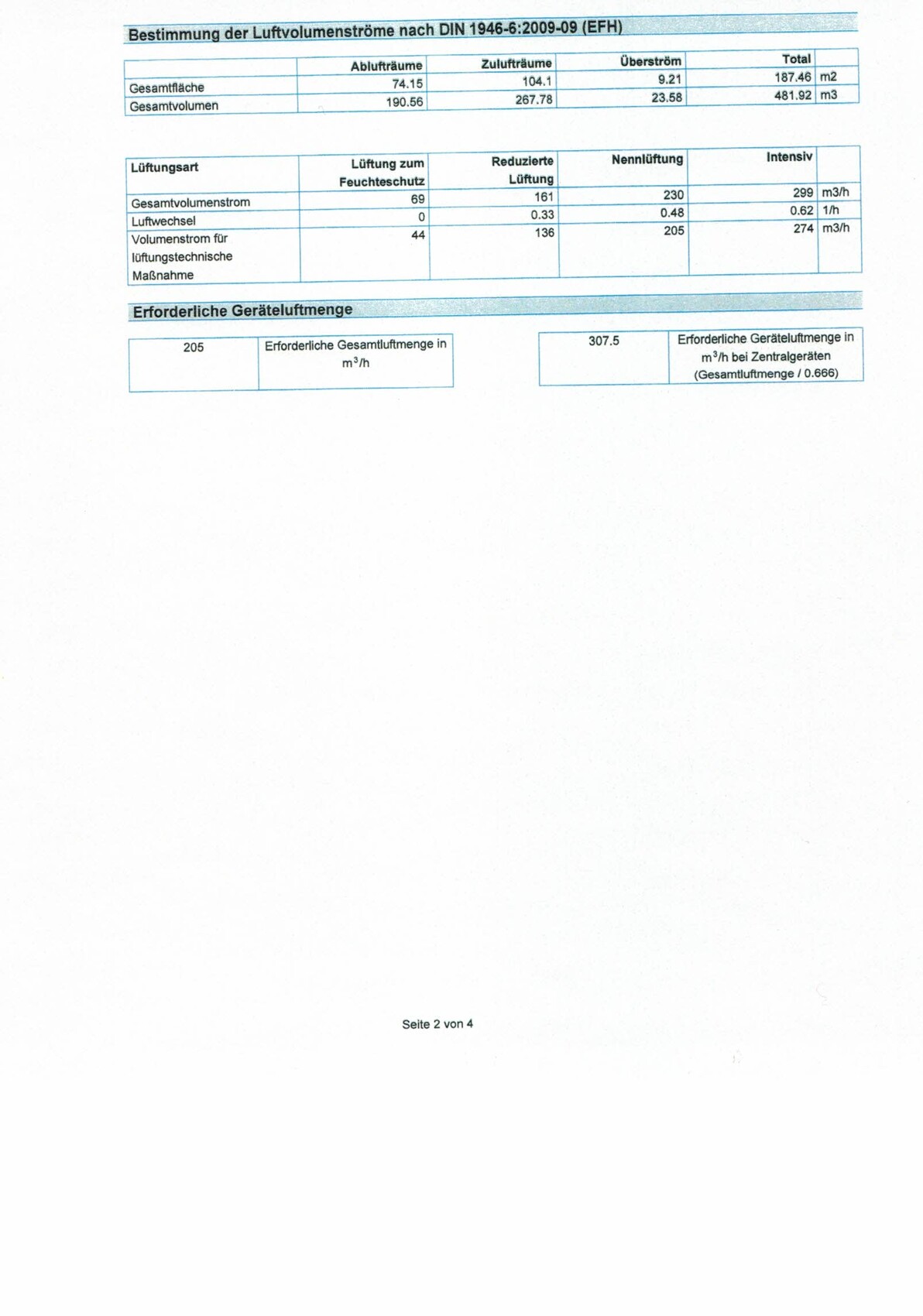

DIN table with air volume flows: exhaust air, supply air, transfer air, and total amounts.

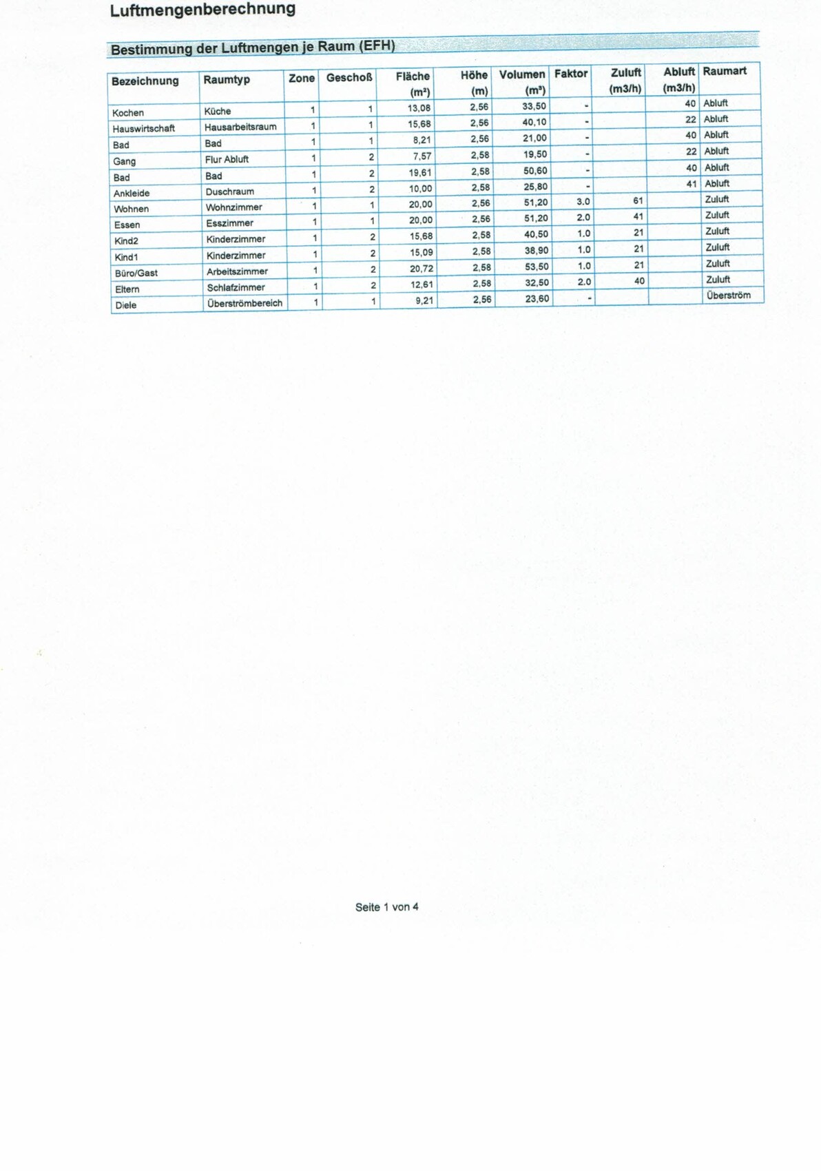

Table of air volume calculations per room (single-family house) with labels such as kitchen, bathroom, living.

As mentioned, the model’s dimensions have not been finalized yet. The contract only states "Zehnder, Paul or equivalent." Since I assume that for around 250m² (2,700 sq ft) of living space, at least >300 m³ (10,600 cu ft) is needed, I wrote Q350-QXXX. I can get back to you once I have more information.
What would be more interesting now is to know what is included in the price at Bookstar.
Bookstar
28 Oct 2018 22:11
We have Q350. Sufficient for a thickness of 200m2 (2153 ft2).
