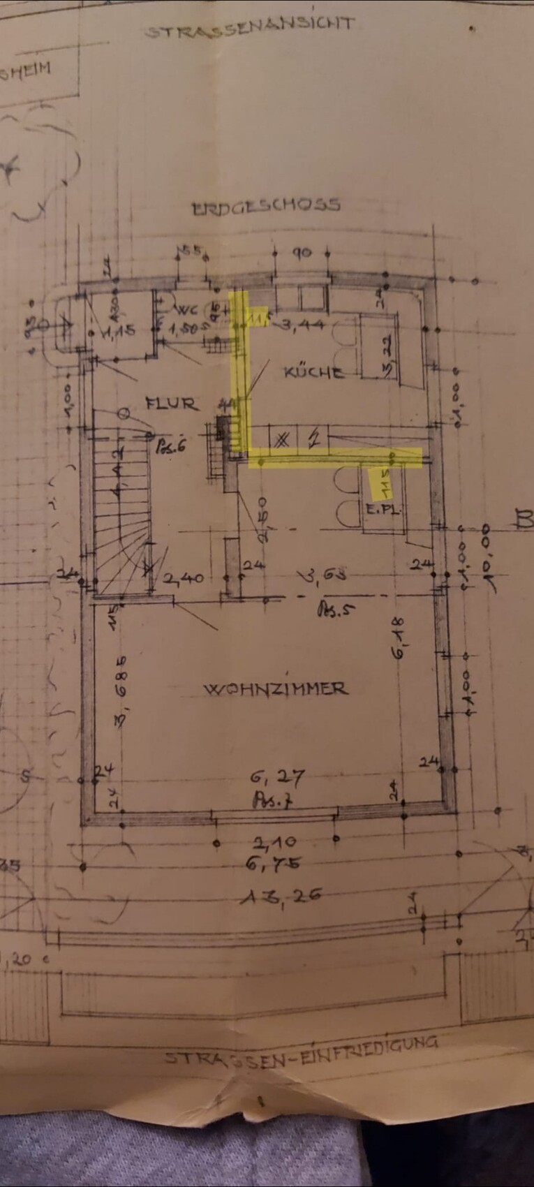

Good evening everyone,
We are considering removing the wall between our kitchen and living room to create an open-plan kitchen.
Now the question is whether the wall that would need to be removed is load-bearing. According to the plans, the wall thickness is 11.5 cm (4.5 inches).

On the ground floor, there are exactly two walls with this 11.5 cm thickness.
Is it possible to determine from the plans whether the wall between the kitchen and living room is load-bearing?
