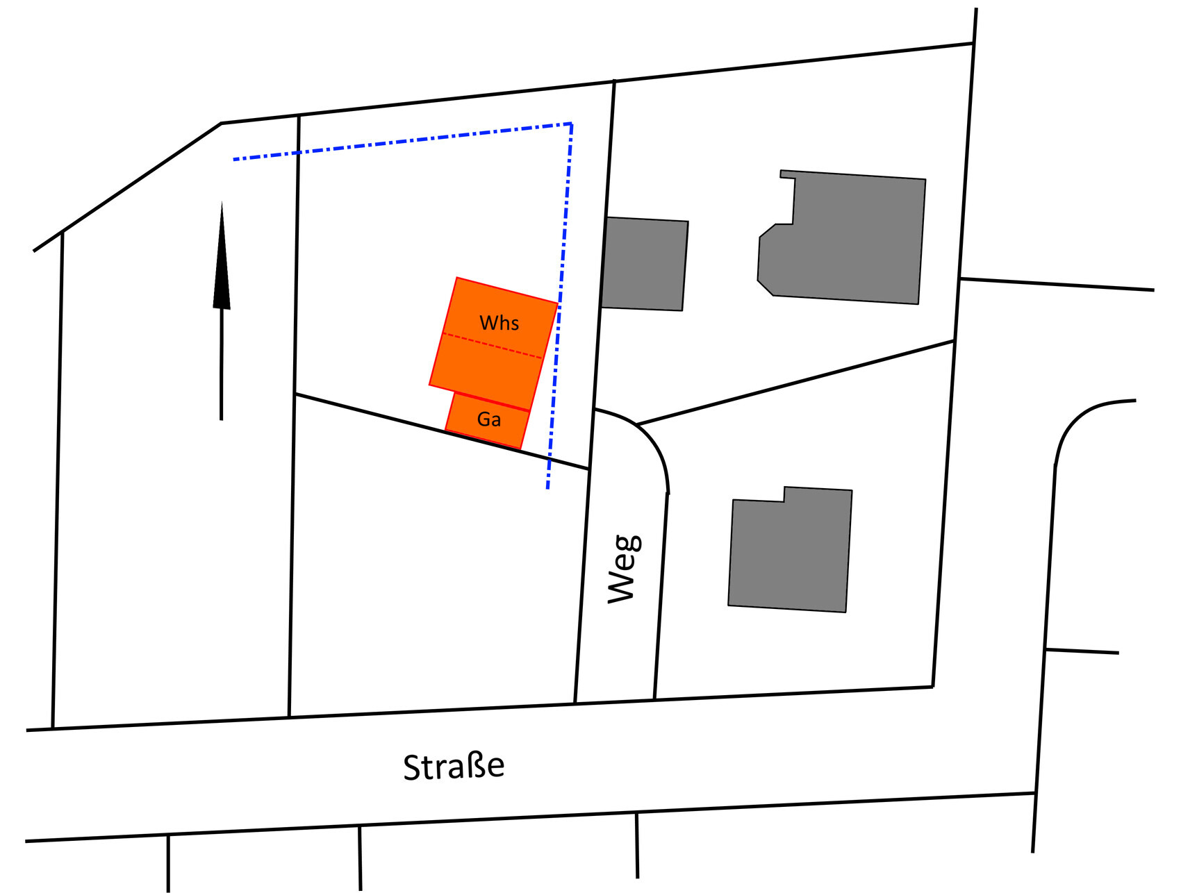

What is most important to you? The south-facing terrace, minimizing construction costs, distance to the forest, distance to neighbors? The choice is yours!
Here is my interpretation of your plans and statements:
Street at the bottom: orange residential house (Whs) and garage (Ga) next to grey buildings; blue border/line
Holzhäuschen schrieb:
Where would you build your house on this plot?
Since I don't place much value on a south-facing garden:
Site plan: street at the bottom, grey buildings on the right, orange areas 'Whs' and 'Ga' with blue border.

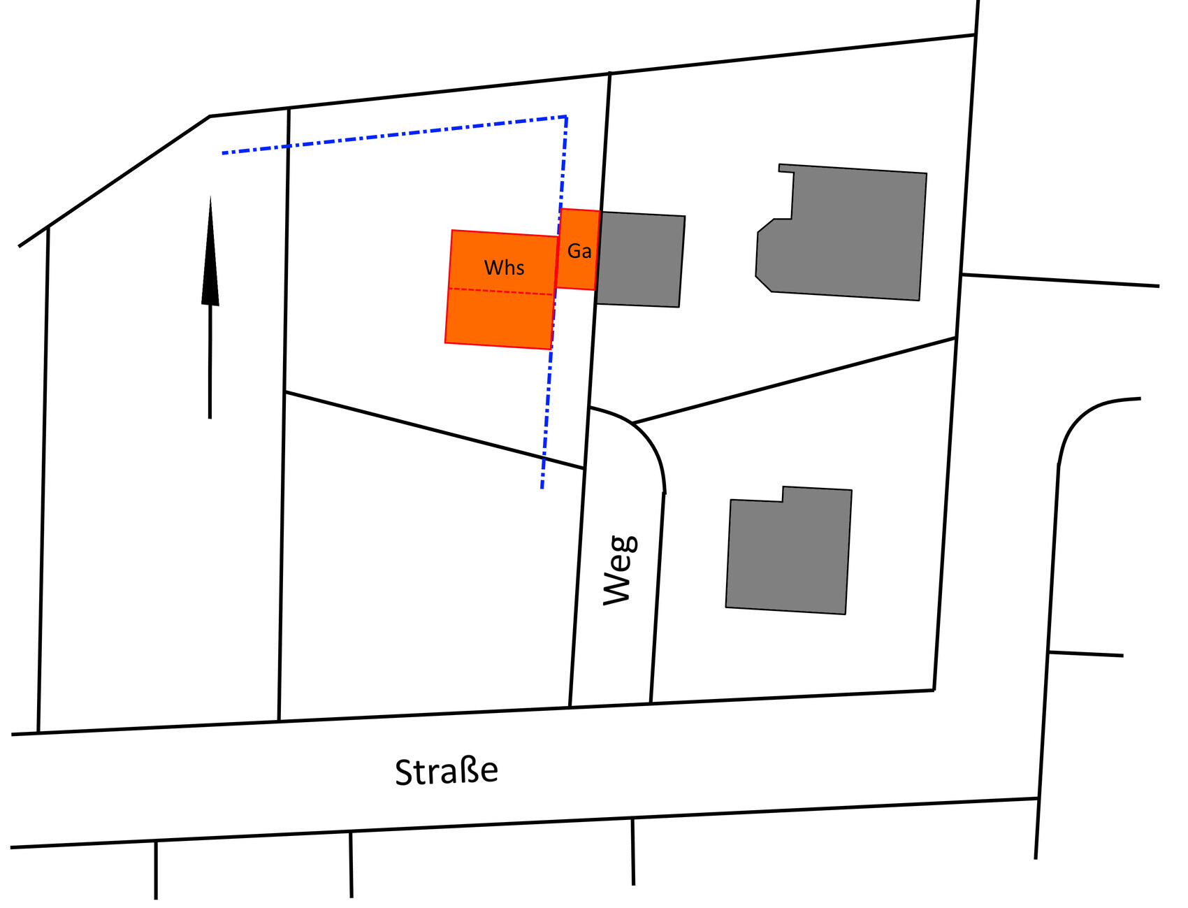

I would move the house completely to the north (without taking the pine forest and/or view into account) and place the carport to the east as a transition. That creates a nice southwest garden.
Connections usually include 15 meters (49 feet) of installation on the property. Additional meters are not very expensive, especially since you don’t have a parking area parcel. You can ask your local authority about the costs.
