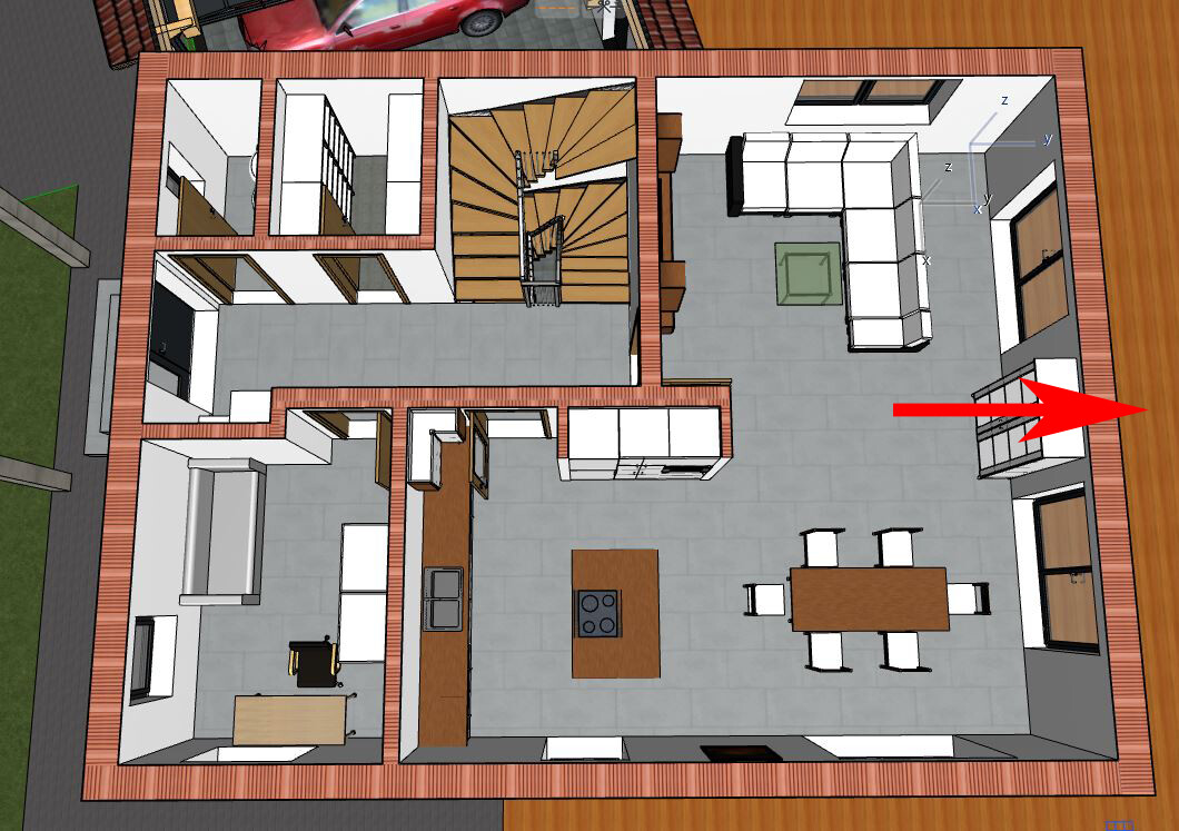

We are currently designing the floor plan for our single-family home ourselves on the recently purchased plot (parcel 13). Since the development plan and the building envelope already provide clear guidelines, we have tried to make the best use of these limits.
Besides the 6m (20 feet) wide double garage (at least for 2 cars), we can use up to 9m (30 feet) for the house width within the building envelope.
This means the house will have to be longer in the north-south direction.
Because the garage is located on the east side and attached directly to the house, we have tried to place rooms that need less natural light there.
The garden faces south and, as you can see in the plan, offers plenty of space which we would like to bring into both floors with many windows.
I would appreciate any suggestions you might have or, ideally, a confirmation that the plan looks quite good as it is.

User0815 schrieb:
Could you maybe name/describe them so that they can be googled? Yes, the first one is Variant_25-150_GR_DG
The second one is clou136_grundriss_og
What I would reconsider in your situation is the position of the patio doors. As you can see from your own furniture arrangement, it’s difficult to move past the furniture to step outside there. A better location would be in the middle of the room (arrow):
I would downgrade the rest to windows. In my opinion, doors behind the sofa are rarely used. Behind the dining table is not ideal either, but that could be reconsidered. Possibly corner windows or smaller ones, or other options... In any case, the arrangement should fit the furniture comfortably.
