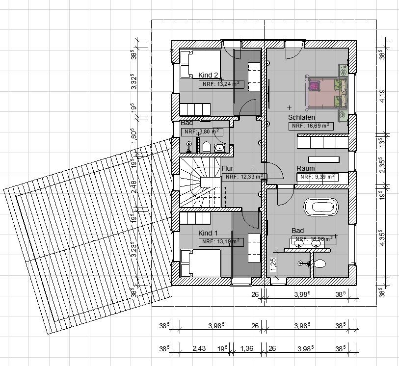

We are currently designing the floor plan for our single-family home ourselves on the recently purchased plot (parcel 13). Since the development plan and the building envelope already provide clear guidelines, we have tried to make the best use of these limits.
Besides the 6m (20 feet) wide double garage (at least for 2 cars), we can use up to 9m (30 feet) for the house width within the building envelope.
This means the house will have to be longer in the north-south direction.
Because the garage is located on the east side and attached directly to the house, we have tried to place rooms that need less natural light there.
The garden faces south and, as you can see in the plan, offers plenty of space which we would like to bring into both floors with many windows.
I would appreciate any suggestions you might have or, ideally, a confirmation that the plan looks quite good as it is.

Floor plan of an upper floor: two children's rooms, bedroom, bathroom, hallway, room and staircase.

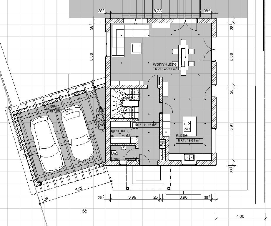

Floor plan of a house with living area, kitchen, office, storage, WC, stairs and garage.

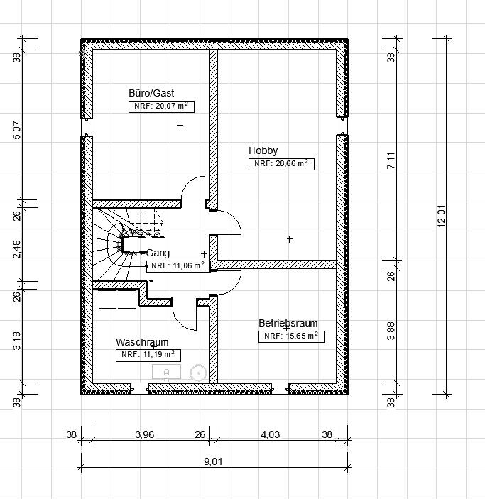

Floor plan of a basement with cellar, living area, laundry, utility room and storage room.

Personally, I would swap the storage room and the restroom in the entrance area. This way, in winter or bad weather, you don’t have to walk through the dirt brought inside to get to the toilet. An alternative solution: a shoe cabinet outside under the canopy...

Maybe an exception could be made to add a separate garage to each building plot. In any case, I believe the garage belongs next to the house, not the house next to the garage. No matter how precious the car is, it doesn’t deserve the prime cut of the roast.
Dopamin schrieb:
The walls have these dimensions because Archicad includes the plaster. So these are quite normal 36.5cm (14 inches) walls
Architects using CAD usually model the plans as rough constructions. Even after subtracting plaster, the room dimensions here remain unrealistic and deviate significantly from the standard dimensions.
In my opinion, the room is stretched too much vertically, which makes it feel smaller at the bottom.

Some time has passed, and we have made some adjustments to the plan.
Instead of having the office on the ground floor, we have extended the kitchen, significantly enlarging the living area.
The office will have to go into the basement (with a possible daylight shaft?).
We also revised the basement layout to fit the office in there.
I appreciate any suggestions, so feel free to be critical.
