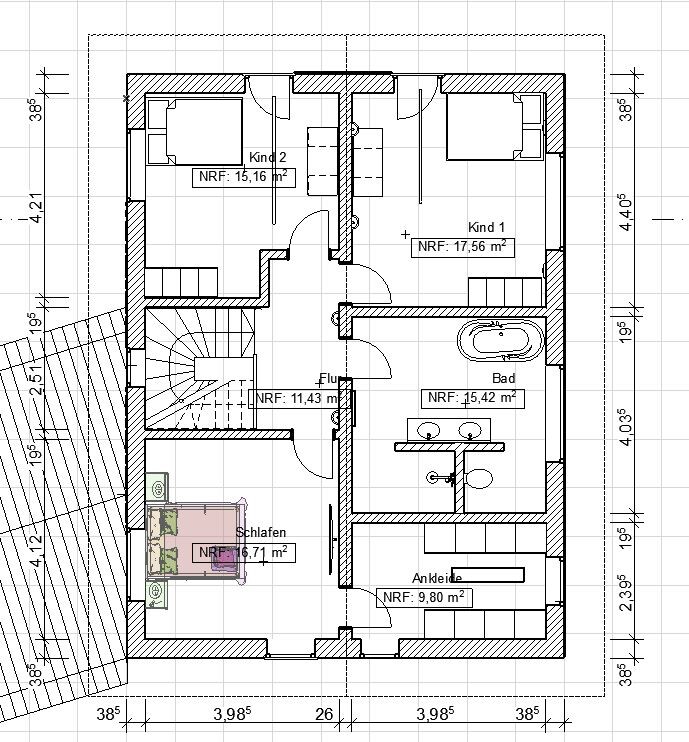

We are currently designing the floor plan for our single-family home ourselves on the recently purchased plot (parcel 13). Since the development plan and the building envelope already provide clear guidelines, we have tried to make the best use of these limits.
Besides the 6m (20 feet) wide double garage (at least for 2 cars), we can use up to 9m (30 feet) for the house width within the building envelope.
This means the house will have to be longer in the north-south direction.
Because the garage is located on the east side and attached directly to the house, we have tried to place rooms that need less natural light there.
The garden faces south and, as you can see in the plan, offers plenty of space which we would like to bring into both floors with many windows.
I would appreciate any suggestions you might have or, ideally, a confirmation that the plan looks quite good as it is.

For the size of a child's room, 15-16 sqm (160-170 sq ft) is good.
If you let children choose, most would prefer space to play, later space to hang out with friends, or a small bathroom for children.
Child bathrooms are a trend. They tend to gather dust more than being used.
I prefer it better without the children's bathroom. Only the bathroom access needs to be changed.
Swap the bedroom with Child 1
Bathroom with dressing room
Bathroom accessible from the hallway
No bedroom wall next to the children's room
The wardrobe is quite small
For 3-4 people
For 3-4 people

Here is the version with an office I would prefer this one.
Dopamin schrieb:
that the children's rooms are the same size, ... I personally think that’s pointless even for children of the same gender who are the same age—unless they are equally homebodies.
Many families have only one bathroom.
A few steps further, and on the ground floor there is an additional toilet.
At first, there are just two of you. Then, for years, your bathroom is used as the family bathroom. Later, the children's bathroom is used. In the phase when parents become more particular, it needs to be the main bathroom again, because only there...
Bedrooms of equal size prevent arguments, and younger children don’t like having the smaller room. The hand-me-down clothes and fewer gifts are already part of it.
